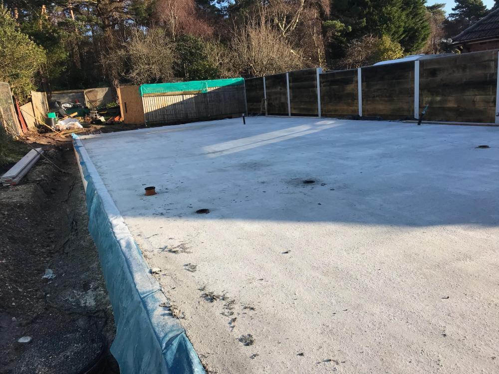

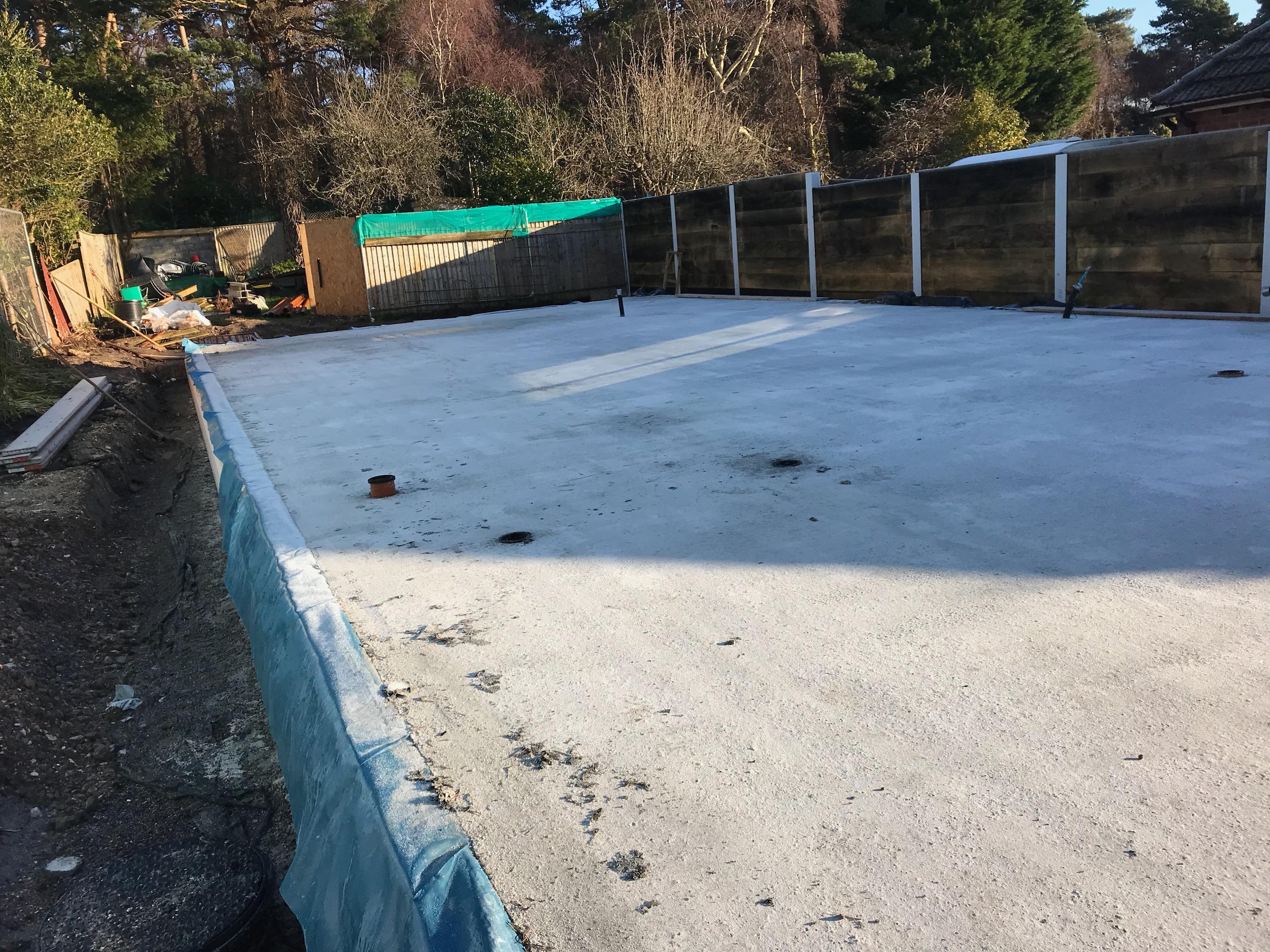

Adrian Walker Posted May 19, 2020 Share Posted May 19, 2020 2 hours ago, deuce22 said: How did you find using the self levelling concrete? Do you just pour it in and leave it? It worked very well and needs very little help to get in all the places it needed to be. It eliminates power floating which can be time consuming and noisey. I will see if I can find a better photo that shows the finish. This was an ISOQUICK insulated slab with UFH. Link to comment Share on other sites More sharing options...
