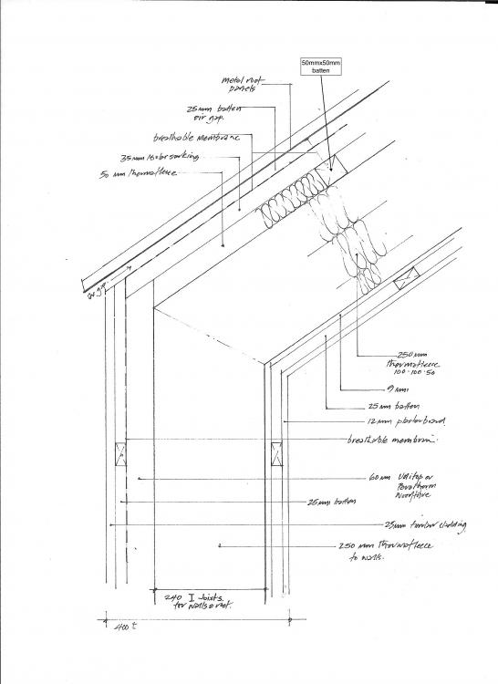

Nestor Posted December 4, 2016 Posted December 4, 2016 I have enclosed a drawing of our proposed wall and roof build up, using ibeams to create a portal frame at 600 centres. I would appreciate anyone's thoughts on this, Thanks
ProDave Posted December 4, 2016 Posted December 4, 2016 What provides the racking strength? Is that meant to be a layer of OSB on the inside of the frame for that purpose?
Nestor Posted December 4, 2016 Author Posted December 4, 2016 Hi Dave I hope the OSB will be sufficient, was going to have horizontal 50mmx50mm batten across the roof to then fix 25mm batten vertically for an air gap and to fix metal roof.
ProDave Posted December 4, 2016 Posted December 4, 2016 You will almost certainly need to have it all detailed by a structural engineer. that is similar in some ways to my build, and the SE specified that on some walls, I had to have two layers of OSB with staggered joints to give adequate racking strength.
ProDave Posted December 4, 2016 Posted December 4, 2016 2 minutes ago, Sensus said: There's no 'almost' about it! Apart from racking stiffness a portal frame works by having sufficient stiffness at the eaves and ridge connections; your sketch doesn't demonstrate how that will be achieved, but it will need calculations to prove it. True. I have seen this type of construction, and there are were gusset plates bolted at the eaves and ridge joints.

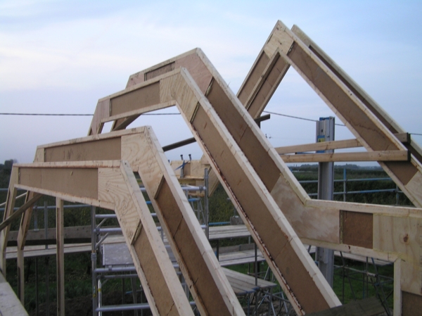

Gone West Posted December 5, 2016 Posted December 5, 2016 I have a portal timber I-beam frame. It has 15mm OSB3 external racking on the walls and roof. The SE even details the spacing of the ring shank nails fixing the racking. The spacing of the I-beams varies all over the frame depending on the loading.
ProDave Posted December 5, 2016 Posted December 5, 2016 ^^ and that shows the substantial gusset plates either side of each beam at the joints.

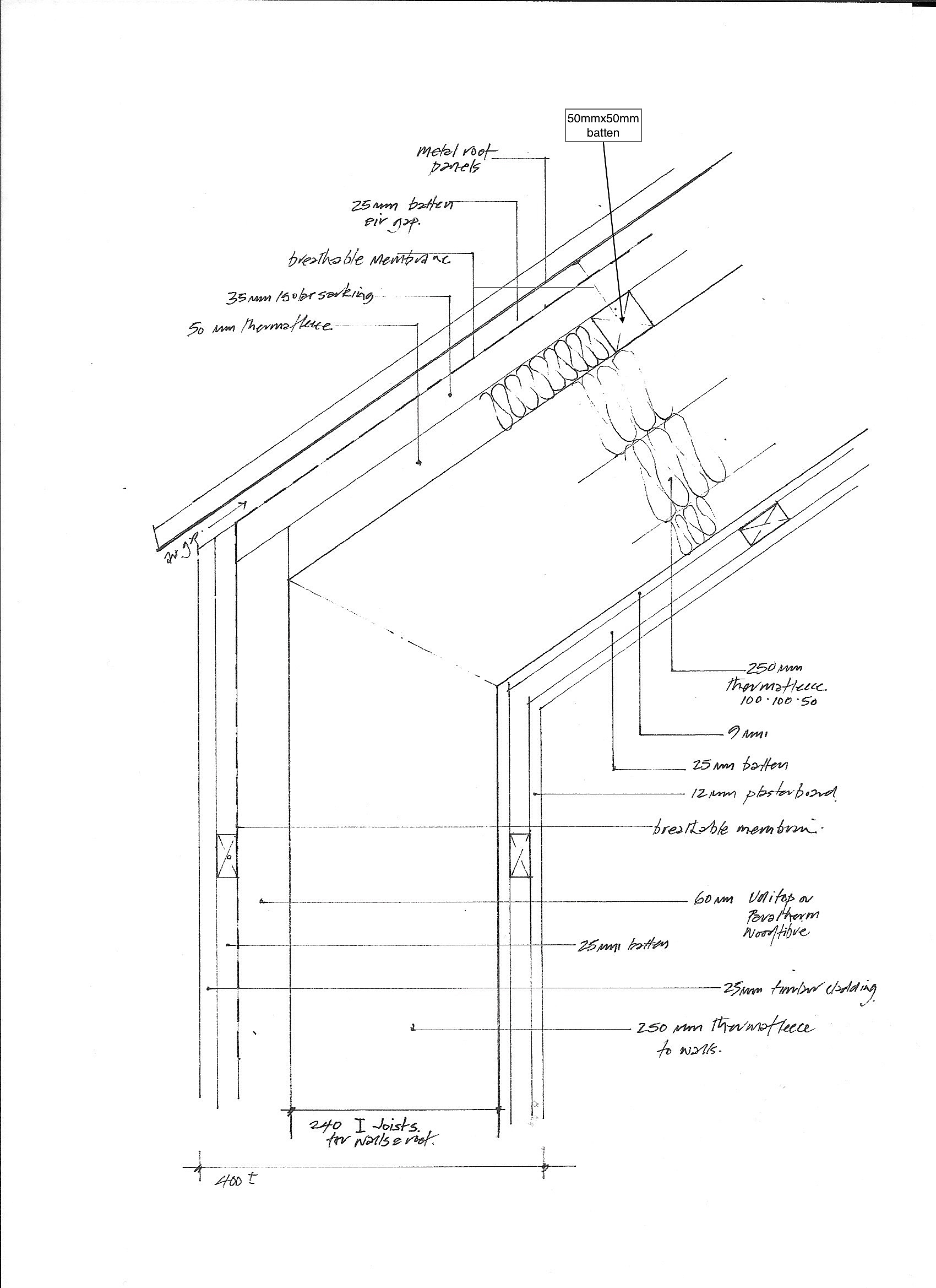

Nestor Posted December 5, 2016 Author Posted December 5, 2016 Hi Sensus Thanks for your comments and drawings. 37 minutes ago, Sensus said: 1) It would be better to have the vertical battens on the roof directly on top of the membrane/sarking for the same reason (any water that finds its way in can run harmlessly off to eaves, instead of sitting against the horizontal battens, on top of the sarking) and; Drawing is a little bit light, my Father does them by hand...you are right, we have a vertical batten on top of the membrane / sarking to fix the metal roof. We have switched the cladding to vertical and yes we now need counter battens for the continuous air gap.
Crofter Posted December 5, 2016 Posted December 5, 2016 Agree re the detailing at the junction between top of cladding and roof. Why not just fly the sarking over the top of the cladding, thus protecting the end grain, and providing a better lath for water runoff.
