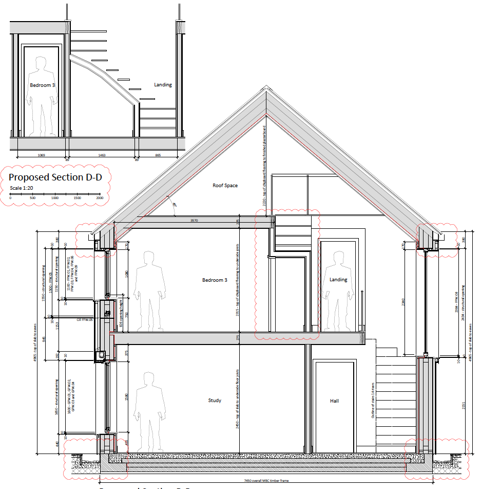

Russdl Posted May 9, 2020 Share Posted May 9, 2020 We have two large pocket doors in our new build, 2300 x 1100. More accurately we have big holes where the pocket doors will go. We're using Portman FD30 pocket door kits and sourcing the FD30 door blanks is proving to be difficult and eye waveringly expensive. Does anyone know a good source for oversize FD30 door blanks? Link to comment Share on other sites More sharing options...

Russell griffiths Posted May 9, 2020 Share Posted May 9, 2020 Any reason it needs to be fire rated. Link to comment Share on other sites More sharing options...
Russdl Posted May 9, 2020 Author Share Posted May 9, 2020 1 hour ago, Russell griffiths said: Any reason it needs to be fire rated. Its because our loft, whilst for storage only will have a fixed staircase and will be open to below on the staircase side. Ive asked BCO the question twice and he insists. Link to comment Share on other sites More sharing options...
Russell griffiths Posted May 9, 2020 Share Posted May 9, 2020 32 minutes ago, Russdl said: Its because our loft, whilst for storage only will have a fixed staircase and will be open to below on the staircase side. Ive asked BCO the question twice and he insists. So does that mean they have to have self closers. Link to comment Share on other sites More sharing options...
Russdl Posted May 9, 2020 Author Share Posted May 9, 2020 24 minutes ago, Russell griffiths said: So does that mean they have to have self closers You’d think so wouldn’t you, but that hasn’t been specified which makes the fact they are fire doors pretty pointless, especially as pocket doors they will spend most of their life open. Link to comment Share on other sites More sharing options...
Mr Punter Posted May 9, 2020 Share Posted May 9, 2020 1 hour ago, Russell griffiths said: So does that mean they have to have self closers. The regs got rid of those in 3 storey domestic years ago, as they were often the Perko slammers which were a H & S risk with small fingers and they were frequently removed or propped open, negating any fire resisting role. Link to comment Share on other sites More sharing options...
Russell griffiths Posted May 9, 2020 Share Posted May 9, 2020 So if you don’t need a self closer, what is the point of them being a fire door. ?♂️?♂️?♂️ Link to comment Share on other sites More sharing options...
Russdl Posted May 9, 2020 Author Share Posted May 9, 2020 2 hours ago, Russell griffiths said: So if you don’t need a self closer, what is the point of them being a fire door. ?♂️?♂️?♂️ I’m at a loss. As I said I’ve asked him to confirm twice if we need fire doors, he’s insistent that we do though I haven’t pointed out how pointless they will be. Do you think I should? IIRC the regulations didn’t really fit around what we have designed and built, if I push too much we may end up being forced to enclose the staircase to the loft and/or close the loft off. Probably doesn't make much sense, I’ll dig out a drawing to highlight what we have. Link to comment Share on other sites More sharing options...
joe90 Posted May 9, 2020 Share Posted May 9, 2020 (edited) What documentation do you need to prove to him that they are FD30 ? (or not ?. ) Edited May 9, 2020 by joe90 Link to comment Share on other sites More sharing options...
Russdl Posted May 9, 2020 Author Share Posted May 9, 2020 1 minute ago, joe90 said: What documentation do you need to prove to him that they are FD30 ? (or not ?. ) Absolutely no idea and I wouldn't be at all surprised that if they weren't he would have no idea and probably wouldn't question it. But if he did question it, and I hadn't fitted the fire rated doors into the pockets it would be less than straight forward to replace the door blank. With the Portman pocket door system, once they're in that's it, I'd have to open up the wall to change them. Here's section of the house where the stairs go up to the loft. The stairs will be fixed and the loft open to the floors below in the area of the stair well. I believe it's this aspect of the design that has caused building control to insist on fire rated doors, FD20 as it happens but I don't think you can get FD20 doors these days hence the original reference to FD30. Link to comment Share on other sites More sharing options...
Temp Posted May 9, 2020 Share Posted May 9, 2020 (edited) As I recall the regs changed some years ago so that domestic fire doors don't need to be self closing. No idea why. Your loft makes it a three storey house so fire doors are needed on all doors leading off the escape route from the loft. This is to stop fire in a ground or first floor room cutting off your escape from the loft. As least that's my understanding. Some people doing a loft conversion are surprised to find they need to change doors on the ground floor. If the ground floor is open plan to the stairs they may even have to wall off the stairs. Edited May 9, 2020 by Temp Link to comment Share on other sites More sharing options...
Russdl Posted May 9, 2020 Author Share Posted May 9, 2020 2 minutes ago, Temp said: This is to stop fire in a ground or first floor room cutting off your escape from the loft. As least that's my understanding. That's sort of my understanding as well but as there is no requirement for self closing it all seems a bit pointless. Ho-hum. Link to comment Share on other sites More sharing options...
Mike Posted May 10, 2020 Share Posted May 10, 2020 23 hours ago, Russell griffiths said: So if you don’t need a self closer, what is the point of them being a fire door. Domestic closers were dropped (except for integral garages) due to a report in 2003 identifying over 30,000 finger-trap injuries each year, plus evidence that many people disabled the closers or wedged the doors. Instead there was supposed to be awareness campaigns advising people to shut their internal doors at night (all doors, as most people didn't know if they had fire doors or not). Obviously if the shut door is a fire door, you have better protection. Leave it open and it is indeed pointless. Link to comment Share on other sites More sharing options...
