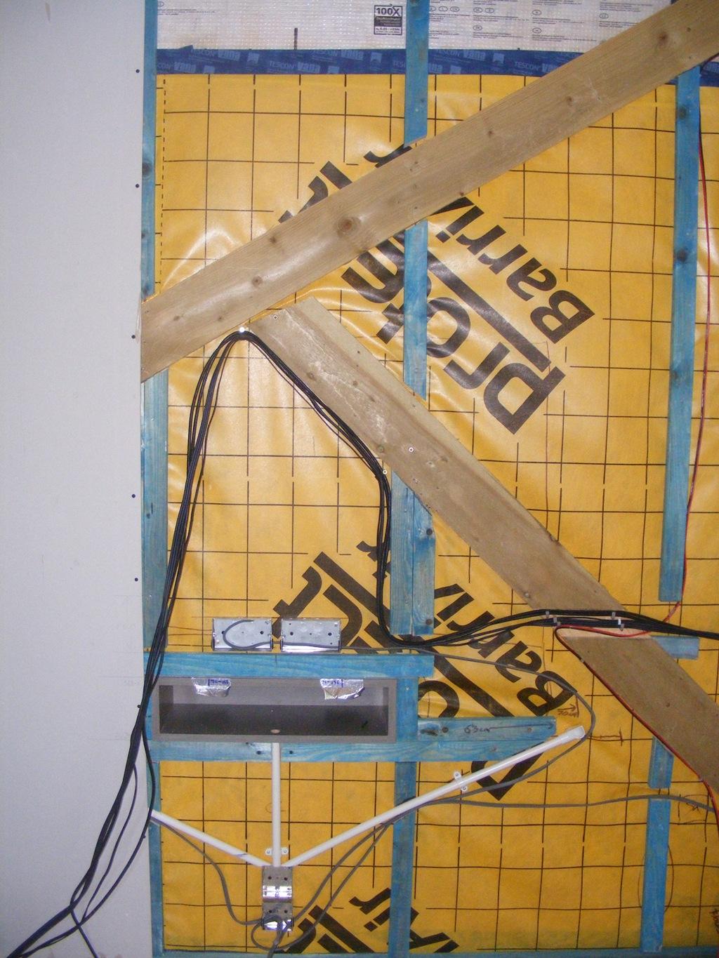

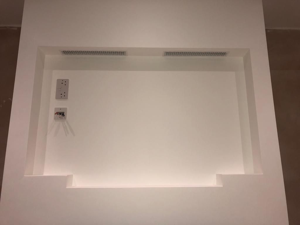

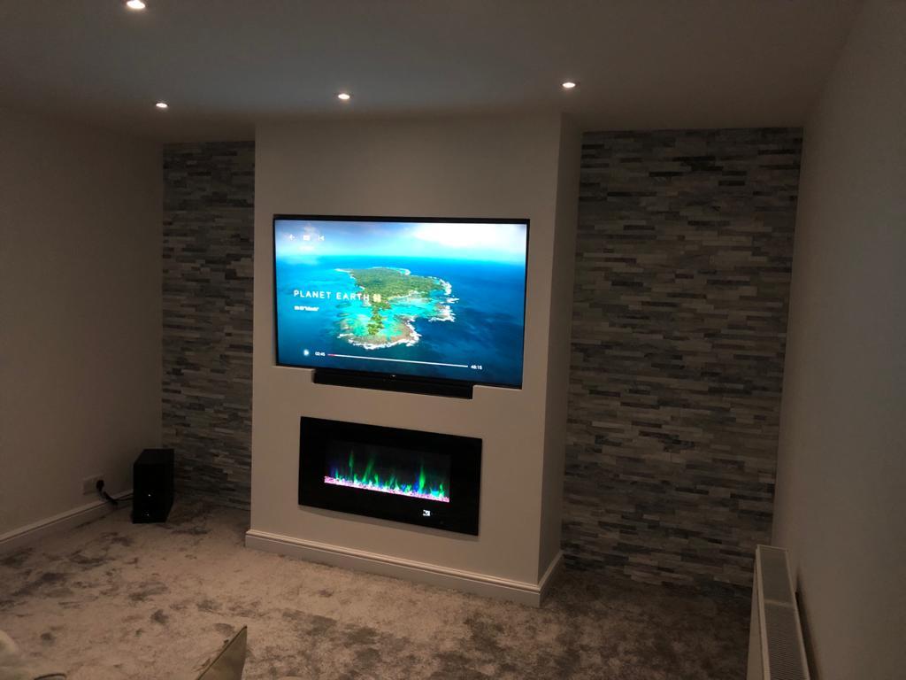

ProDave Posted May 6, 2020 Share Posted May 6, 2020 Build the whole house with a decent service void, mine is 25mm AV cables in before the plasterboard The finished result 1 Link to comment Share on other sites More sharing options...
gwebstech Posted May 6, 2020 Author Share Posted May 6, 2020 9 minutes ago, ProDave said: Build the whole house with a decent service void, mine is 25mm AV cables in before the plasterboard The finished result looks nice mate, thats what i was thinking. Just build a stud wall with a recess in it, and i just checked the plasterers price for dot and dab - this wall works out to £88 just to dot and dab! so its a lot cheaper to stud anyway and it will look better. Thanks Link to comment Share on other sites More sharing options...

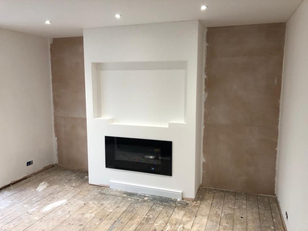

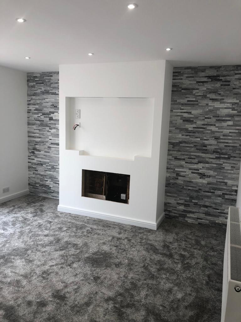

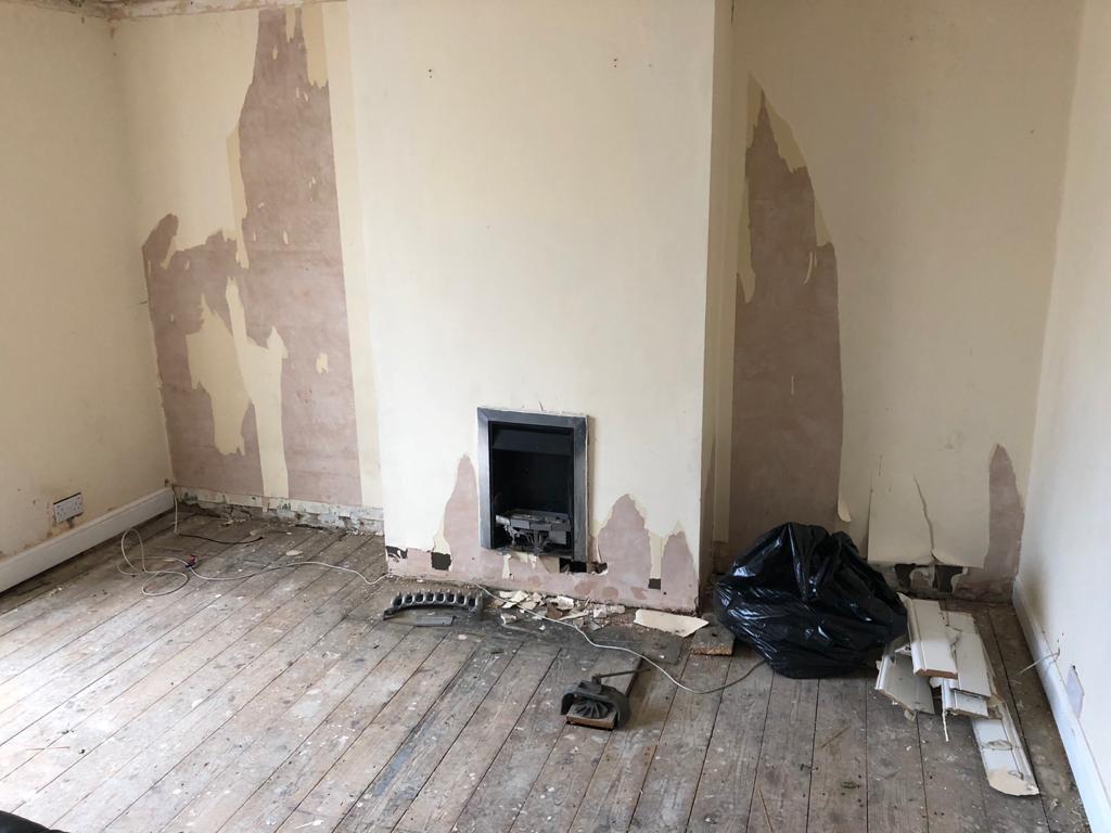

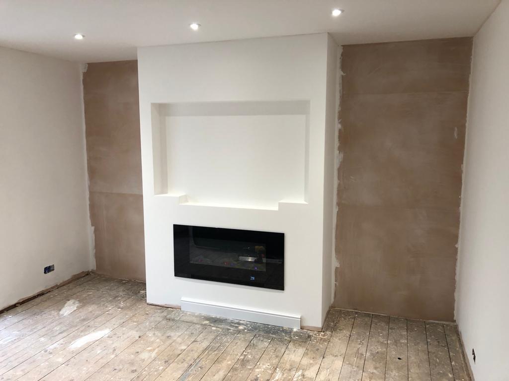

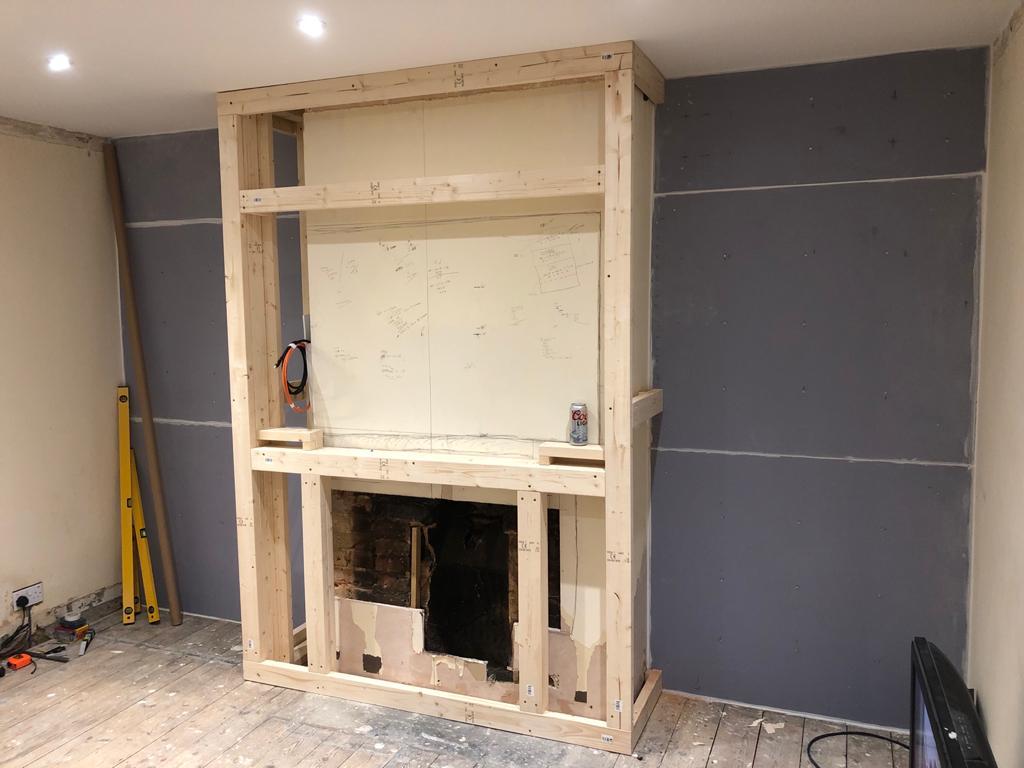

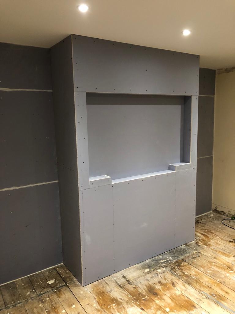

Onoff Posted May 6, 2020 Share Posted May 6, 2020 Mate at work did this: 2 Link to comment Share on other sites More sharing options...

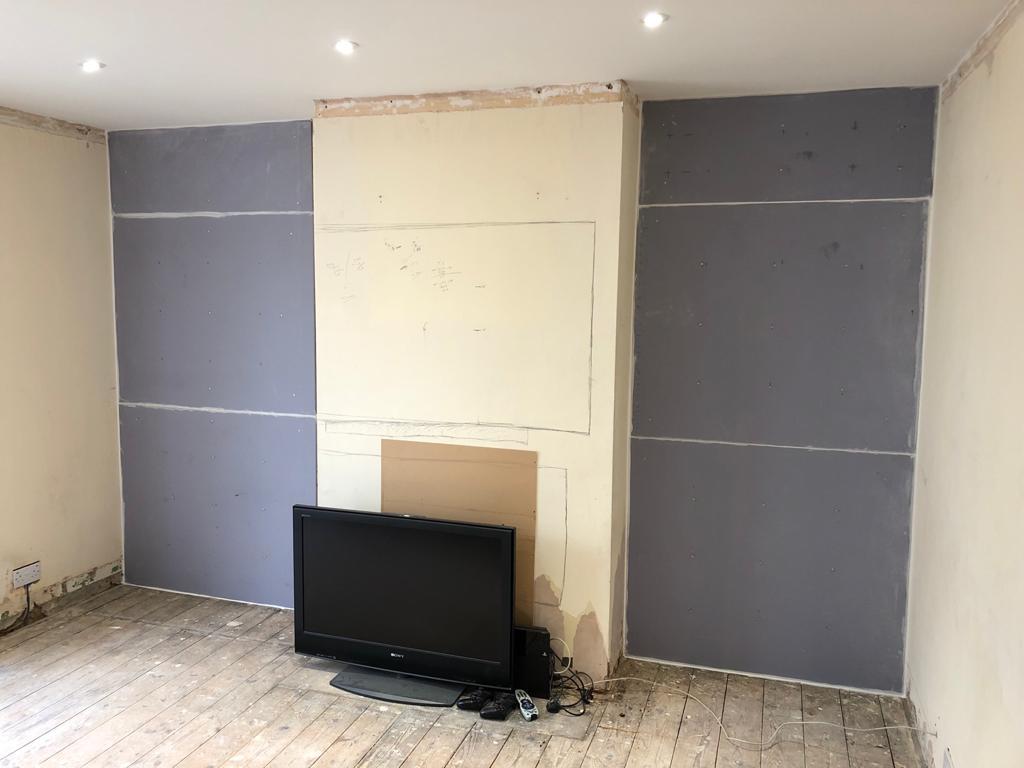

Onoff Posted May 7, 2020 Share Posted May 7, 2020 (edited) 3 hours ago, Vijay said: the fitted cabinet/wall looks lovely, but what happens when you changed the TV Multitool? ? I can't imagine he wont be able to get a similar sized TV a few years down the line that will fit. 65" Sony in the picture. Edited May 7, 2020 by Onoff Link to comment Share on other sites More sharing options...
