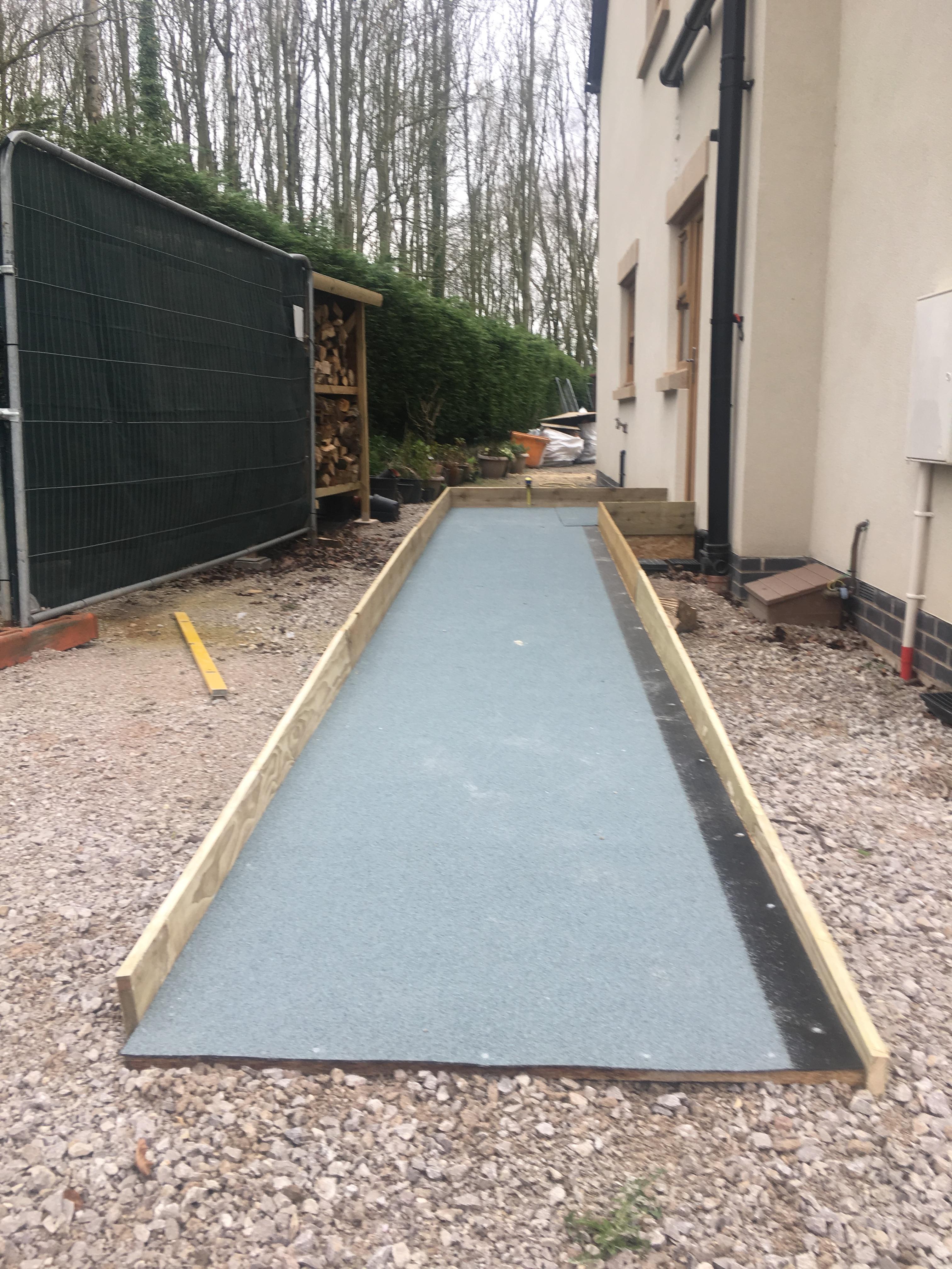

nod Posted May 6, 2020 Share Posted May 6, 2020 13 minutes ago, nod said: I was right on top of our for the first 3 metres that came from the Bc was fine as we were work to an existing outlet from the treatment plant Pictured is my temporary disabled ramp all ready for BC inspection If you look carefully at the top right You can see the exposed drain Link to comment Share on other sites More sharing options...

Jeremy Harris Posted May 6, 2020 Share Posted May 6, 2020 4 minutes ago, Dave Jones said: whats with the ramp ? Building regs compliance. All new builds normally need wheelchair access from the point where someone gets out of a car in to the entrance floor, at least as far as the entrance floor WC (in England and Wales). There are slightly different access requirements in Scotland, and, I believe, NI. My solution was to run the ramp around the side of the house to the back door, and have that as the wheelchair accessible entrance, as I didn't like the look of having a ramp to the front door. Link to comment Share on other sites More sharing options...
Dave Jones Posted May 6, 2020 Share Posted May 6, 2020 that was a really anal BCO you had to make you do that. There is no rule stating a step cannot be used in Part M of the regs. Link to comment Share on other sites More sharing options...
nod Posted May 6, 2020 Share Posted May 6, 2020 10 minutes ago, Dave Jones said: whats with the ramp ? Just now, Dave Jones said: that was a really anal BCO you had to make you do that. There is no rule stating a step cannot be used in Part M of the regs. You have to have wheel chair access I wasn’t ready to pave So I followed the gradients to the letter and sizes It took me an afternoon to make Passed with flying colours for our local Authority final inspection Shame to smash it up the following day Link to comment Share on other sites More sharing options...
Jeremy Harris Posted May 6, 2020 Share Posted May 6, 2020 10 minutes ago, Dave Jones said: that was a really anal BCO you had to make you do that. There is no rule stating a step cannot be used in Part M of the regs. Sod all to do with the BCO in my case. Having a wheelchair user around means using common sense to provide access, funnily enough. Maybe you would rather wheelchair users were banned from houses? This is what Part M states very clearly, and very sensibly: Quote PERFORMANCE In the Secretary of State’s view the requirements of Part M will be met by making reasonable provision to ensure that buildings are accessible and usable. People, regardless of disability, age or gender, should be able to: a. gain access to buildings and to gain access within buildings and use their facilities, both as visitors and as people who live or work in them; b. use sanitary conveniences in the principal storey of a new dwelling. The provisions are expected to enable occupants with disabilities to cope better with reducing mobility and to ‘stay put’ longer in their own homes. The provisions are not necessarily expected to facilitate fully independent living for all people with disabilities. Quote ii. Dwellings a. so that people, including disabled people, can reach the principal, or suitable alternative, entrance to the dwelling from the point of access; b. so that people, including disabled people, can gain access into and within the principal storey of the dwelling c. for WC provision at no higher storey than the principal storey. Link to comment Share on other sites More sharing options...

nod Posted May 6, 2020 Share Posted May 6, 2020 30 minutes ago, Hobbiniho said: wow im suprised that you passed with that, up here that wouldnt pass as it is so obviously temporary,im also suprised with the lack of handrail aswell, i have built so many access ramps that the homeowner said that they would rip out as soon as they were moved in but still had to build them to look like they are meant to be permanent, there is also some people who build concrete ones with concrete that is only a couple of inches thick so they are easier to remove after completion No I did my research No hand rail needed as it is wheel chair access Doesn’t need to be permanent for sign off Or any particular material 1200 x 1200 level in front of door and I think the slope was 1 -7 Must have numbers around the edge 150 high None slip service Hence the mineral felt The two inspectors that came where fine One of the inspectors who hadn’t been before did say he wouldn’t be happy if it was moveable Then preceded to try to lift it off But they did add a foot note to the sign off Landscaping incomplete Temporary Disabled access in place Link to comment Share on other sites More sharing options...
