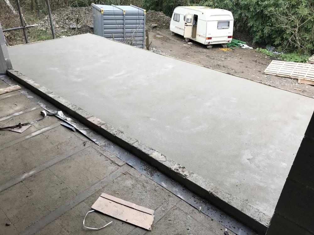

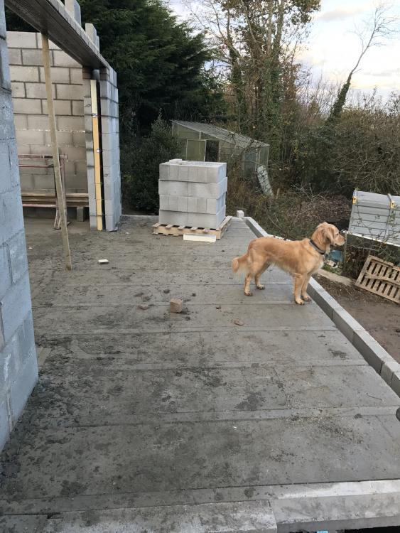

Grosey Posted December 3, 2016 Author Posted December 3, 2016 Hi Mr P, thanks for your comments Cavity closers will be added next week, and the cavity around the front of the balcony will also be closed. 100mm kerb (block laid flat) will be installed in the doorway and sliding doors installed on this. Not there yet as it would be a serious trip hazard! Looking at creating a fall towards the front of the balcony and then a gutter. Either with concrete screed over the whole balcony then Asphalt. Or some fibreglass companies are on about installing firrings then t&g chipboard to create the fall.

Grosey Posted December 3, 2016 Author Posted December 3, 2016 The balcony side I plan to insulate from underneath, internally there will be 75mm celotex then 75mm screed. If I wanted to insulate the balcony and have a warm roof I think I could only fit 25mm celotex due to the type of doors I'm having. Underneath is garage/workshop officially but at some point I plan to convert this to habitable rooms.

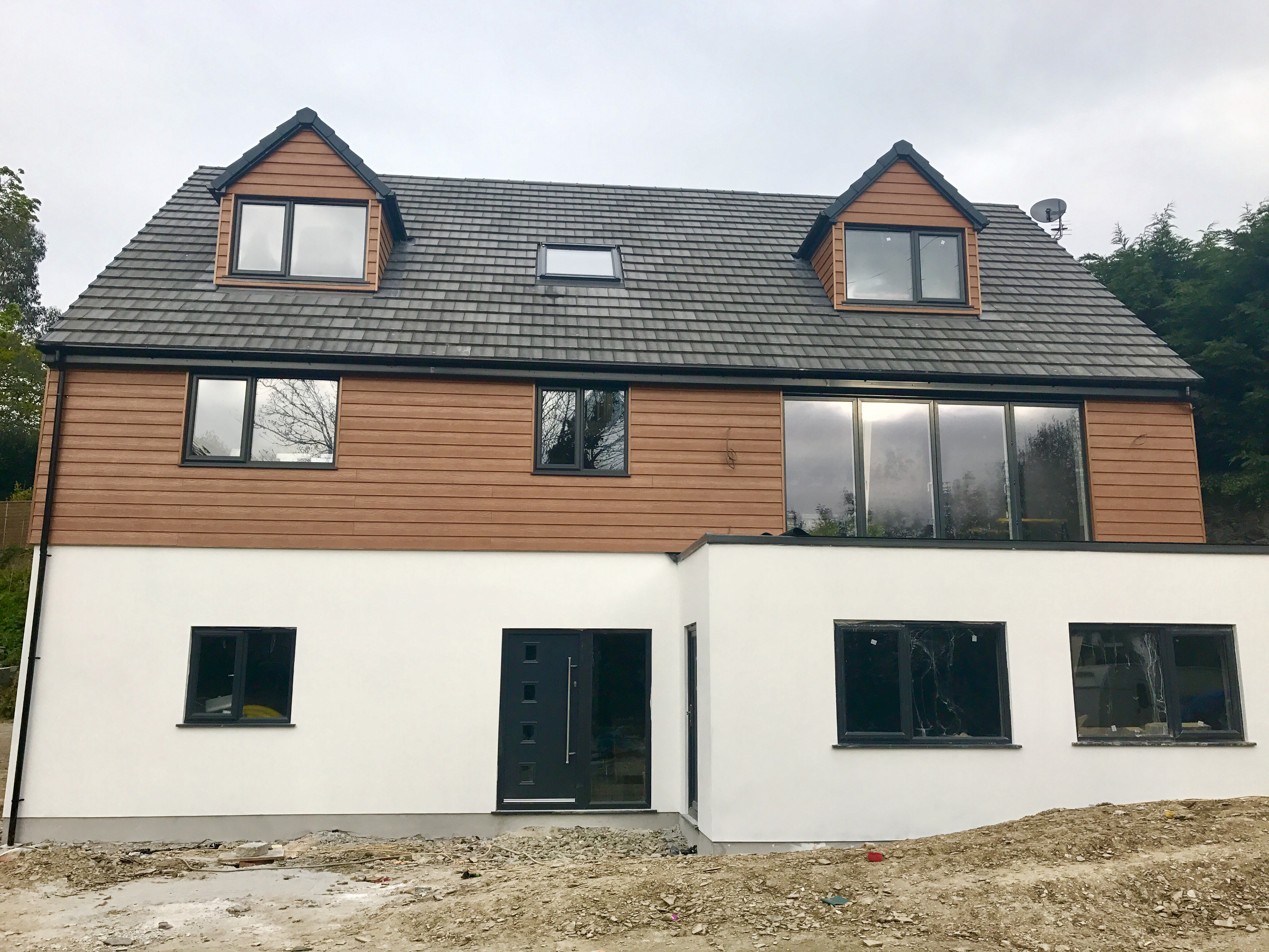

Grosey Posted August 14, 2017 Author Posted August 14, 2017 It has a fall towards the front, with a drip bead that will go in to a gutter, the gutter is the piece that is causing my issues with face mounted posts - surely this is a common problem though?
jamiehamy Posted August 14, 2017 Posted August 14, 2017 I would say so - yes. What type of ballustrade are you going for - frameless glass or something else? Looking at it now (and probably agreeing that wall mounted would be clumsy here with the gutter), I would stick with my above - take out a section of the grp and secure your timber pad into the BnB - which not only created something to bolt the upstand/base into but provides an upstand to minimise standing water at a complex join. You could leave 50/100mm beween that and the edge where the drip bead is, and create holes for the water to pass through. Does that make sense? That's just my thinking on the matter, others hopefully will have different ideas.
Grosey Posted August 14, 2017 Author Posted August 14, 2017 I'd love a frameless system, however I cannot see how this will work with a base channel all along the front, as it would essentially prevent the water from running off. Could I mount a base channel up off the GRP on several raised pads at suitable intervals - thinking this could look a bit naff though?

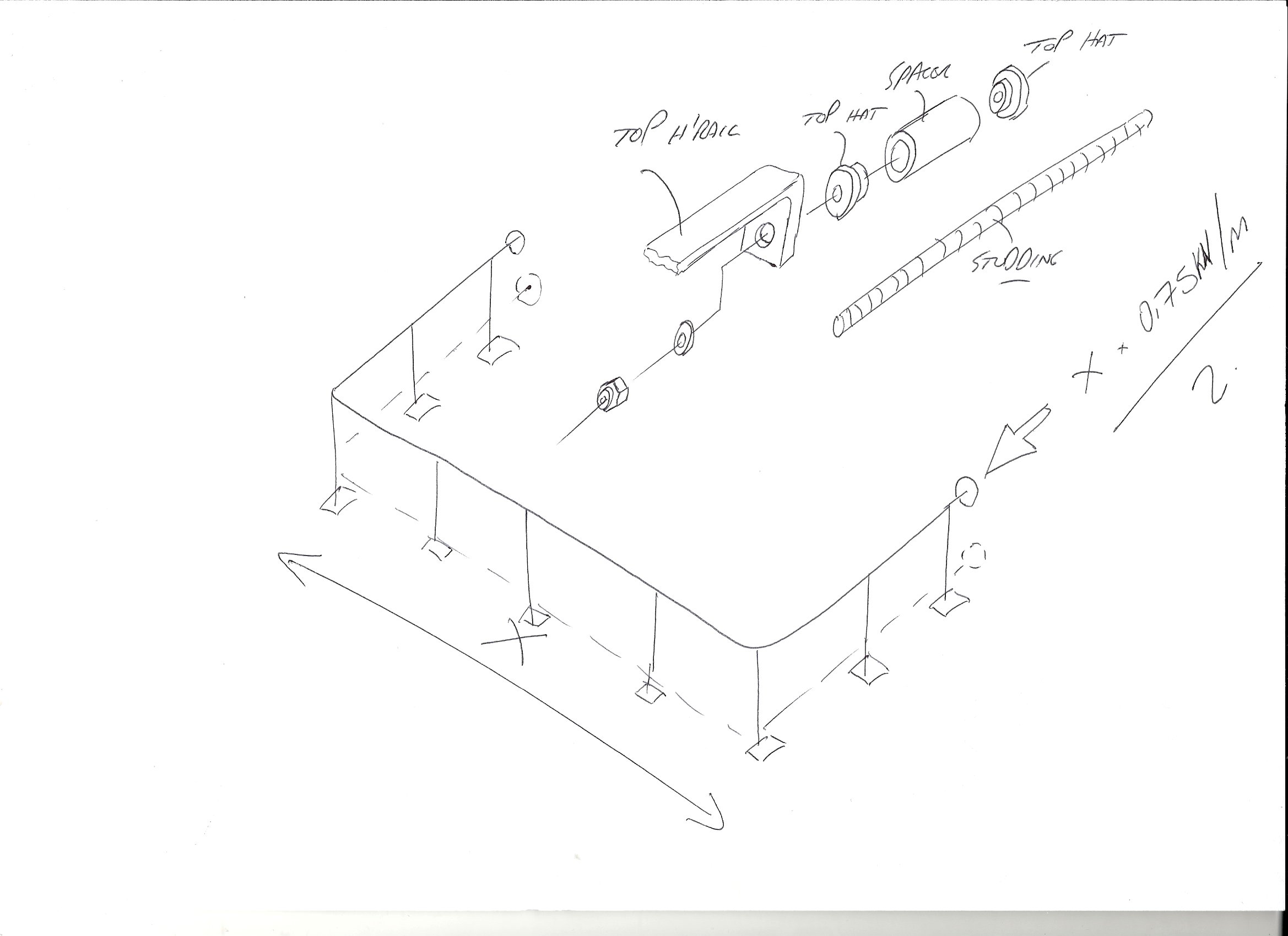

Onoff Posted August 14, 2017 Posted August 14, 2017 Is there any way you could affix to the "wood" clad wall at 1st floor level? Then you could have the standard feet on rubber pads. Years back I made a galv frame up for a small roof with no handrail and "weighted it" down with council slabs. Got the sketch somewhere still. All rule of thumb mind!
Grosey Posted August 14, 2017 Author Posted August 14, 2017 1 minute ago, Onoff said: Is there any way you could affix to the "wood" clad wall at 1st floor level? Then you could have the standard feet on rubber pads. Years back I made a galv frame up for a small roof with no handrail and "weighted it" down with council slabs. Got the sketch somewhere still. All rule of thumb mind! Yes, I could drill through the Cedral cladding, to the block work behind, then pack out a long thunderbolt with some sort of tube washer to ensure I was only fixing against the block and not the cladding itself. Would fixing to the wall at 2 ends of a U shape be sufficient? Can the feet just sit on the GRP then? What about people leaning on the handrail?

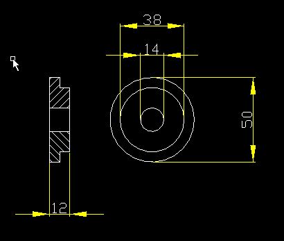

Onoff Posted August 14, 2017 Posted August 14, 2017 Did something similar years back but it was down into a roof slab. Consisted of a resin anchored stud into the slab, 50mm OD st/st washer as below: Then a short length of thick wall st/st tubing and another washer as above. This was to avoid compressing the roof fixings. Got the full detail somewhere.
Onoff Posted August 14, 2017 Posted August 14, 2017 Got any pictures of the balcony / parapet detail and how wide is the frontage? Looks 7-8m wide?

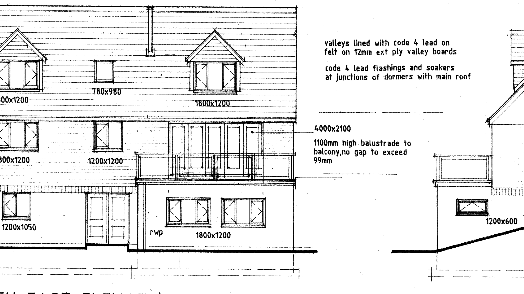

Grosey Posted August 14, 2017 Author Posted August 14, 2017 6 minutes ago, jamiehamy said: I don't think it would work anyway - you don't want to be clamping down a base channel on top of the GRP - and sealing the full length of a baserail to GRP - destined to fail. I'm assuming (like us) your architect and engineer failed to come up with a decent design for this? J Yep, the is the only mention of a balustrade in a the plans - very detailed Ive looked in to it a little more and apparently they are never installed flush to the ground anyway, you have a "drain plate" underneath each bolt which raises the whole base rail between 2-5mm to allow water to flow underneath. So this could work and allow the water to flow out to the gutter?
Onoff Posted August 14, 2017 Posted August 14, 2017 I've always struggled with structural calcs tbh but is it something on the lines like this? Do you add on the loads for the infill panels? Gut feel that a top and bottom member would make everything stiffer, so 4 fixing points back thru the cladding.

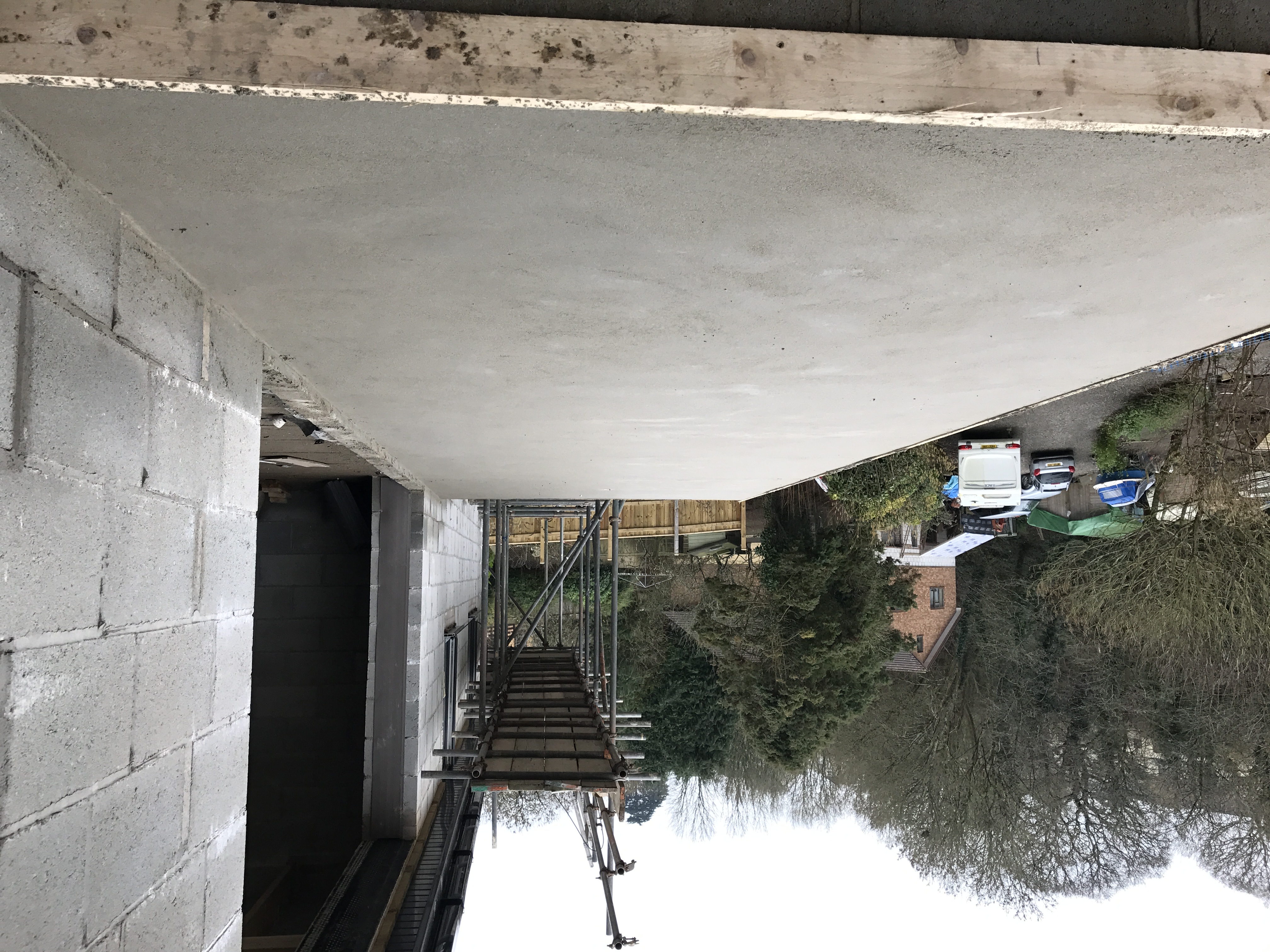

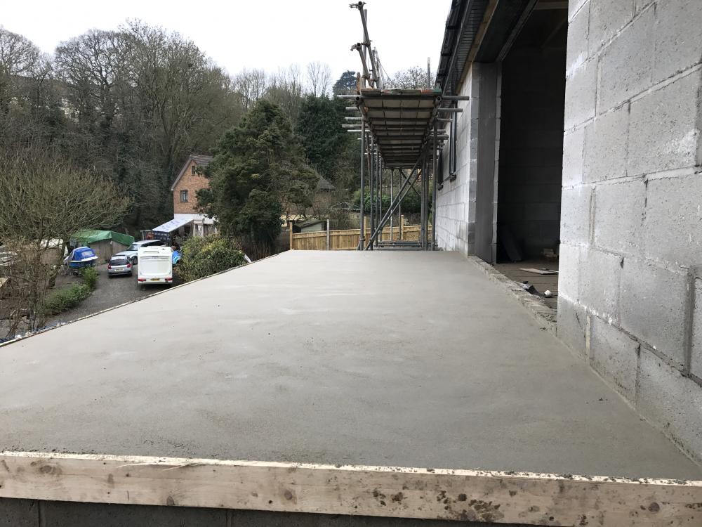

Grosey Posted August 14, 2017 Author Posted August 14, 2017 26 minutes ago, Onoff said: Got any pictures of the balcony / parapet detail and how wide is the frontage? Looks 7-8m wide? I don't have any photos since the GRP was done, but essentially it has small risers along the short edges and this screed created the fall to front. Dimensions are approx 2m x 7m x 2m
Onoff Posted August 14, 2017 Posted August 14, 2017 (edited) So is there a structural slab under there? Those wall blocks don't look too thick for an expanding anchor. How thick are they? Through stud with a big plate washer on the back? Cold bridging? Don't get me wrong I'd "come up with something" if it were mine but SE job I reckon. Edited August 14, 2017 by Onoff
