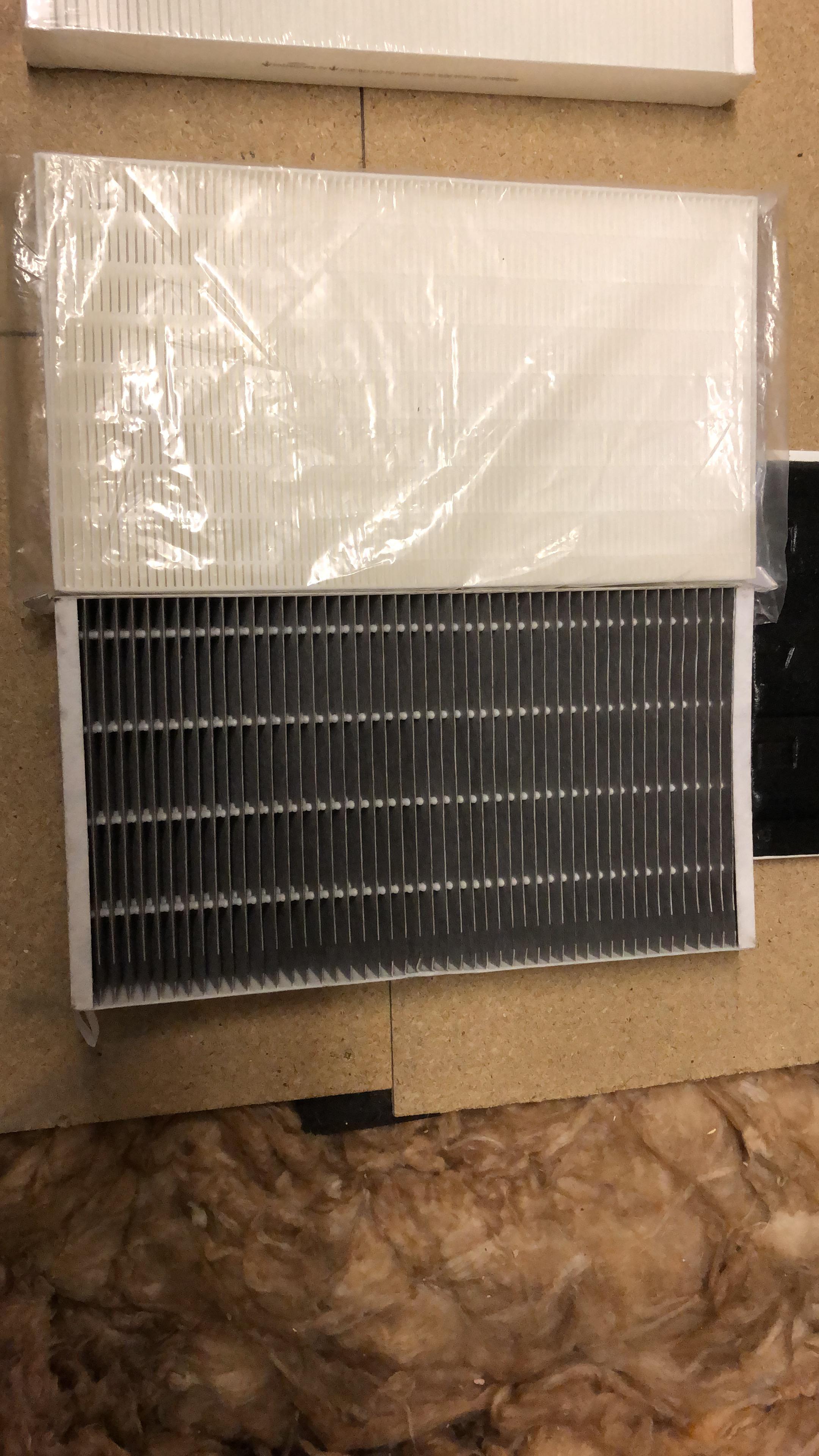

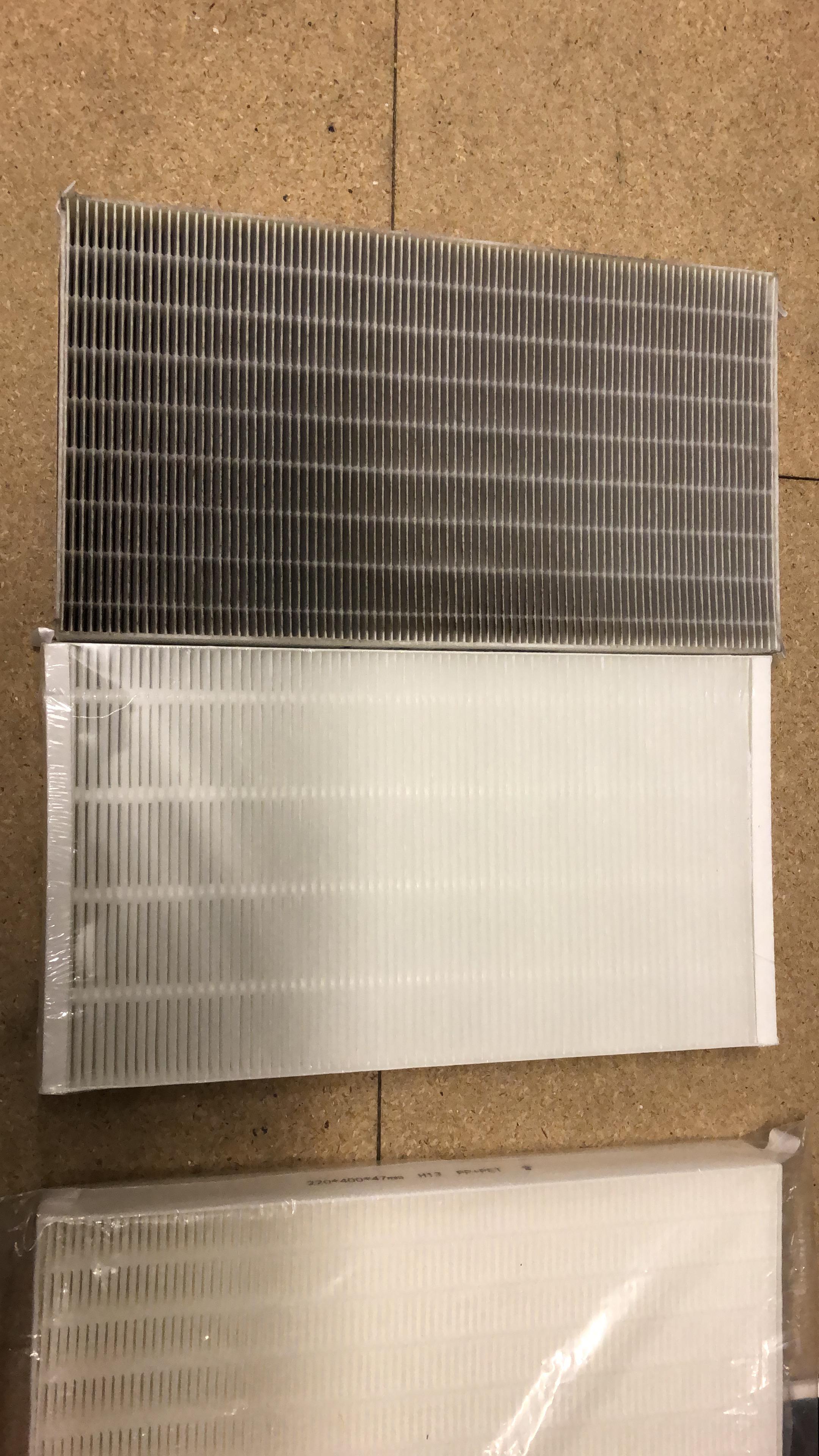

MikeGrahamT21 Posted February 23, 2021 Share Posted February 23, 2021 To add my further experience, I started getting smoke ingress, so invested in a Blauberg CleanBox which has reduced it by a good 90%, still can be a faint smell if the smell is full on pungent outside, it has G4 > F8 > Carbon Link to comment Share on other sites More sharing options...
Savage87 Posted February 23, 2021 Author Share Posted February 23, 2021 Wow! Must a cost you half the mvhr install, all because of neighbours that live in the past.. Does the cleanbox have an additional fan? Link to comment Share on other sites More sharing options...
MikeGrahamT21 Posted February 23, 2021 Share Posted February 23, 2021 (edited) 44 minutes ago, Savage87 said: Wow! Must a cost you half the mvhr install, all because of neighbours that live in the past.. Does the cleanbox have an additional fan? it did cost a small fortune, around £300, and annoyingly I’d forgot about the Zhender modular solution which comes in at same price initially but filter changes are cheaper, so will have to take a hit at some point, the curse of having a bad memory! Lol so many houses round here have stoves, or coal can’t blame any one person really. only having a small bungalow means my flow rates are small anyway, so I wouldn’t say the change of filter has made much impact, though I have yet to test and balance the system, so don’t know true airflow rates. I raised the supply by 2% just in case which also helped to recover more heat from the exhaust, but overall seems same as before filter box, still get the fresh air smell ? at some point I’ll add everything to my blog, but haven’t been too well lately so have just done stuff and not taken any photos Edited February 23, 2021 by MikeGrahamT21 Link to comment Share on other sites More sharing options...

MikeGrahamT21 Posted January 30, 2023 Share Posted January 30, 2023 23 minutes ago, Ewan said: Sorry for the necro of this old post, but I'm looking for a NOx filtration system that is not in the £1000s.. (Zehnder, Nuaire etc). What was this modular Zehnder system if you can recall? I've only seen their large unit: https://www.zehnder.co.uk/products-and-systems/comfortable-indoor-ventilation/zehnder-filter-housing-nox For which I have been quoted £3850 +VAT . Currently considering the Blauberg CleanBox or the Nuaire supply valves (but they add 8Pa of pressure each), but a modular zehnder in the similar price range would be worth considering if you know the details? How has your Blauberg cleanbox worked out, not too much extra noise in the end? The Zehnder one was this: https://www.paulheatrecovery.co.uk/product-category/mvhr-ducting/comfowell-modular-air-manifold-silencer-system/ CleanBox has been fantastic, just swapped the filters over (not the carbon filter as thats still filtering smells fine), and now running a G4 and a H13 HEPA filter. Old vs New on both the ones i swapped: 1 Link to comment Share on other sites More sharing options...

Ewan Posted January 30, 2023 Share Posted January 30, 2023 Thanks Mike, looks like it will be just the ticket. The 200mm version has the best static pressure performance, looks like it adds about 30Pa at our normal fan speed.. which basically doubles our system Pa but should be within tolerance. The Zehnder unit was about 11Pa, but £4k is just ridiculous. Yes Kelvin, the message re log burner harm does seem to be slow to filter through to people who aren’t actively looking.. though reasonably regular articles in newspapers these days, hopefully awareness will grow. Link to comment Share on other sites More sharing options...
MikeGrahamT21 Posted January 30, 2023 Share Posted January 30, 2023 5 hours ago, Ewan said: Thanks Mike, looks like it will be just the ticket. The 200mm version has the best static pressure performance, looks like it adds about 30Pa at our normal fan speed.. which basically doubles our system Pa but should be within tolerance. The Zehnder unit was about 11Pa, but £4k is just ridiculous. Yes Kelvin, the message re log burner harm does seem to be slow to filter through to people who aren’t actively looking.. though reasonably regular articles in newspapers these days, hopefully awareness will grow. I wonder how much the new ecodesign stoves give out, meant to be much improved Link to comment Share on other sites More sharing options...
