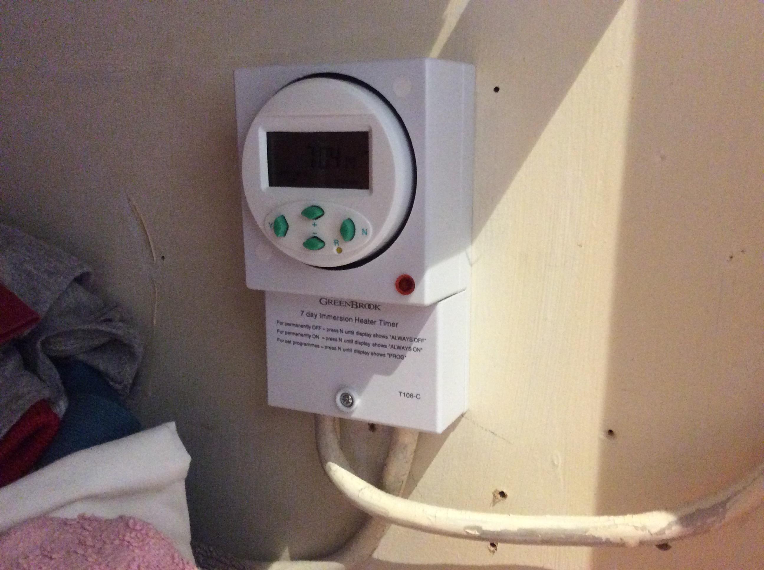

Russell griffiths Posted April 16, 2020 Posted April 16, 2020 So I came home last night to the wife moaning we had no hot water and the timer had stopped working now this emersion timer has been in use for about 5 years, do things like this only last this long nowadays or I’d there something killing them ?? our timer on the heated towel rail is playing up as well and that’s about 3 years old. I don’t remember it being cheap. Any thoughts.

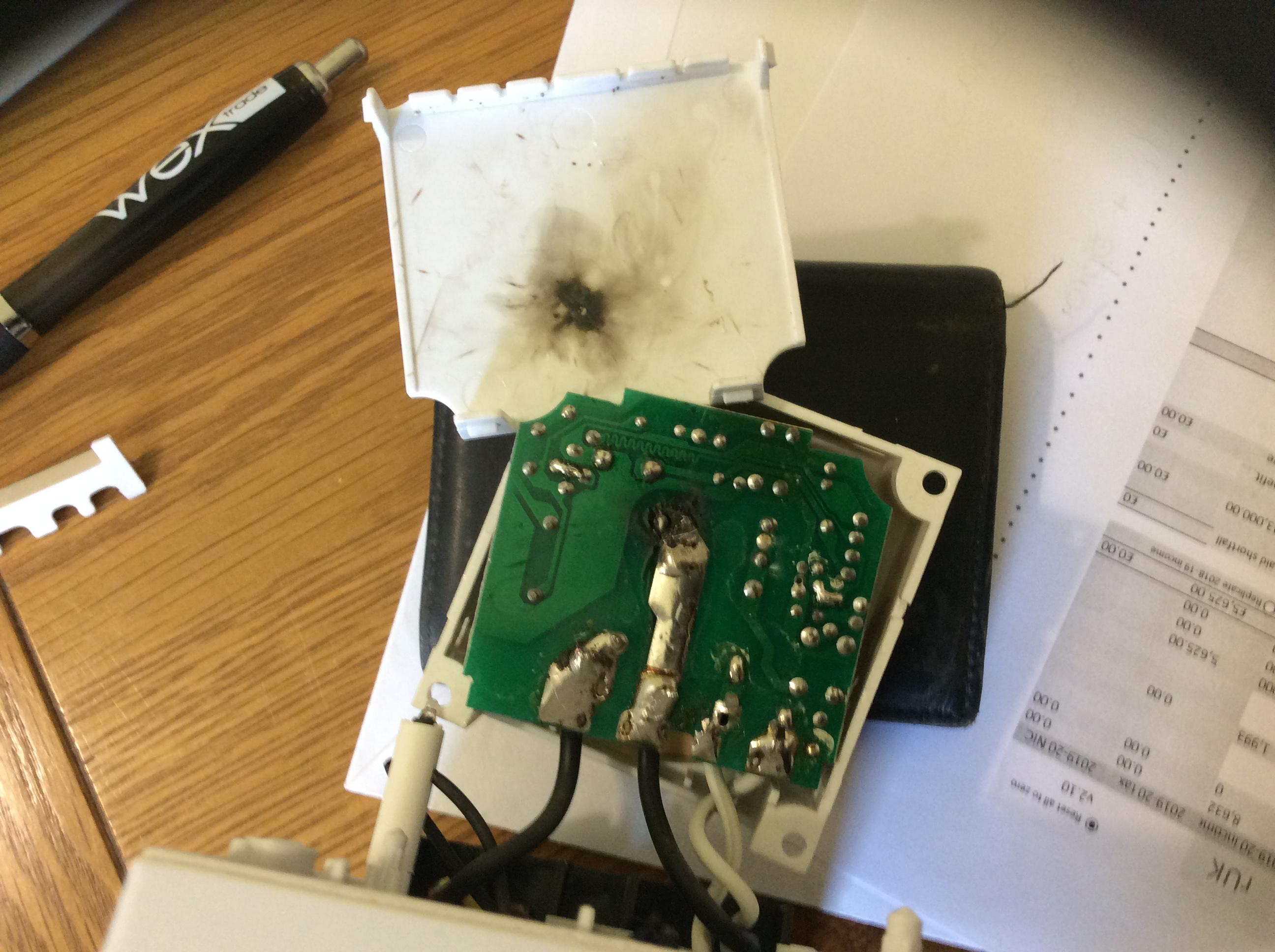

Russell griffiths Posted April 16, 2020 Author Posted April 16, 2020 So just as a safety precaution I pulled this thing apart could you pair shed some light as to why this might have gone pop if its chinesium shit then fair enough, I just want to make sure it won’t burn the house down. Should it have tripped the breaker??
Jeremy Harris Posted April 16, 2020 Posted April 16, 2020 What's on the other side of the PCB? It looks as if it may just be that the PCB track has burned out, if that connection is to a relay contact. Could be something as simple as a dodgy solder joint that's decided to fail, and the black marks are where it's been arcing. A fault like this wouldn't trip an MCB, but would now be picked up by an arc fault detection device (AFDD).
ProDave Posted April 16, 2020 Posted April 16, 2020 As long as the relay is okay a bit of soldering will fix that. I would lay a bit of copper cable on the track to reinforce it when repairing that. It reminds me of one make of solar PV dverter that a friend has. I have twice repaired it where PCB tracks have failed like that. It has not failed again since I laid a length of 2.5mm copper cable along the track to reinforce it.
Temp Posted April 16, 2020 Posted April 16, 2020 Looks like it failed where the leg of a component came through the board. Needs a good clean up so it can be soldered well.
