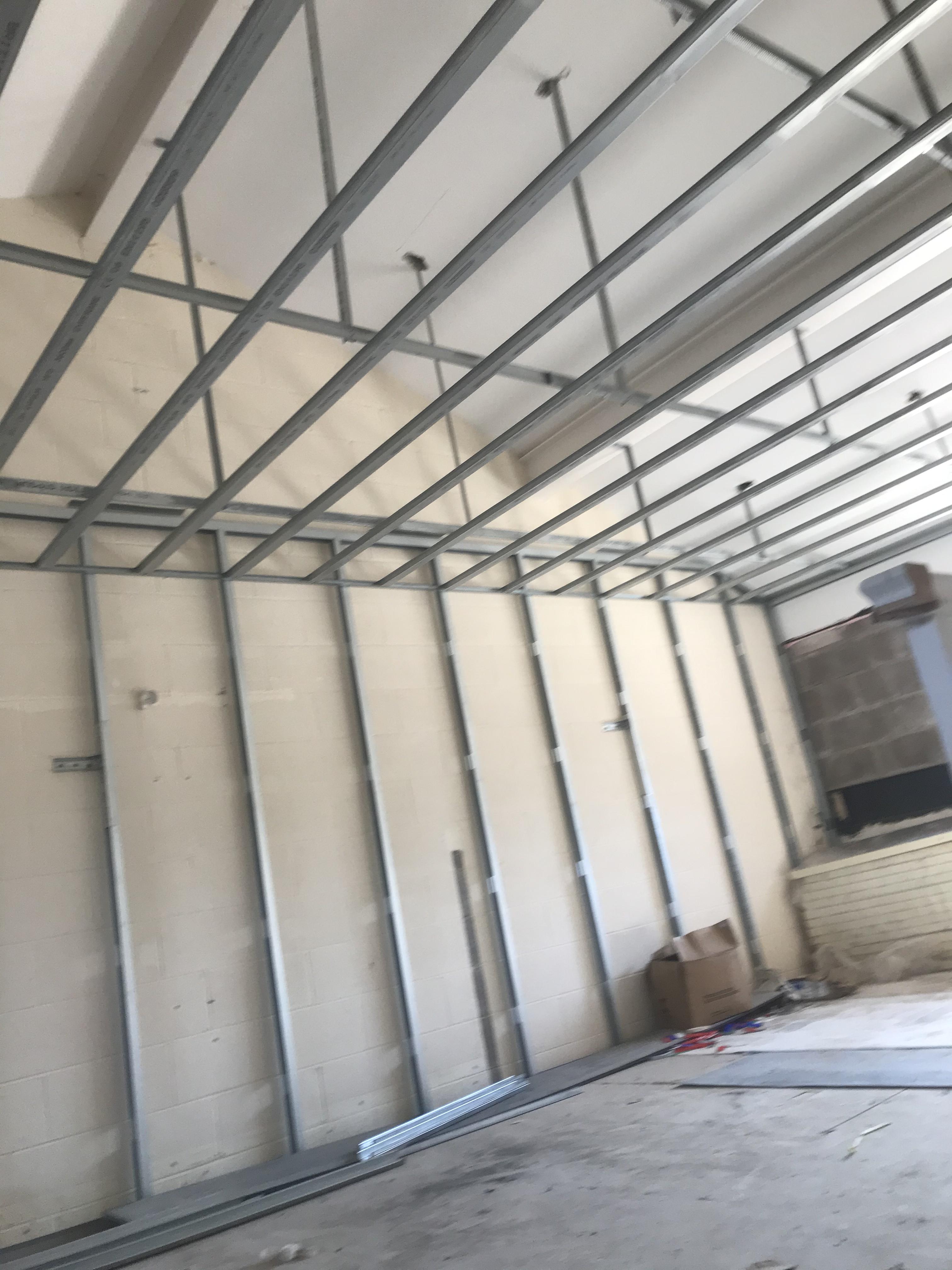

nod Posted April 12, 2020 Posted April 12, 2020 8 hours ago, PeterW said: You will have a gap regardless - battens will be thicker if anything, unless you’ve got 25mm insulation between the battens and then insulated plasterboard over. Pictured is one of our jobs that we are doing at the moment Five offices being converted into houses While there is cavity walls with insulation Like yours it’s not sufficient As Peter rightly pointed out an air gap gives you far better performance pictured 50 mill i stud 15 mil off the block work 50 mil insulation Then plaster boarded The couple of brackets seen are temporary and will leave the studs standing independent giving excellent acoustics also
Archer Posted April 14, 2020 Posted April 14, 2020 Sorry, to be clear, the issue with the D&D installation method isn't to do with the thermal performance of the air gap itself. It's to do with airtightness, and in particular the risk of air getting in behind the insulation layer, particularly in retrofit situations where the wall may have gaps in blockwork or mortar. This article has a full explanation and some possible ways of preventing which include a parge coat to the wall prior to installation. https://www.designingbuildings.co.uk/wiki/Defects_in_dot_and_dab The air gap shown above in Nod's image is beneficial, but only if the wall behind and any penetrations through are air sealed. If using steel studs then something to mitigate cold bridging would be needed otherwise you'll lose something like 50% heat through the stud. If using timber then it's less of an issue but you can either batten over the insulation or have a double layer as Peter described.

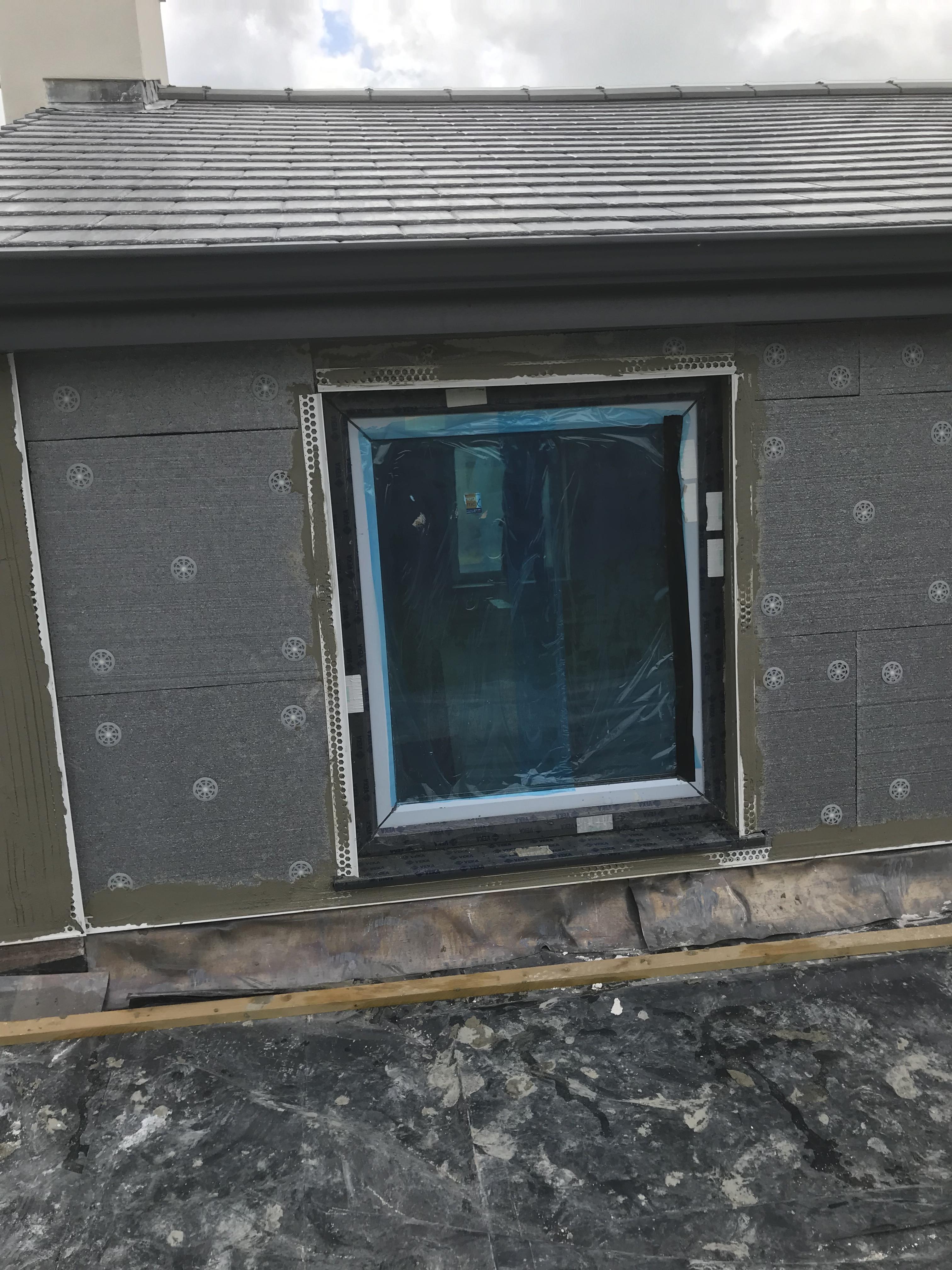

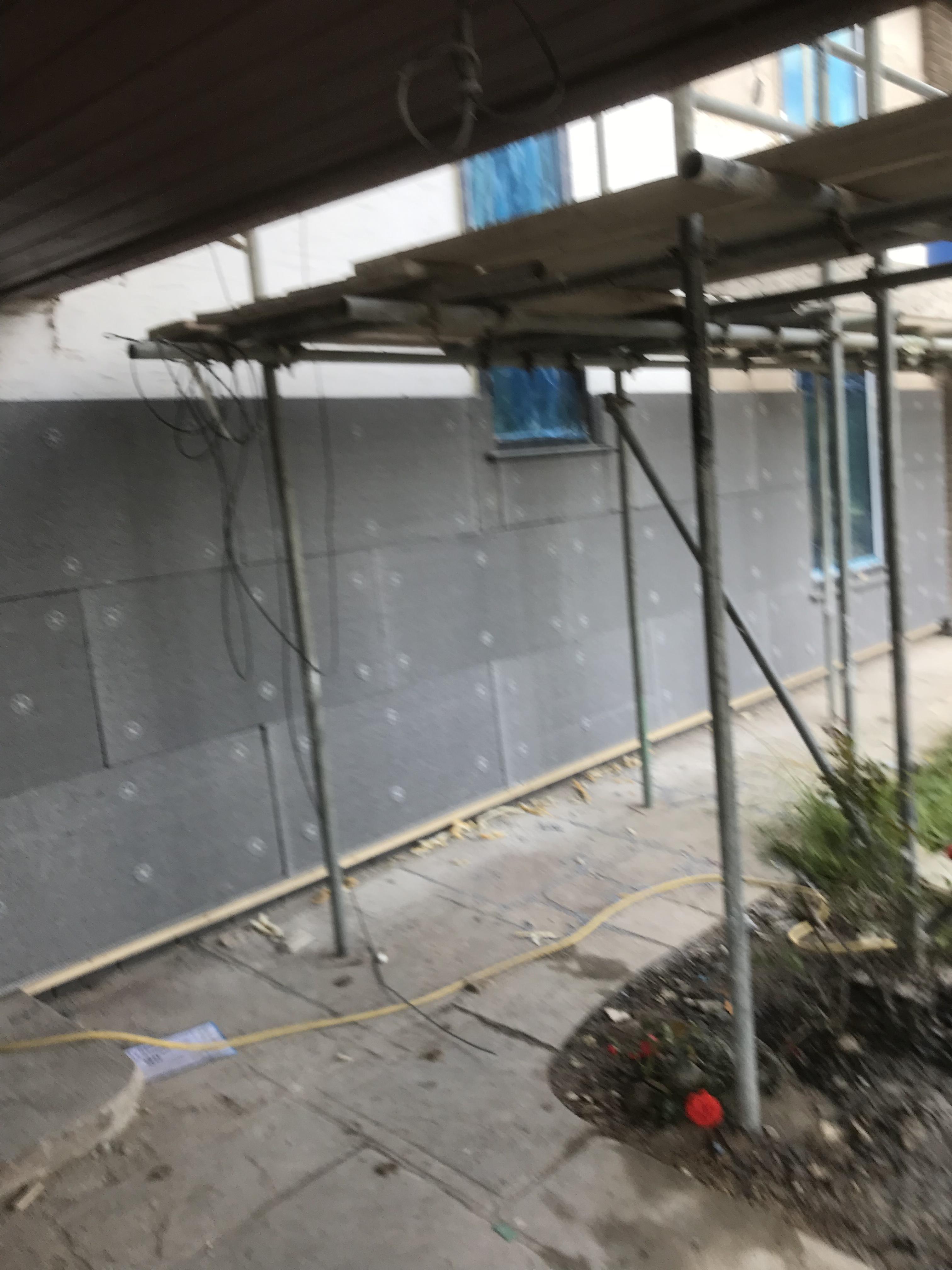

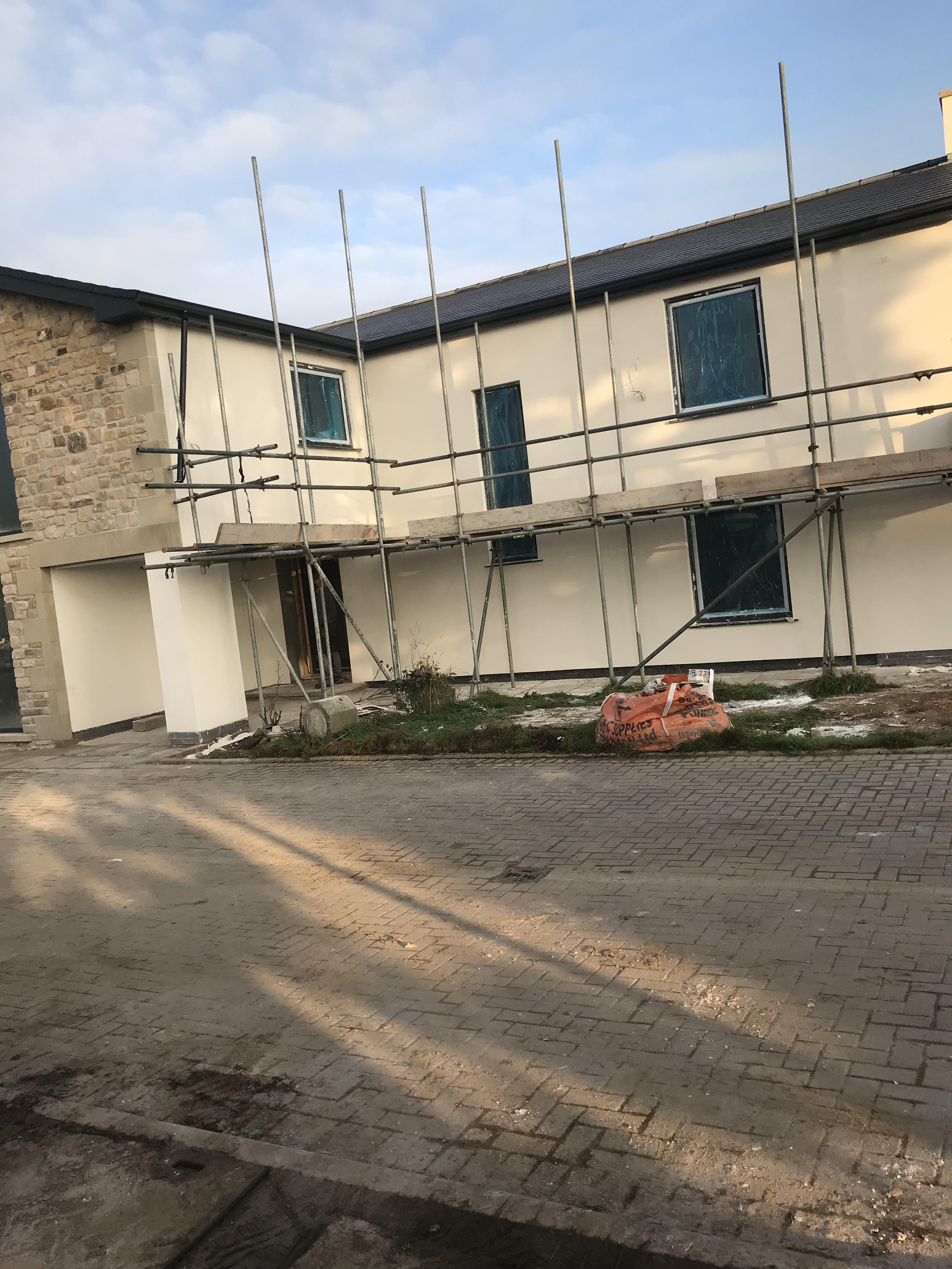

canalsiderenovation Posted July 22, 2020 Author Posted July 22, 2020 1 hour ago, tanneja said: @canalsiderenovation what did you do for EWI in the end? It's in progress you can follow my blog posts. On the existing we are having external wall insulation. I'll be posting as we progress.
