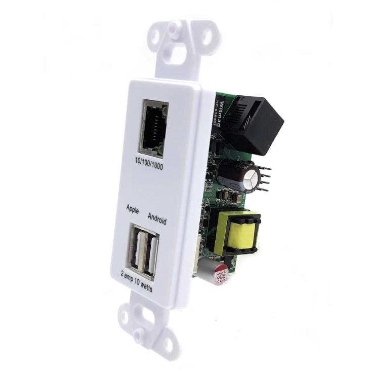

PeterW Posted April 12, 2020 Share Posted April 12, 2020 If you are using 10/100 rather than Gbit networks, and don’t have PoE requirements, then you can use the spare pairs to double up each socket if needed. Brown and blue are unused in normal wiring so you can wire these as the “other” pair. Other option is to use PoE to power a passive switch somewhere else in the network and use that to split to your other port requirements. Link to comment Share on other sites More sharing options...
SteamyTea Posted April 12, 2020 Share Posted April 12, 2020 37 minutes ago, PeterW said: then you can use the spare pairs to double up each socket if needed. Brown and blue are unused in normal wiring so you can wire these as the “other” pair. I had some adaptors that allowed for that. Link to comment Share on other sites More sharing options...
PeterW Posted April 12, 2020 Share Posted April 12, 2020 Shame they only make these for US socket plates https://www.poetexas.com/products/gaf-usb2 Link to comment Share on other sites More sharing options...
