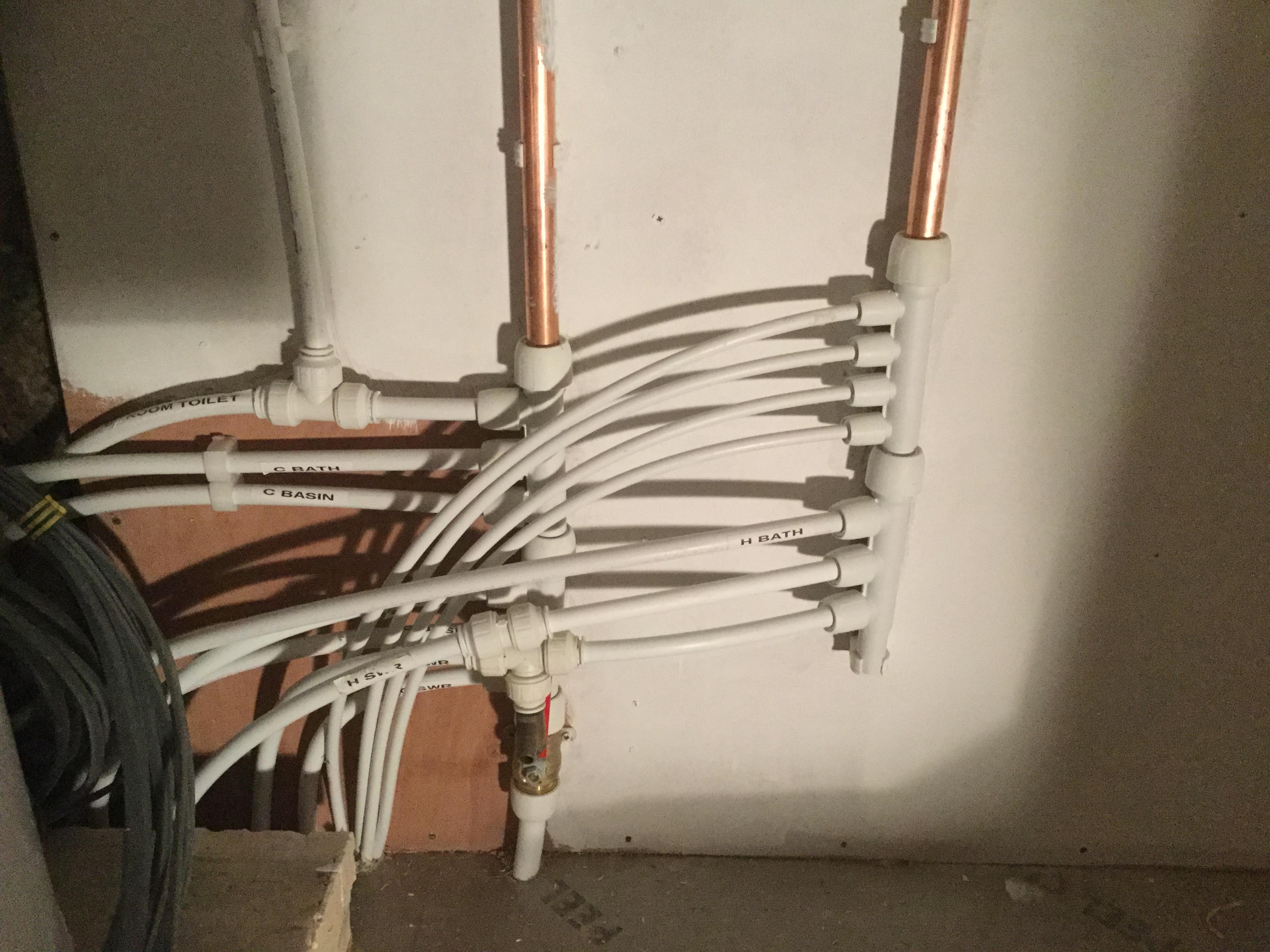

joe90 Posted April 11, 2020 Posted April 11, 2020 (edited) That’s exactly what I did, with 15mm to showers, works great ? one fir hot and one fir cold. (Not the neatest instal but pipes went in early) Edited April 11, 2020 by joe90 Add 1

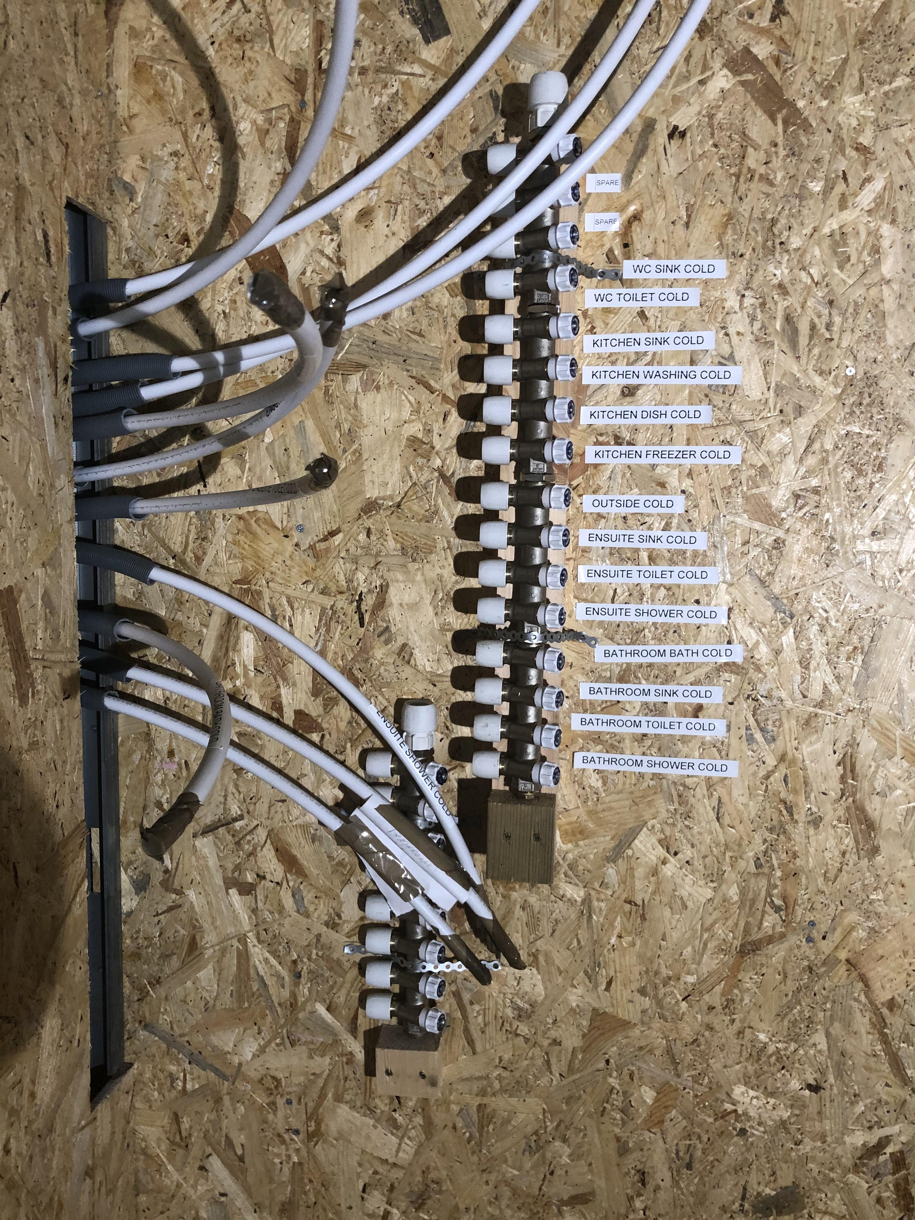

Pocster Posted April 11, 2020 Posted April 11, 2020 (edited) I must show a picture of mine - I must !! 15mm for everything Edited April 11, 2020 by pocster
joe90 Posted April 11, 2020 Posted April 11, 2020 30 minutes ago, pocster said: I must show a picture of mine - I must !! 15mm for everything ok, so yours is bigger than mine (and neater) ? but I have to say basins run in 10mm gets hot water very fast (at least mine is finished ?????) 1

Pocster Posted April 11, 2020 Posted April 11, 2020 Just now, pocster said: Don’t care ! Mines the biggest Ah ! But in theory my 15mm bath should fill quicker ?✊

joe90 Posted April 11, 2020 Posted April 11, 2020 1 hour ago, pocster said: Ah ! But in theory my 15mm bath should fill quicker ?✊ no, my bath, kitchen sink and showers are all 15mm, basins and toilets in 10mm ? 1
