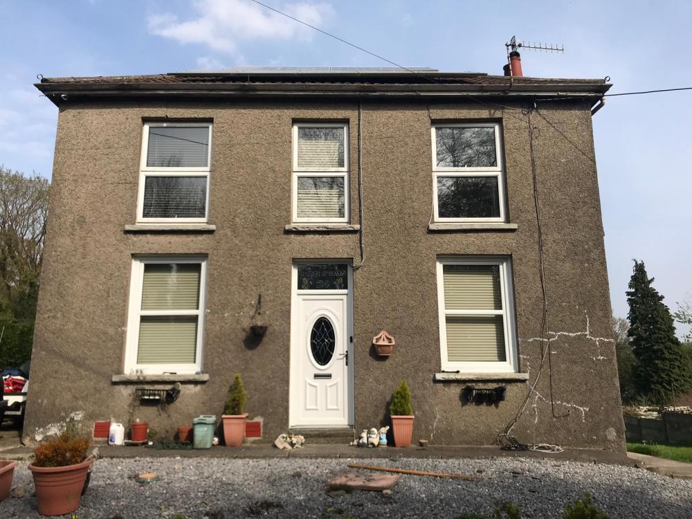

AliG Posted April 8, 2020 Posted April 8, 2020 (edited) For reference this is what you want to replace. Is the main bone of contention that the replacement isn’t rendered? If that’s all it takes to get the house built then even if you don’t want render I’d just go with it. I think you’ve tried hard and it is probably now time to compromise. I can see how they might think the front elevation is too different. The plot looks plenty big enough and so it seems that the only concern is making the front look similar to the other houses. Is there any other issue like the shape of the windows or the proportions? I am trying not to be mean but I can’t see how anything new wouldn’t be an improvement. Edited April 8, 2020 by AliG

Dicky Posted April 8, 2020 Author Posted April 8, 2020 1 hour ago, AliG said: For reference this is what you want to replace. Is the main bone of contention that the replacement isn’t rendered? If that’s all it takes to get the house built then even if you don’t want render I’d just go with it. I think you’ve tried hard and it is probably now time to compromise. I can see how they might think the front elevation is too different. The plot looks plenty big enough and so it seems that the only concern is making the front look similar to the other houses. Is there any other issue like the shape of the windows or the proportions? I am trying not to be mean but I can’t see how anything new wouldn’t be an improvement. @AliG most of the new build will be render other than where we want the stone. They ain't bothered about the back end of the house and also have said that we can put stone on the garage front cause "it's down the back" as the woman put it. They said if we moved the house over and changed the roof to a half hipped instead of gable then the other parts may be ok. Her words were "don't give us all of the changes at once as it may keep her boss happy if we do one or two". Yet during a phone call with said boss, she hadn't sat down with the woman dealing with our planning to discuss changes and that our planning handler was the one requesting the changes. The communication level seemed nonexistent in the office from multiple phone calls I had with the boss.

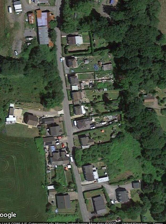

Dicky Posted April 8, 2020 Author Posted April 8, 2020 @joe90 first picture is the house at the bottom of my street, probably been up about 8yrs. The 2nd house is a house on my mothers street about 2 minutes drive from me, not a single house looks like it on the street and as you can see from the rear, it's literally dwarfs everything around it, this got build at the start of 2019. And the case worker for this house is the one that dealt with mine ? ??♂️ and did I mention he's a local builder and owns a building firm ?

AliG Posted April 9, 2020 Posted April 9, 2020 I assume that the house isn't in a conservation area or anything like that? Did the appeal include pictures of these various different finishes nearby? The whole planning process is oddly personal in that planner may like a design and be happy with it and someone else may not. This really is why design should not be that important, it is very subjective. I would have thought the planning inspectorate would take this view and with information on a large number of different finishes nearby would have approved it. TBH though, this is all moot. You can either put in a slightly different application with more supporting information and try again which will probably take some time and expense. OR I know it may seem tough on you, but considering the cost of building a house and the value of it to you as an asset, if all you have to do is make a change from stone to render and a minor design change to get it approved then that is probably the best course of action.

AliG Posted April 9, 2020 Posted April 9, 2020 I had a look on Google Maps. It looks like the house is at the end of a row of 8 houses that all look broadly similar in that the have totally flat fronts and are mainly render with some bricks. Indeed virtually all the houses in the street are rendered some with more brick than others, but there is very little use of stone. There are a couple of bungalows about 150m away at the end of the road with some stone on them. They are close to the house you show opposite the end of the street and around half of the houses in that street use stone, it has quite a different mix to your street. Now would I mind your use if stone, no not really, but is it an unusual material for the street, yes it is. The street doesn't look that uniform that I would care but it is not being entirely unreasonable to try and keep some similarity. There is a wide variety of architectural styles in the street I live on with houses built at various points over the last hundred years. But every house is mainly rendered and planning like to see some continuity of materials. Also no house on that side of the street has any kind of porch or anything jutting out of the front. Most of them are totally flat, so again I can see the request to be the same.
