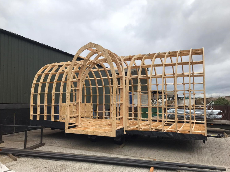

iSelfBuild Posted April 6, 2020 Posted April 6, 2020 Trailer and a skeleton kit and then plod on with the rest DIY 6

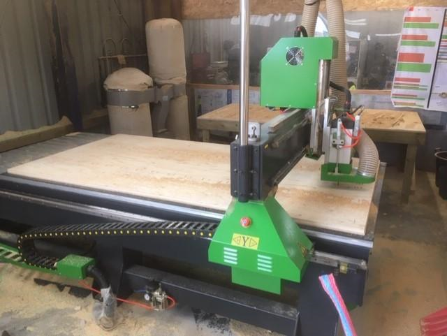

Jeremy Harris Posted April 6, 2020 Posted April 6, 2020 18 minutes ago, iSelfBuild said: Trailer and a skeleton kit and then plod on with the rest DIY Are the frames for that CNC cut ply?
iSelfBuild Posted April 6, 2020 Posted April 6, 2020 1 minute ago, Jeremy Harris said: Are the frames for that CNC cut ply? Yes they are 1

PeterW Posted April 6, 2020 Posted April 6, 2020 Just now, Jeremy Harris said: Are the frames for that CNC cut ply? I was thinking that ... and currently planning something like a Maslow CNC.... but that’s the theme for another thread !!
