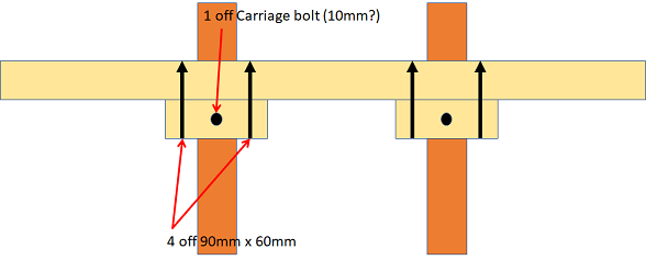

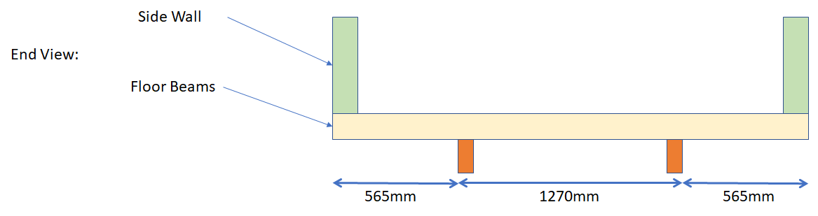

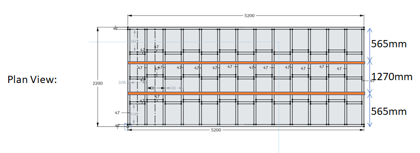

MortarThePoint Posted April 9, 2020 Author Posted April 9, 2020 Last chance for me to change my mind on the timbers I'm looking to use for the base. The trailer has two rails that go the full length of the trailer and are 1270mm apart. The width of the hut is 2200mm or 2400mm, not decided yet. If I presume 2400mm, that means the hut overhangs the sides of the rails by 565mm on each side. Do you think 4x2 timber will be strong enough for that cantilever? They are on ~400mm centres and the panels and weight of the hut itself is likely to be equivalent to less than 50kg bearing down on the end of the 4x2. Adding that someone could stand against the wall and that could add as much as another 100kg. Does 150kg on the end of a 4x2 cantilever 600mm long sound OK? There is lots of safety margin in that as the person's weight wouldn't be solely supported by the one beam and the walls etc will be much less than 50kg (the panels way <20kg per 400mm).

MortarThePoint Posted April 10, 2020 Author Posted April 10, 2020 HEALTH WARNING: AMATEUR AT WORK!! Right so I am going to have a go at playing Structural Engineer. I've found a copy of BS5268 - Structural use of timber. Table 8 of this has "Grade stresses and moduli of elasticity for various strength classes" and lists: C16 - bending parallel to grain 5.3N/mm2 and minimum Y=5800 N/mm2 C24 - bending parallel to grain 7.5N/mm2 and minimum Y=7200 N/mm2 My cantilever length is L ~ 600mm My maximum moment with 150kg at ~600mm is M = 150kg*9.81N/kg*600mm = 9E+5 Nmm A beam's second moment of inertia is I = b*h^3 / 12 (where b with its cross section width and h its cross section height) The resulting maximum deflection is d_max = M*L^2 / 2*Y*I The bending stress is sigma = M*y / I where y is the distance to the neutral axis so h/2, so sigma = M*h / 2*I For C24, Y = 7200 N/mm2 4x2 h = 100mm, b = 47mm Second moment of inertia: I = b*h^3 / 12 = 47*100^3 / 12 = 4E+6 mm4 The maximum deflection: d_max = M*L^2 / 2*Y*I = 9E+5 * 600^2 / (2 * 7200 * 4E+6) = 5.6mm. Bending stress: sigma= 9E+5 * 100 / 2 * 4E+6 = 11.25N/mm2 > 7.5N/mm2 SNAP! 5x2 h = 125mm, b = 47mm Second moment of inertia: I = 7.6E+6 mm4 The maximum deflection: d_max = 3.0mm Bending stress: sigma = 7.4N/mm2 < 7.5N/mm2 OK However, that is based on permanent loading, for short term loading you can multiply the permissible stress by a loading duration factor, K_3 = 1.5 (from Table 17 of BS5268). That raises the limit to 7.5 * 1.5 = 11.25 N/mm2 which makes the 4x2 OK (just). There are other factors (like the depth factor) which I could make fractionally greater than 1. My scenario is very pessimistic and in reality the 100kg person wouldn't be out at 600mm and their weight wouldn't be carried solely by one beam. I need to think carefully about how I secure the beams to the chassis so as not to weaken them. I'm thinking like this, but possibly only 2 screws holding the blocks on so that the screws are closer to the neutral axis. Do these calculations look correct? HEALTH WARNING: AMATEUR AT WORK!! http://www.learneasy.info/MDME/MEMmods/MEM09155A-CAE/020-Compare/Compare_to_formulas.html
ProDave Posted April 10, 2020 Posted April 10, 2020 One thing you have not mentioned yet is the ring beam around the perimiter. This joins all the joist ends together. So it has the effect of spreading the load on one beam to adjacent beams. So someone jumping on the floor at the edge, the load won't be placed on one beam, but shared by several. Likewise a high static load on one will be shared by adjacent beams. Our static caravan which is much the same construction, though with a shorter cantilever is made of timbers that look more like 3" by 2" I think it has something like 2" steel angle around the edge as a "ring beam" 1
MortarThePoint Posted April 10, 2020 Author Posted April 10, 2020 ProDave, you're right I'm sure it would make a big difference and lower the maximum stress considerably. I did mention "their weight wouldn't be carried solely by one beam", but that perhaps understates it. I'm happy that C24 4x2 would be sufficiently strong, but wanted to crunch some worst case numbers to get some confidence. I may double up a couple of the beams at the doorway though.
SteamyTea Posted April 10, 2020 Posted April 10, 2020 Could you add another 4 by 2 below the chassis and join them up with ply. In effect make a large box section. You would have to get creative around the chassis. It would also be somewhere to stuff full of insulation.
MortarThePoint Posted April 10, 2020 Author Posted April 10, 2020 (edited) On 10/04/2020 at 09:40, SteamyTea said: Could you add another 4 by 2 below the chassis and join them up with ply. In effect make a large box section. You would have to get creative around the chassis. It would also be somewhere to stuff full of insulation. Expand I think I understand what you are suggesting, effectively making a timber I-beam. From the calculations I am content that it will be stiff enough without that. There will be a fair amount of cold bridging, but the plan is to fill the gaps between the 4x2 noggins with 100mm Celotex then with 18mm CDX ply on top and 9mm CDX ply beneath. If I make it too warm then a log burner would turn it in to an oven. Probably already the case actually as not many shepherd huts will have a 100mm PIR insulated envelope. That's better insulated than we are planning for the house. Edited April 10, 2020 by MortarThePoint

MortarThePoint Posted April 10, 2020 Author Posted April 10, 2020 I've realised the figures for the deflection were wrong as I should have used: d_max = W*L^3 / 3*Y*I []NB: I used Y for Young's modulus but table uses E] as set out on the second line of the BEAM BENDING table. I didn't read the table properly as I assumed M=W*L applied to the deflection as well, but it doesn't ( M = W*(L - x) ). That changes the deflections figures to: 4x2 : d_max = W*L^3 / 3*Y*I = (150*9.81) * 600^3 / (3 * 7200 * 4E+6) = 3.7mm 5x2 : d_max = W*L^3 / 3*Y*I = (150*9.81) * 600^3 / (3 * 7200 * 7.6E+6) = 2.0mm
