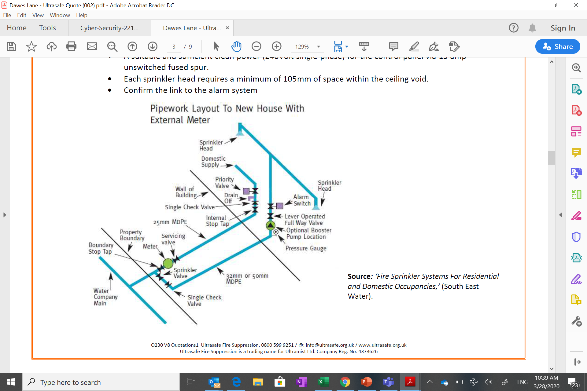

redtop Posted March 28, 2020 Author Posted March 28, 2020 3 minutes ago, PeterW said: I would use a brass full bore 1 1/2” DCV with a pair of MDPE connectors each end. And what is the definition of 32mm from the mains for a sprinkler system ..? Need to see the spec but I can’t see how splitting underground is any different than splitting as soon as it enters the building ..?? here is their pic
PeterW Posted March 28, 2020 Posted March 28, 2020 So reading that you need two dedicated supplies and one from before the meter ..?? What have the water company installed and where is the meter ..??
scottishjohn Posted March 28, 2020 Posted March 28, 2020 looking at diagram you get free water down the sprinkler route as it by passes meter --that don,t seem right

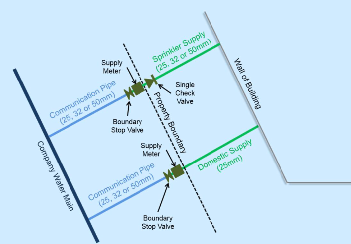

Mike Posted March 28, 2020 Posted March 28, 2020 (edited) Are you looking at the current document? Found a copy here (pdf), probably from 2018 from the file name, and the diagrams differ significantly from the one posted above. Have you considered installing a misting system as an alternative to sprinklers? Edited March 28, 2020 by Mike
Mr Punter Posted March 28, 2020 Posted March 28, 2020 1 hour ago, scottishjohn said: looking at diagram you get free water down the sprinkler route as it by passes meter --that don,t seem right Correct. The water companies are not allowed to charge for supplies for firefighting / sprinklers.

redtop Posted March 28, 2020 Author Posted March 28, 2020 the diagram I posted is slightly wrong, sorry. you can have one supply for both house and sprinkler provided the right type of meter has been fitted, which has. Havnt really looked at misting systems, thought they were expensive but will take a look, D
