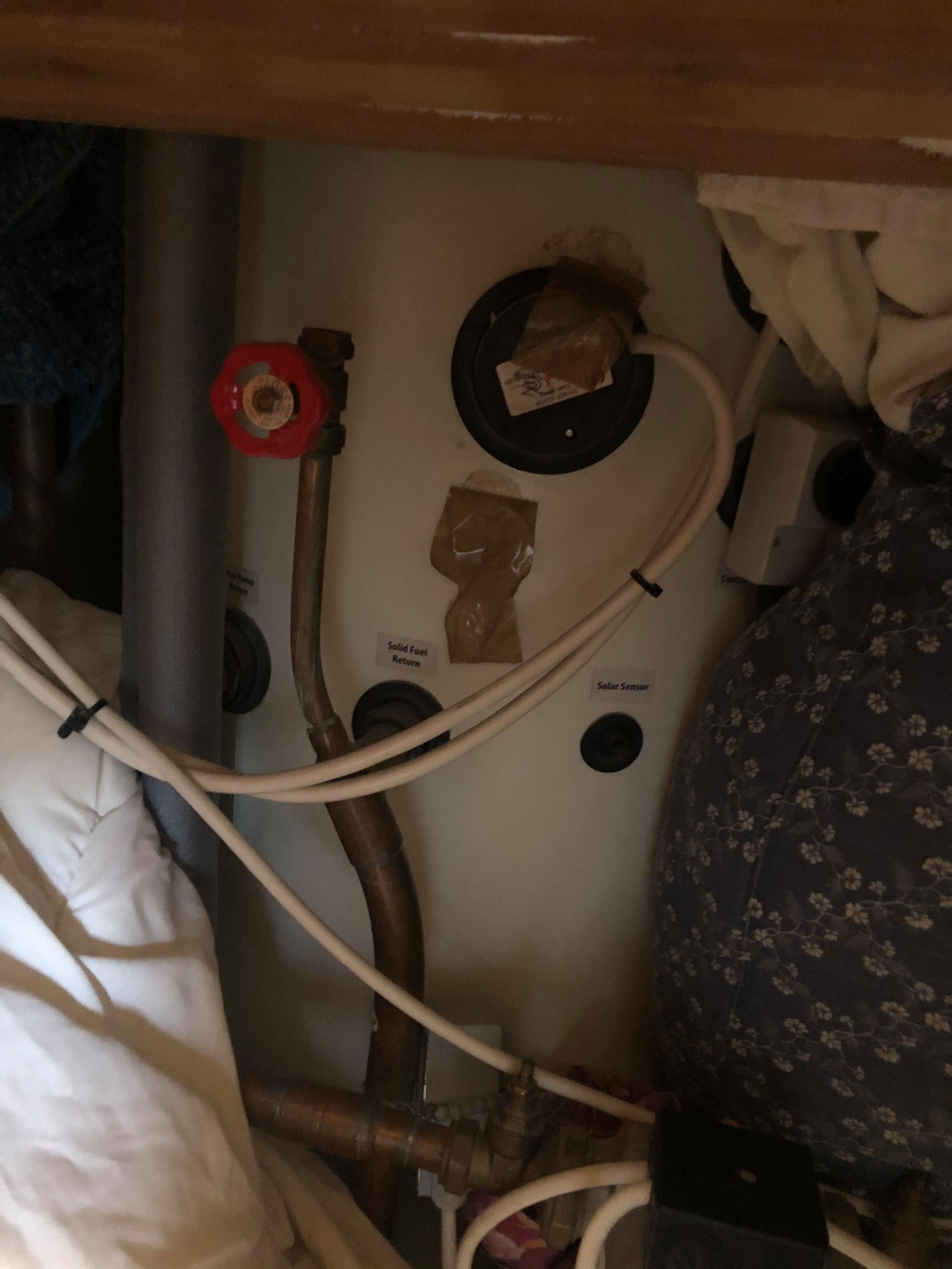

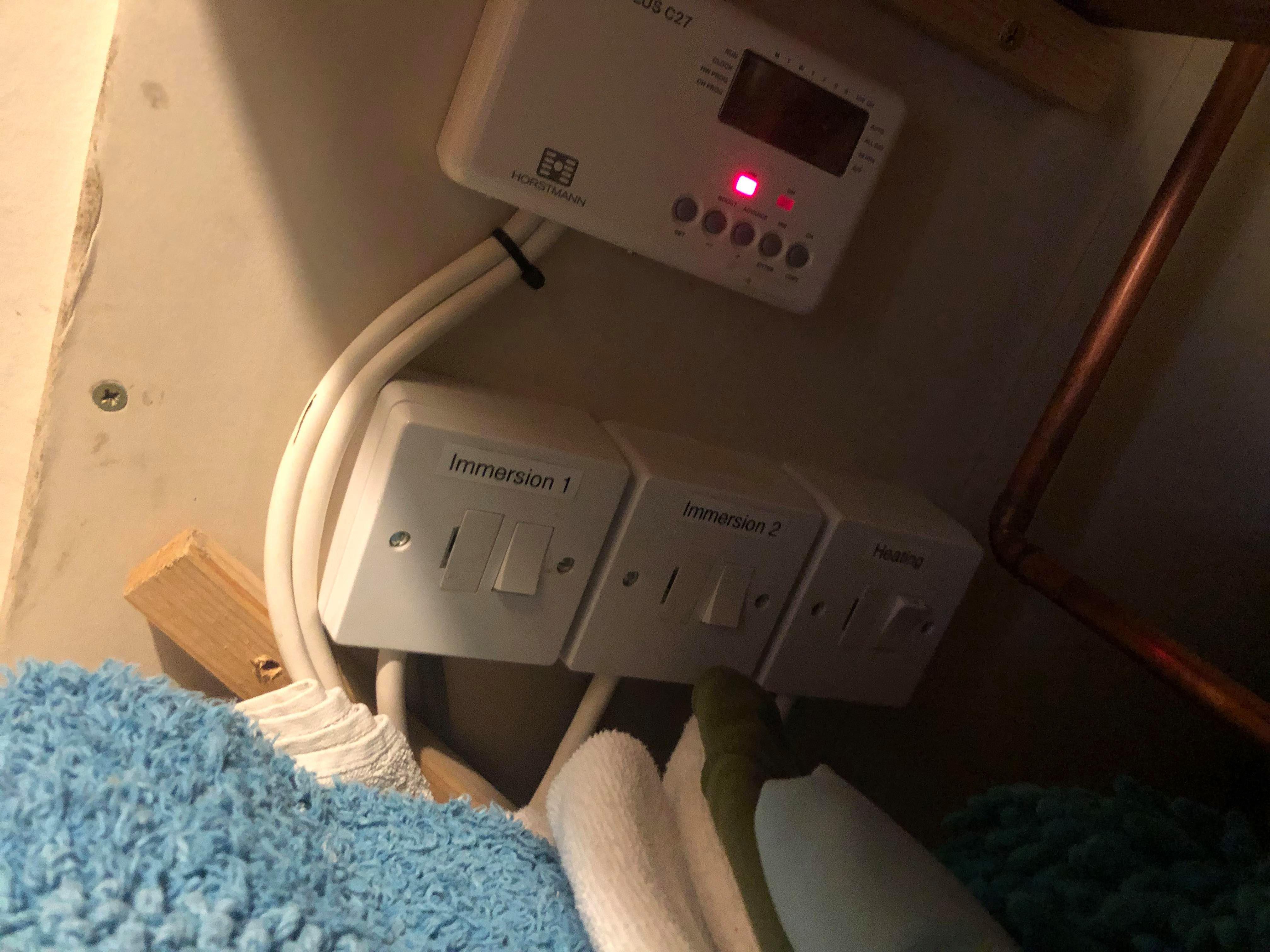

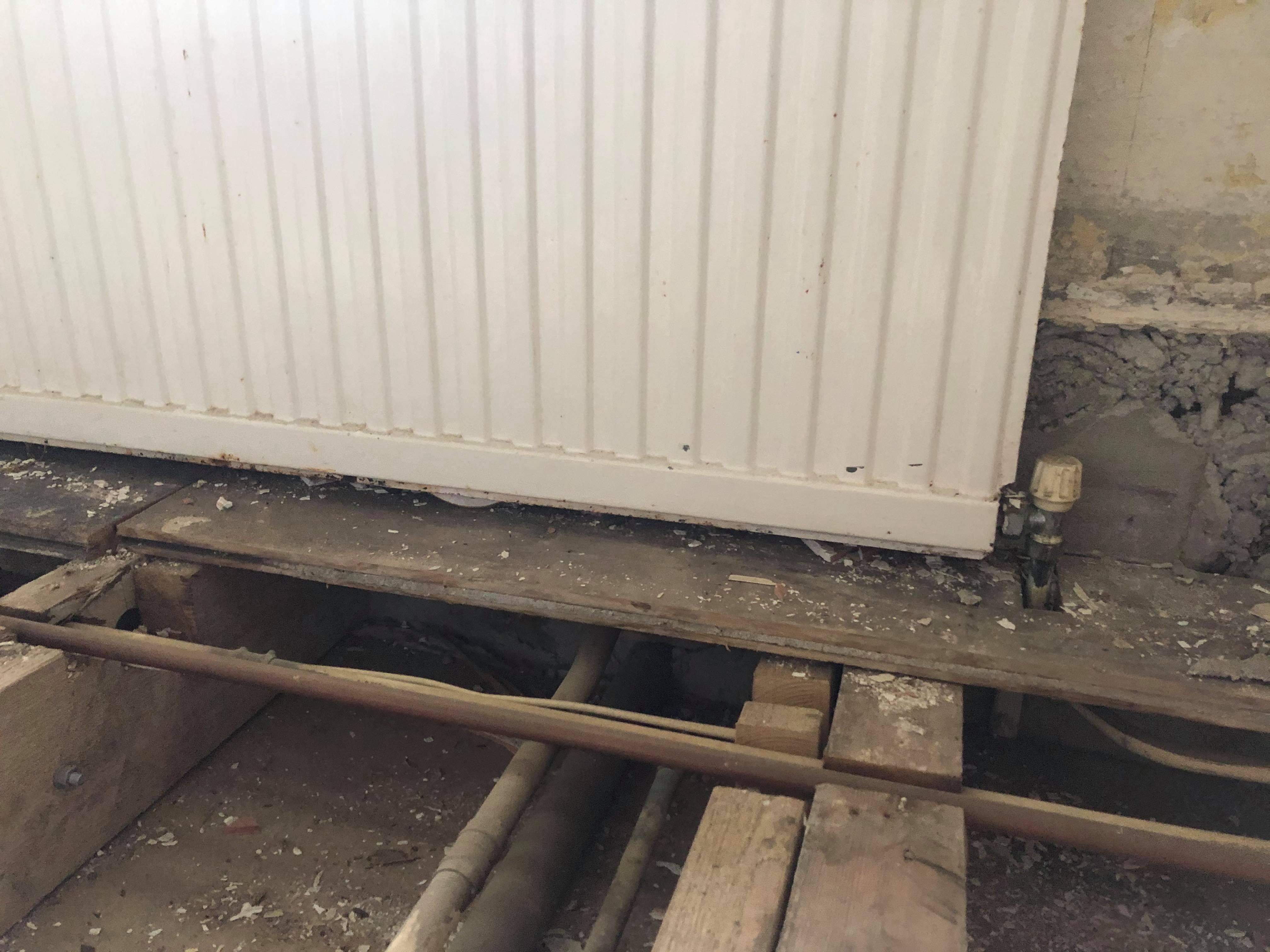

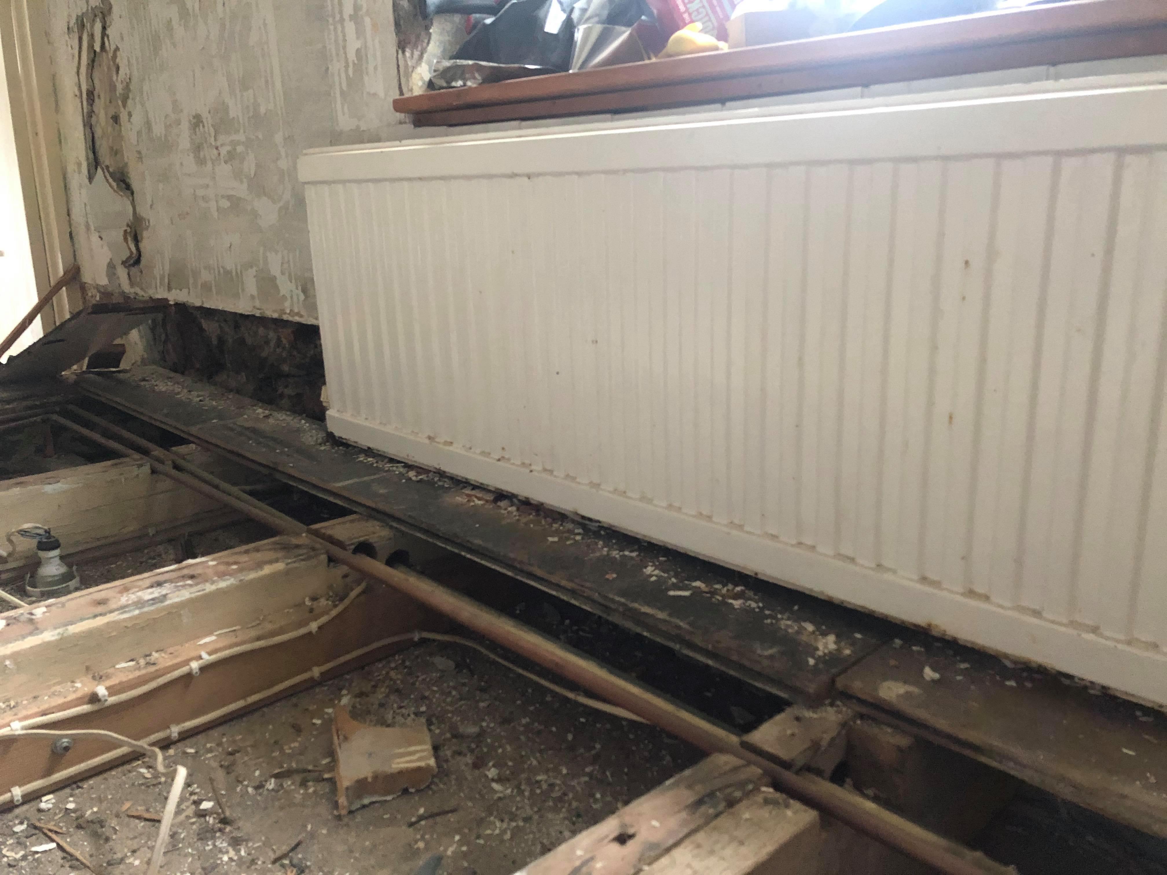

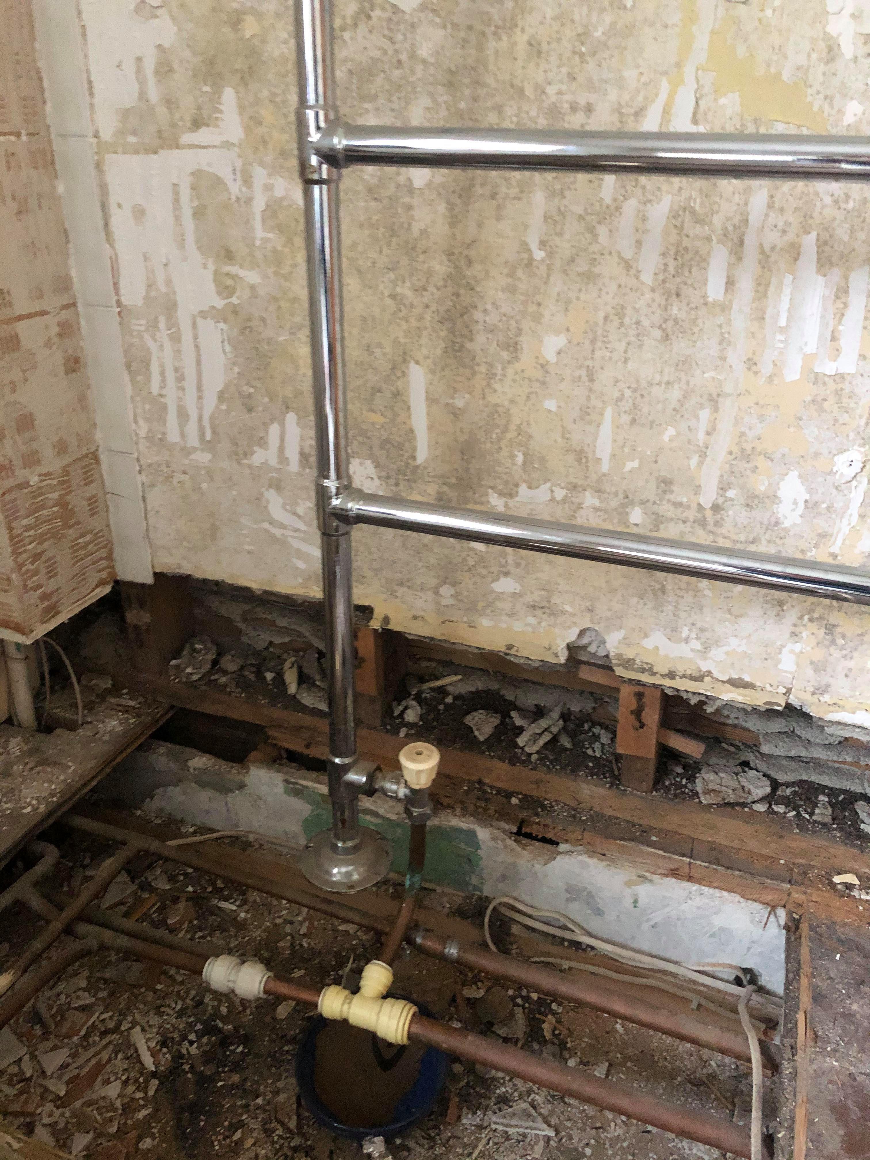

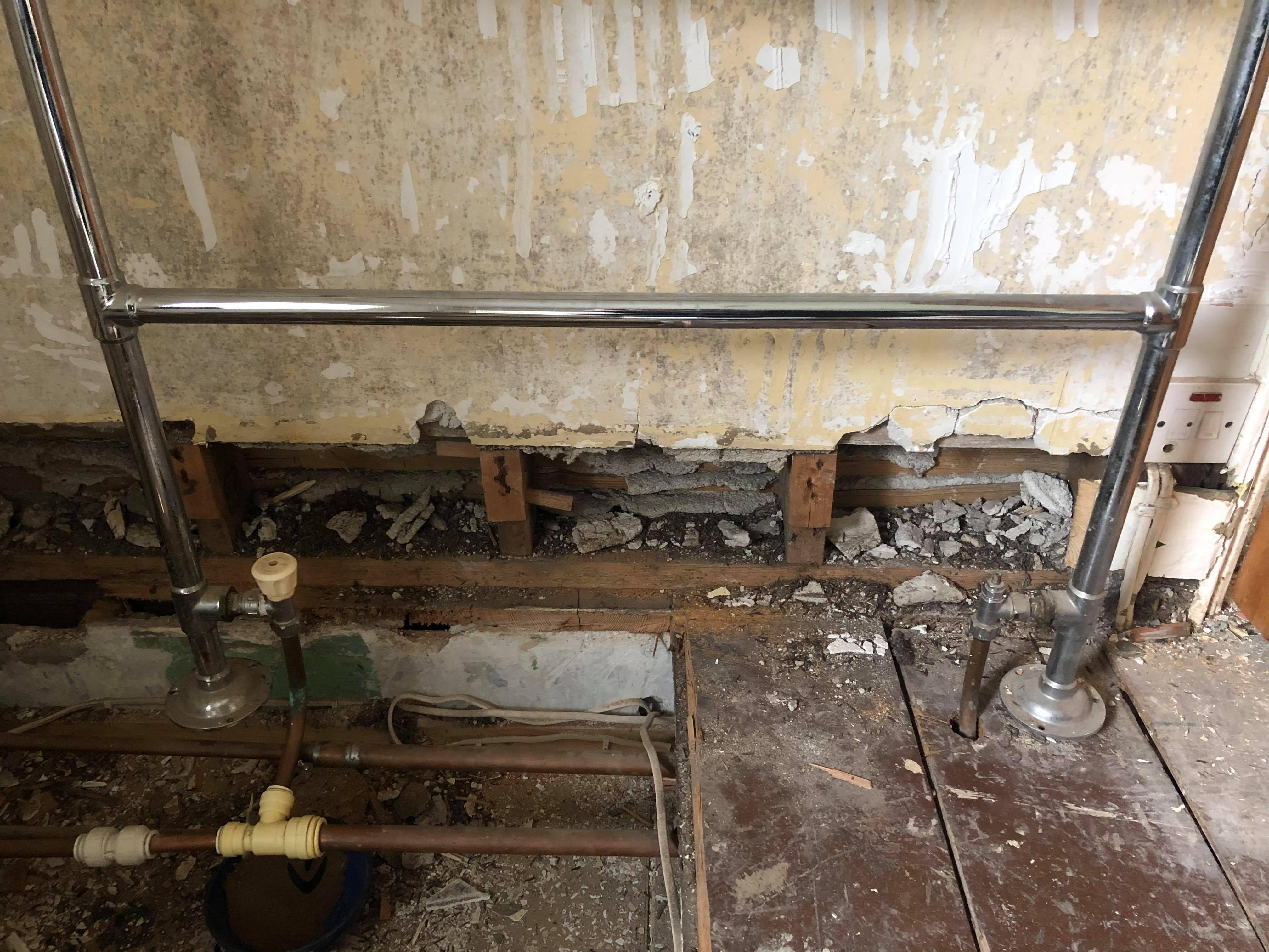

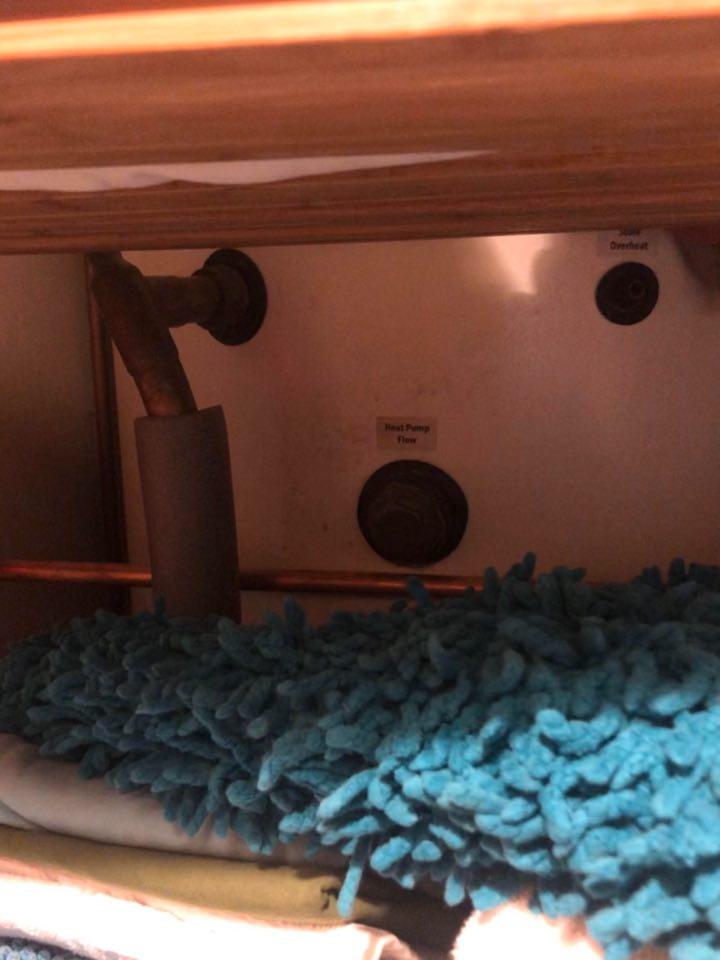

OK so we had a plumber booked in today to remove some old radiators in my mums bathroom, which is under renovation by us. The plumber cancelled because of the lockdown (I know there is a lot of confusion about who can work and who cant) One of the radiators is leaking ( a little, but still). Our plan is actually to remove these radiators completely - there are two.
Can anyone walk me through how to do this? Unless I shouldnt and should try to find someone who can do it.  I have disconnected the bath and toilet and sink etc as thats a matter of just turning the water supply to the house off before cutting and capping the pipes, but what do I need to do for radiators? Attached are pics of the tank, and the radiators.

Back to the job in hand do one radiator at a time
close radiator valves both sides
 best to take white cap off valve and
use adjustable  spanner for last little tighten
then with your radiator key open bleed valve at top ,
water should stop coming out once pressure  has dropped
( if water keeps piddling out then your radiator  valve is letting by and will continue to drain the system plus get your floor wet ).
On the assumption water stops you can now remove radiator
crack each valve taking care not to bend the pipe connector to valve
( use 2 spanners/wrench  to fight a against  each other one on the valve one on the valve nut )
before doing this create  a exit to bath or outside
if going over good carpet put dust sheets down ...you will spill a drop of black sludge .
Ok loosen one  side get o/h to push valve against  radiator
when you have loosened this stops excess  water dispersion ,
then loosen other side .
Right once both are loosened  you can quickly put fingers over radiator outlets and lift off ,
on smaller radiators  I then spin over top to bottom to stop water leaking out
( make sure you've tightened the bleed valve back up) then exit to drain off .
If you wish to remove all pipework your need to drain the system down .
