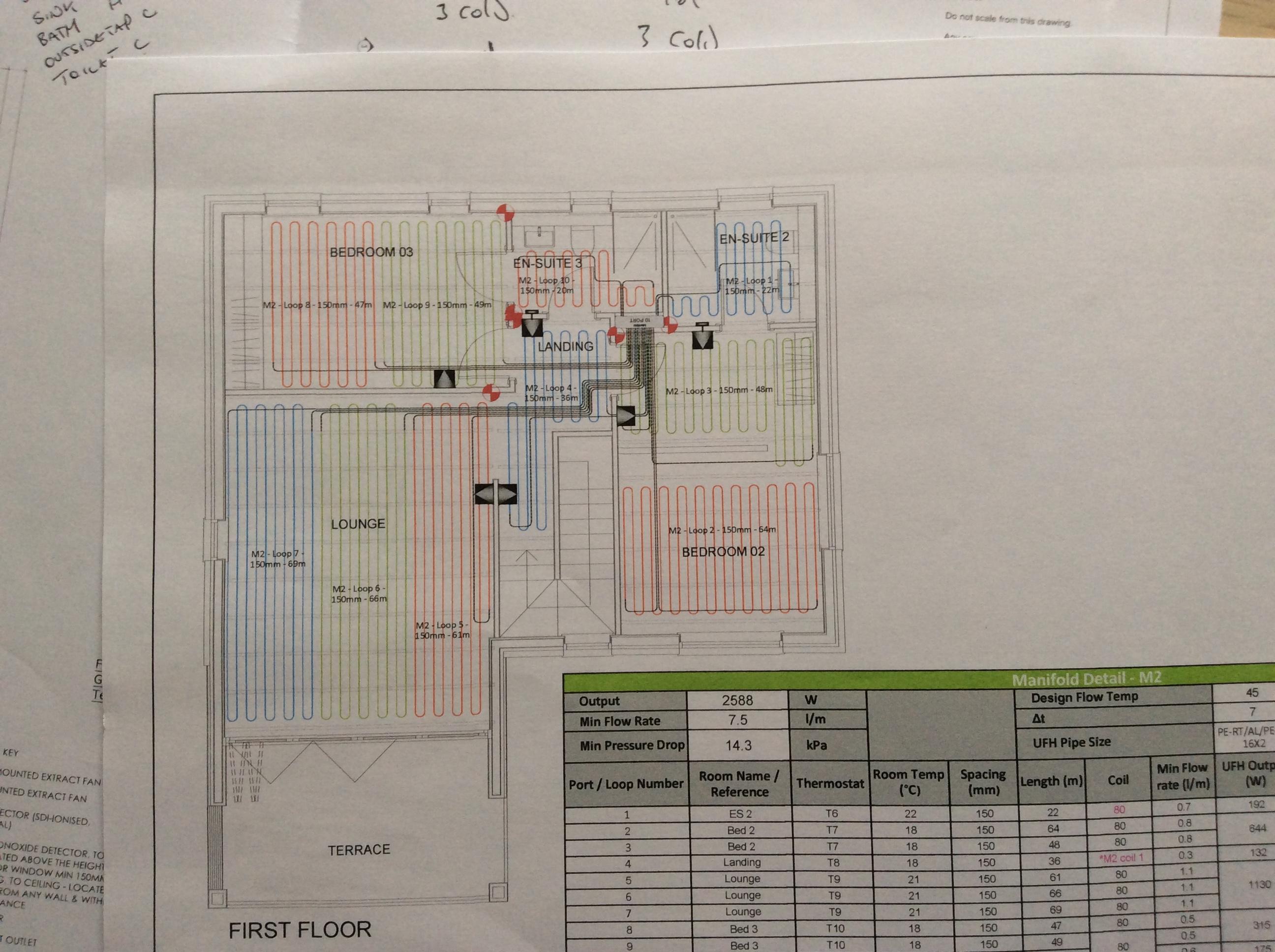

Taff Posted March 17, 2020 Posted March 17, 2020 Anyone clever enough to explain! Just going through layout of out of the floors, before I go back to designer and sounding stupid, I thought I could ask a stupid question on here without feeling embarrassed. Why are there multiple loops in some of the rooms? There are thermostats on each area so for instance, if I want the longe to be 20 degrees and the landing 18 degrees how the hell does that work, if half the loop is in another room? Full of stupid questions me
ProDave Posted March 17, 2020 Posted March 17, 2020 Multiple loops per room is normal for large rooms. the control centre is organised so that room thermostat opens 2 or 3 actuators together. I don't see loops bridging more than one room, other than pipes passing through on their way. e.g your downstairs hall by the stairs is never going to be cold. From experience, you will NOT need an UFH loop on the landing. Delete that one.
Taff Posted March 17, 2020 Author Posted March 17, 2020 Ah that explains it I thought as the loops were the same colour they belonged to a single connection, told you I was stupid! Will it save money getting rid of the landing as I’m told that the piping is pennies, or are you thinking workload of the pump?
ProDave Posted March 17, 2020 Posted March 17, 2020 It will possibly enable a smaller cheaper manifold, save a few ££ in pipe and labour fitting the unneeded landing loop. We had that in our previous house and I don't believe the landing thermostat ever turned on.

PeterW Posted March 21, 2020 Posted March 21, 2020 There are far too many thermostats in that design ..! Only works when all doors are closed and no air flow between rooms. I would reduce down to having one upstairs and one downstairs with the en-suite / bathrooms potentially on their own circuits just so you can run them for longer or slightly warmer.
Oz07 Posted March 22, 2020 Posted March 22, 2020 I had that problem with suppliers wanting to design a system with too many different zones. Your not going to get massive temp differences in a well insulated house

Taff Posted March 22, 2020 Author Posted March 22, 2020 10 hours ago, PeterW said: There are far too many thermostats in that design ..! Only works when all doors are closed and no air flow between rooms. I would reduce down to having one upstairs and one downstairs with the en-suite / bathrooms potentially on their own circuits just so you can run them for longer or slightly warmer. Think I’ll go back to the designer and tell him, the house hopefully will be well insulated, on reflection these seem pointless as you both point out ?

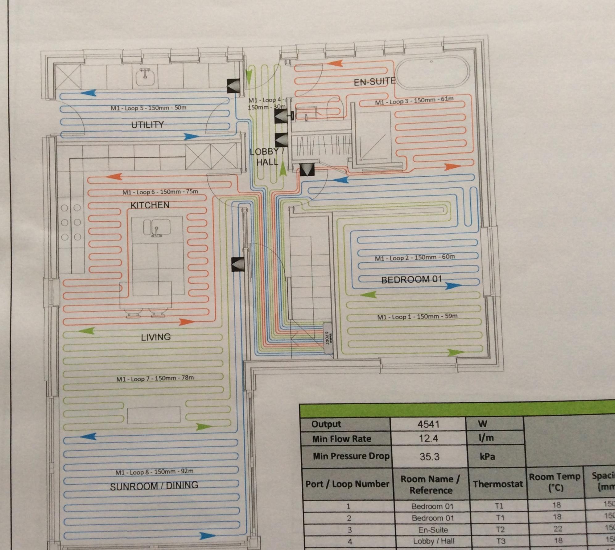

PeterW Posted March 22, 2020 Posted March 22, 2020 @Taff What is supplying the heat to the system ..??? Just seen it says supply temp of 45c, and that means gas or oil. I would seriously question if they have used a standard set of details or your build spec - that looks like a big heat loss to counter and 45c flow in a timber floor (??) upstairs is going to be hot.

Taff Posted March 22, 2020 Author Posted March 22, 2020 Supply will be ASHP, I’m beginning to think do we really need upstairs UFH, I’m going to have to go back through their design with a fine tooth comb I think.
Jeremy Harris Posted March 22, 2020 Posted March 22, 2020 I'm very glad we didn't install upstairs UFH. We find we don't need heating in the bedrooms at all, but then we also don't like the bedroom to be too warm. We try and keep the bedroom below 20°C, something that needs a bit of cooling from time to time (like yesterday, for example).
ProDave Posted March 22, 2020 Posted March 22, 2020 8 minutes ago, Taff said: Supply will be ASHP, I’m beginning to think do we really need upstairs UFH, I’m going to have to go back through their design with a fine tooth comb I think. Many of us with passive house or near passive house levels of insulation and air tightness find no upstairs heating is needed, even here in the Highlands. We have UFH in the bathroom and en-suite more so you are not walking in bare feet on "cold tiles" What sort of U values are you having in the walls, floor and roof, and what does your SAP assesment say about the heating input required? Like many others I fitted electrical points in each bedroom to provide for a small panel heater if I had "got it wrong" and we found heating was needed. Those are still sitting there, unused, with a blank plate on them.

PeterW Posted March 22, 2020 Posted March 22, 2020 @Taff you will struggle to get 45c from an ASHP - 35c is your target temperature and they should factor that into the design. What is the ground floor / first floor construction ..?
