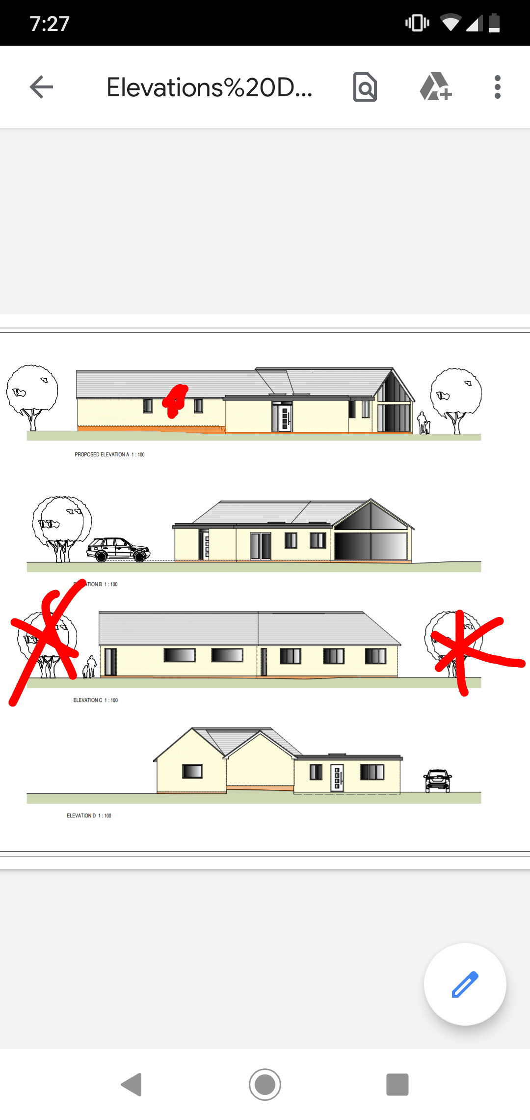

AliG Posted March 11, 2020 Posted March 11, 2020 I had to dig out some elevations you posted earlier. Almost every window in my house is a single unit. But almost every window is taller than it is wide. The only windows that are not taller than they are wide are split, so that the portions are taller than they are wide. Looking at your elevations, your windows seem to generally be wider than they are tall and seem to be drawn as split up. I think this is the usual thing to do, indeed window elements wider than they are tall are very rare unless it is a slot shaped window. I also think it would look odd to have some that are single units and some that aren't as it would create a jarring mixture of ratios. In fact a window that is 2400x1050 might be better split into three which would give a similar ratio for each segment to a 1810x1200 window split into two. If you want the 2400s to be single windows, then I would rather that they all kept a ratio of being wider than they are tall, but as you say I don't think you can get a single opener that size for the smaller windows. Looking at Ideal Combi as a top hung window gets wider, its height starts to be limited. I suspect it is a weight issue as @Temp says. Triple glazed windows are very heavy. Rationel, which we have, lists the same maximum sizes with a weight limit. I think the inside colour is just personal preference. Googling it, it didn't seem too bad if that's what you want. It may not go well with all colours.

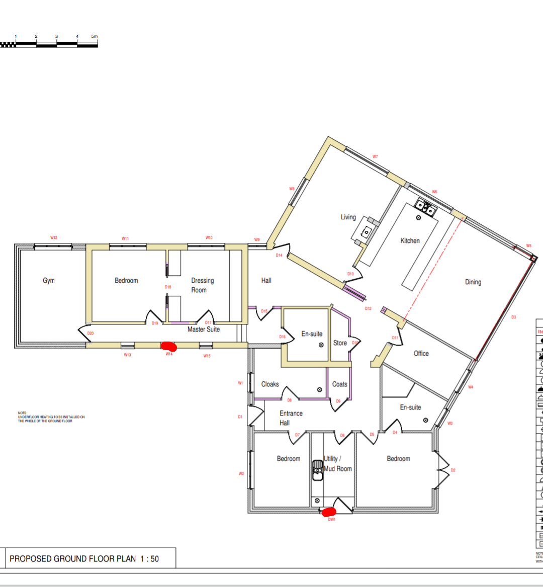

canalsiderenovation Posted March 11, 2020 Author Posted March 11, 2020 @AliG thanks. Yes one company had split up those windows into three which is a definite no according to the OH. Internorm had split them into two. There have been some minor tweaks to our windows which are as follows and on the plans below. D2 Bedroom patio Door 1810*2100 D3 Large sliders on dining room 5555*2100 - ideally slim profile Windows - triple glazed, I've noted openings W1 Cloaks/Shower 915*1200 open W2 Bedroom Front 1810*1200 open W3 Bedroom Rear ensuite 915*1200 open W4 Office 1200*1050 open W5 Corner window 910*2100 fixed W6 Kitchen 2400*1050 fixed W7 Living 2400*1050 fixed W8 Living Rear 1500*1050 open W9 Tall Hall 916*2000 fixed W10 Dressing 1810*1200 open W11 Master Bedroom 1810*1200 open W12 Gym 1810*1200 open Landing (x 2 windows) 650*1050 fixed The windows facing the canal and that are next to one another W10, W11, W12 (see plan) I think are the ones which will have weight issues so I think we would have to split these up into two (not three). As w6 and w7 are on the same stretch I think we would have to do the same and also for w8 too as it's in the same room as w8. I think the other windows could possibly be just single rather than split as they aren't on the same side so as long as they are consistent. The alternative is just reduce window sizes although we are working with the existing window sizes for these windows. @Russell griffithsggriffithsg yes I remember what you mention about inside colour for aluclad PVC which is another factor too but we are in battle about white or anthracite anyway. I think white will look sleeker, particularly if we end up with the thicker profile aluclad. Also if we end up with divisions in the middle I think white will be far better.
canalsiderenovation Posted March 11, 2020 Author Posted March 11, 2020 I'm trying to clarify with Ideal Combi what their maximum width is to allow the single pane openings. I've a feeling the following opening windows will need to be reduced if we opt for single pane openings. It's just how much they need to reduce in size..... W8 Living Rear 1500*1050 open W10 Dressing 1810*1200 open W11 Master Bedroom 1810*1200 open W12 Gym 1810*1200 open

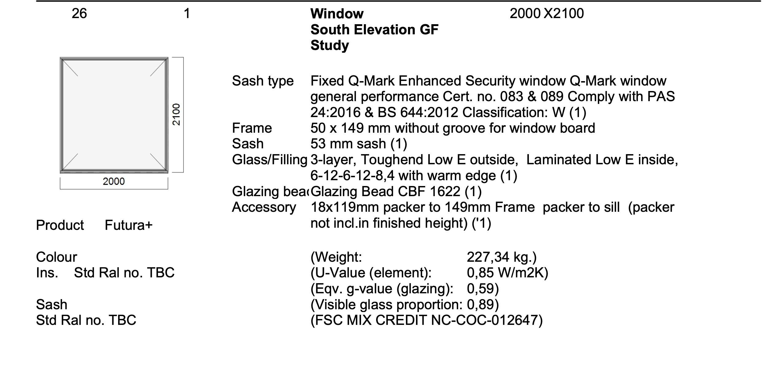

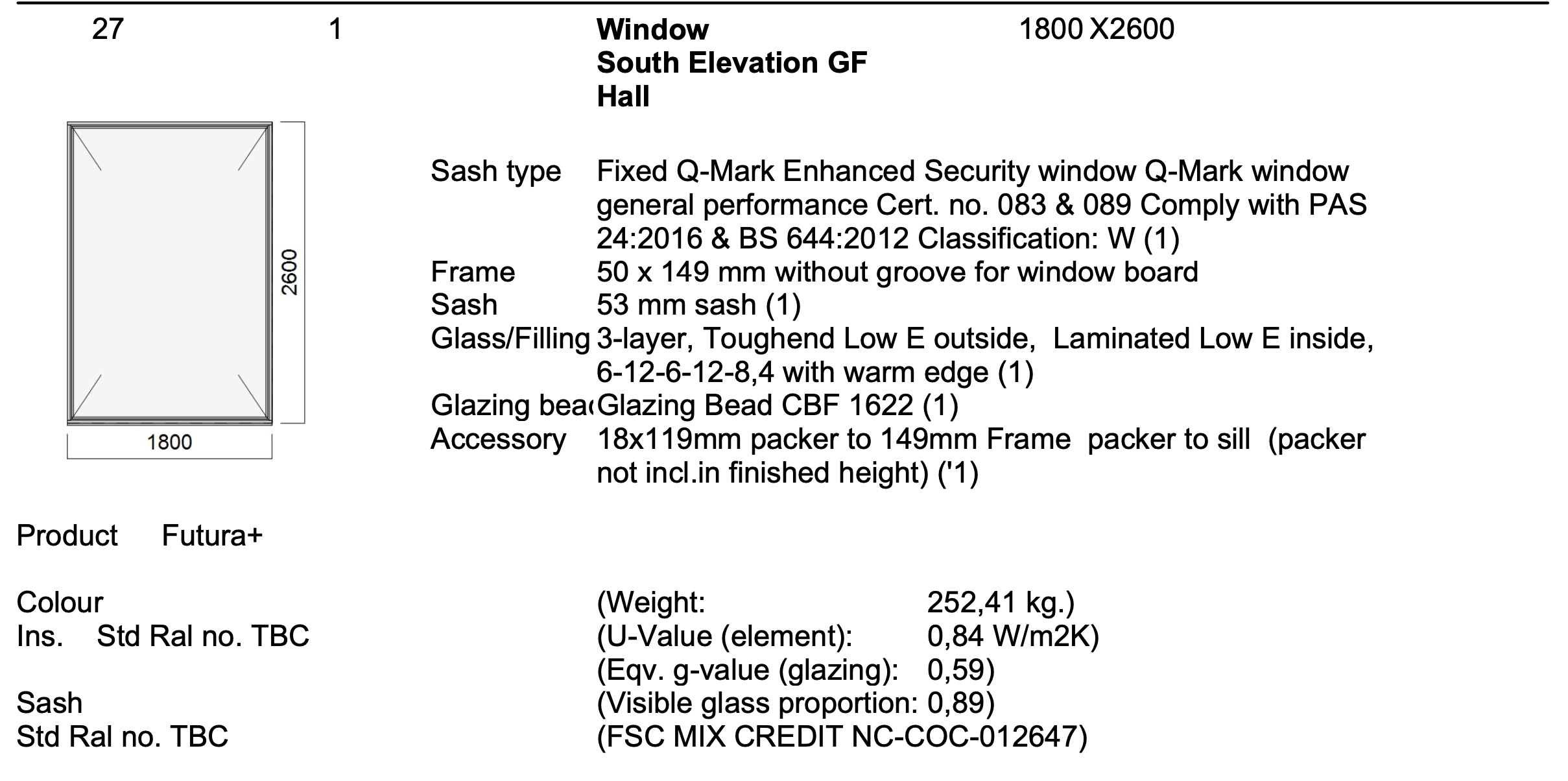

Thorfun Posted June 23, 2020 Posted June 23, 2020 On 11/03/2020 at 14:49, canalsiderenovation said: Ideal Combi have said the maximum single pane triple glazed is1600*1390 so we would need to adjust our three windows 1810 width *1200 to 1600mm. this is interesting as our windows include multiple of a larger size, including 2000x2100 single pane fixed windows and they've quoted for that size. we've also got a 1800x2600 and other large windows. the only thing it seems they can't do is large width sliding doors.

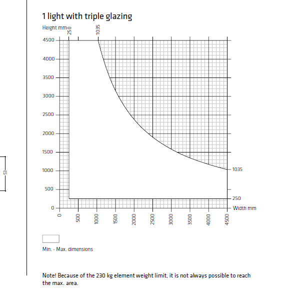

Mr Punter Posted June 23, 2020 Posted June 23, 2020 This is the size chart for the IdealCombi single light triple glazed Futura. Probably similar for Velfac and Rationel. You can get some mighty big windows from them. 1
Thorfun Posted June 23, 2020 Posted June 23, 2020 2 minutes ago, Mr Punter said: This is the size chart for the IdealCombi single light triple glazed Futura. Probably similar for Velfac and Rationel. You can get some mighty big windows from them. very useful, thanks @Mr Punter

Thorfun Posted June 23, 2020 Posted June 23, 2020 5 minutes ago, canalsiderenovation said: Strange I got different information. I've decided on Internorm now instead. we love the Internorm windows but at around 35% more expensive (not including the sliders as IC can't do the size we want) it's a hard decision to pay the extra! but we do love them. it might end up being one of those decisions where we pay the extra as I don't want to replace the windows ever so get it right first time. just another one of those decisions that need to be made at some point.
canalsiderenovation Posted June 23, 2020 Author Posted June 23, 2020 (edited) 2 hours ago, Thorfun said: we love the Internorm windows but at around 35% more expensive (not including the sliders as IC can't do the size we want) it's a hard decision to pay the extra! but we do love them. it might end up being one of those decisions where we pay the extra as I don't want to replace the windows ever so get it right first time. just another one of those decisions that need to be made at some point. There was less than £6k price difference for us and that included full fitting with Internorm (for their aluclad UPVC Studio product). As much as I want to save money it felt like the products were significantly better for the price difference. Edited June 23, 2020 by canalsiderenovation
Thorfun Posted June 23, 2020 Posted June 23, 2020 if it was that little a difference it'd be a no brainer. although I've not yet seen the idealcombi windows we could tell that the Internorm windows were just very solid and good quality. before Covid-19 hit we attended a build show and saw many manufacturers and still came away thinking Internorm felt the best. for us (we've got 42 windows which equate to 116m2 of glazing) the difference is about £15k. which buys a lot of other stuff! hence the dilemma. 1
