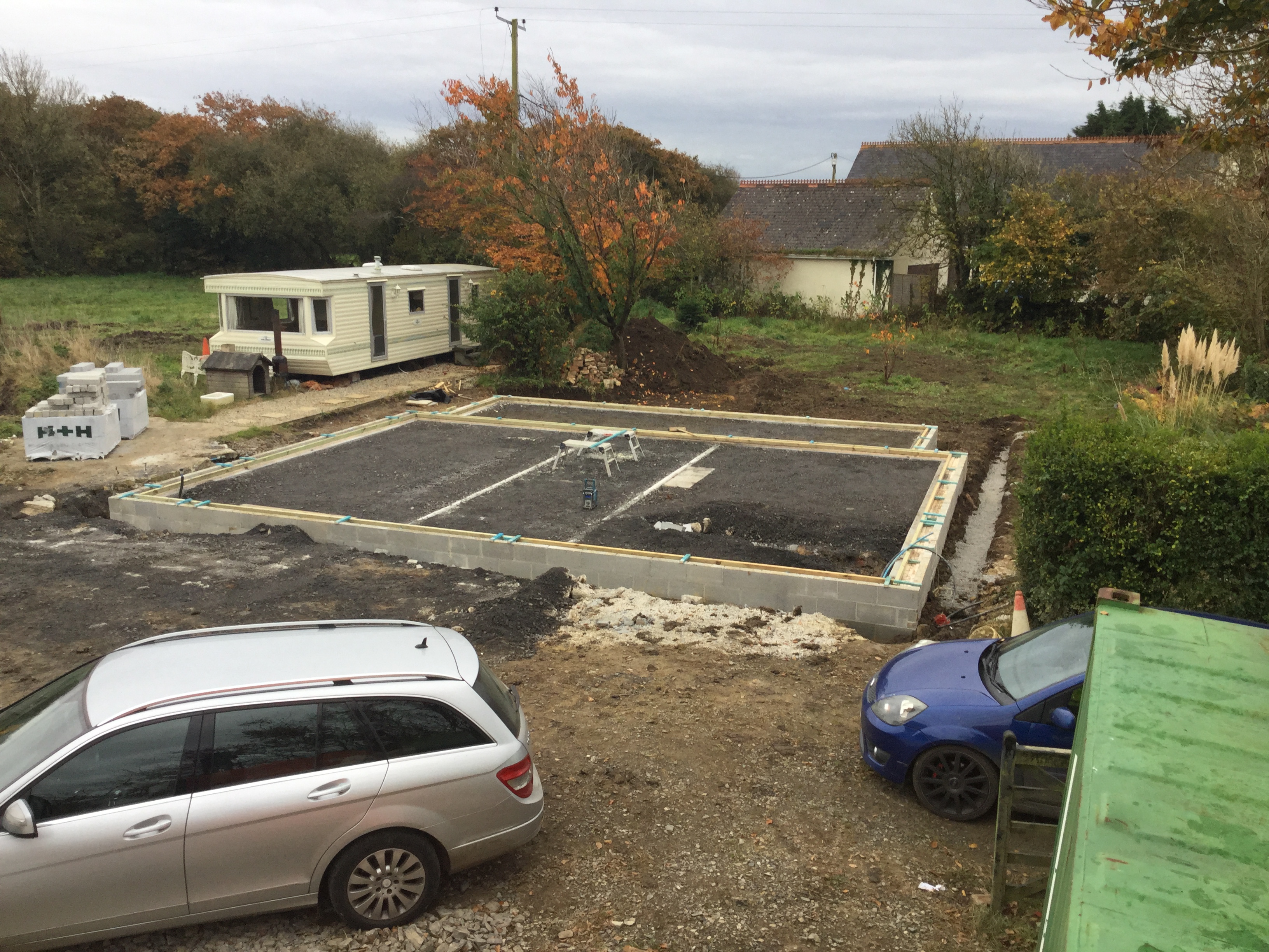

joe90 Posted November 21, 2016 Share Posted November 21, 2016 I will get the details and post for you, or anyone else to have a gander at, in the meantime here is a picture of our foundations in the site:- Link to comment Share on other sites More sharing options...
