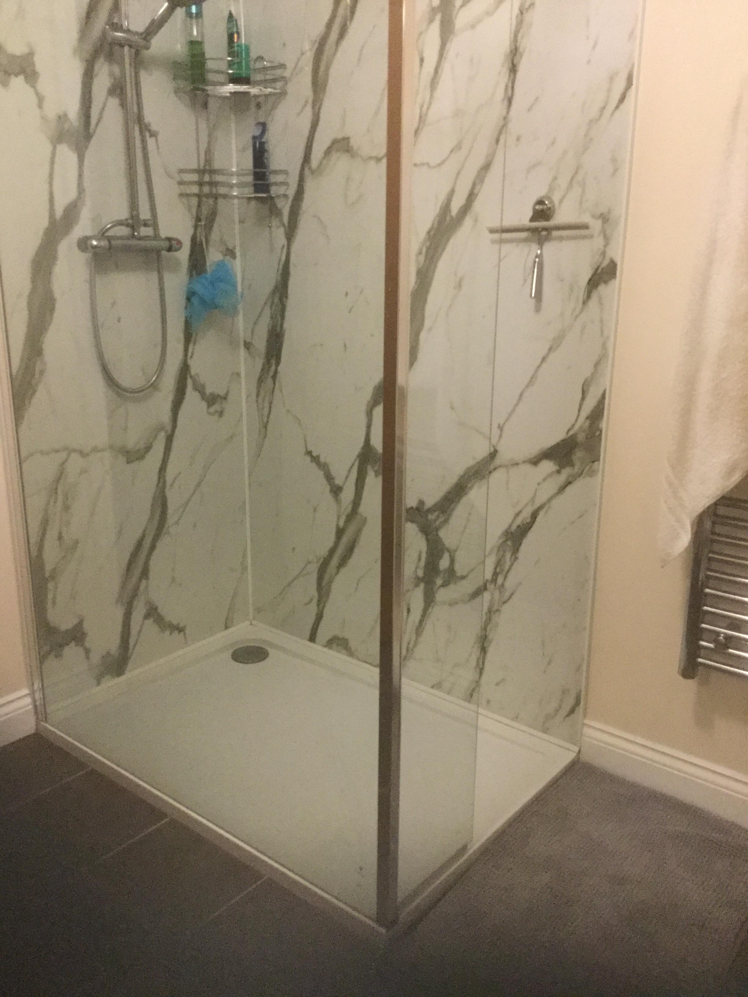

joe90 Posted February 28, 2020 Posted February 28, 2020 I have a couple of 1200 x 800 trays with 1200 glass panel and a 300 “flipper panel”. The flipper panel stops water tracking off the end of the1200 screen, with the tray being 1200 very little water gets out of the shower but enough room to step out of the water spray without leaving the enclosure . I think this works very well ( I don’t like wet rooms) 1

bassanclan Posted February 29, 2020 Posted February 29, 2020 The flipper shown in @joe90 photo allows easy entry at the end, but that isn't possible in your situation, you're losing part of your showering area.

Pocster Posted February 29, 2020 Author Posted February 29, 2020 25 minutes ago, bassanclan said: The flipper shown in @joe90 photo allows easy entry at the end, but that isn't possible in your situation, you're losing part of your showering area. Yeah I know ! Don’t know what’s best now ! 1
Pocster Posted February 29, 2020 Author Posted February 29, 2020 (edited) 36 minutes ago, bassanclan said: The flipper shown in @joe90 photo allows easy entry at the end, but that isn't possible in your situation, you're losing part of your showering area. Hmmmmm I could change to @joe90 setup . My entrance wouldn’t be at the wall though ( imagine reversing his entrance way ) - does that matter ?? Edited February 29, 2020 by pocster
