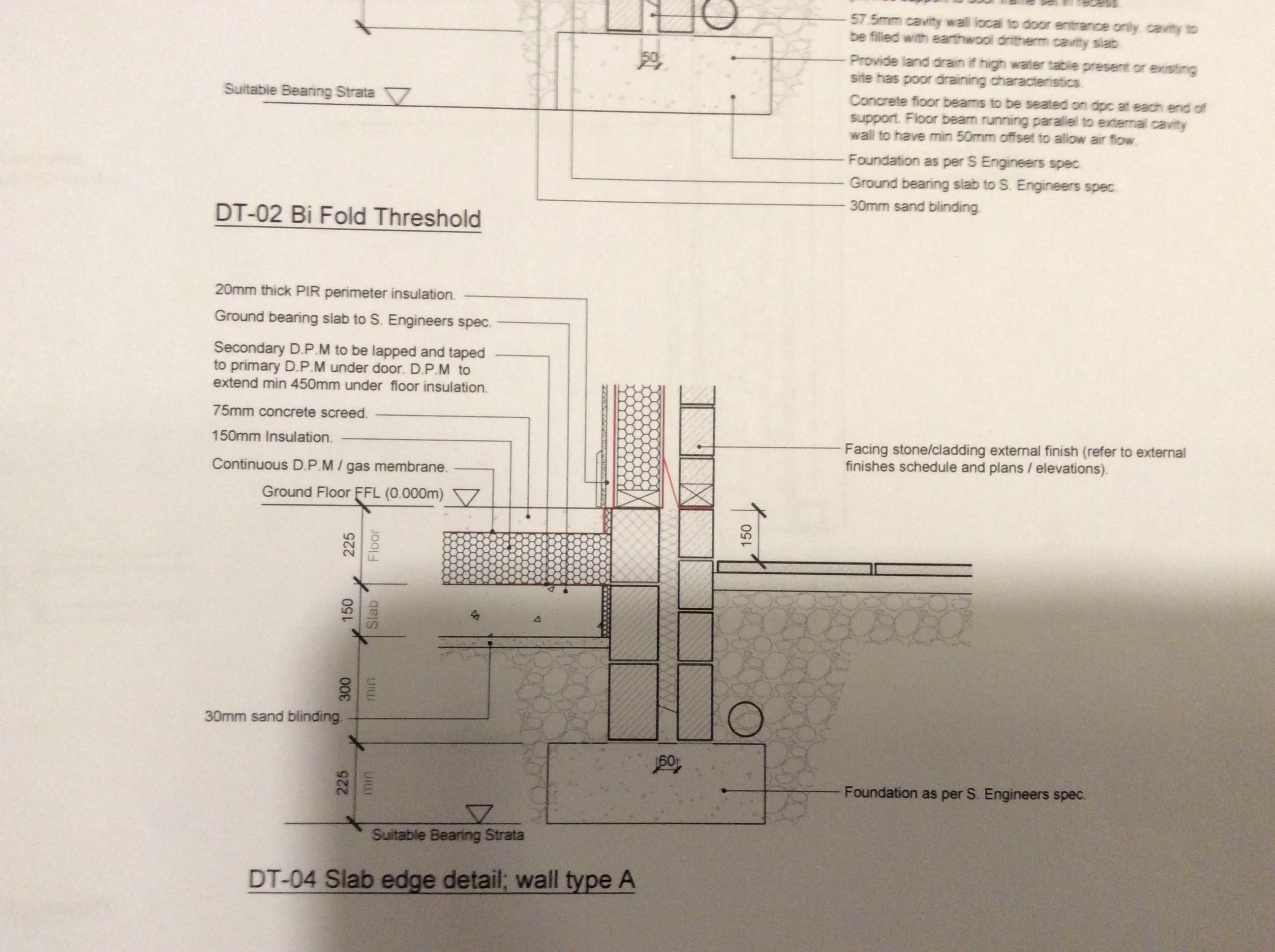

Taff Posted February 27, 2020 Posted February 27, 2020 Can someone have a quick look at the pic for the founds please just to make sure they are ok. I ain’t got a clue ? I’ve dug a hole to have a look under the soil and it’s solid clay at an estimate of 300 mm down ta
ProDave Posted February 27, 2020 Posted February 27, 2020 The clue is "Foundations as per S Engineers spec" You are expected to have a structural engineer look at the soil type, which will probably involve digging some test holes, and he will specify what is needed for your ground conditions.
MortarThePoint Posted February 27, 2020 Posted February 27, 2020 (edited) +1 for ProDave's response There are lots of factors to consider including nearby trees, future planting requirements, volume change potential of bearing strata and so on. Clay can be complicated by the fact that it can swell (heave) or contract (subside) depending on water levels and how thirsty nearby trees are (or were if cut down). I'm not trying to scare you, but I personally left that side of things to the pros with their experience and insurance. Edited February 27, 2020 by MortarThePoint
dnb Posted February 27, 2020 Posted February 27, 2020 There's clay and clay. I have clay soil and your design wouldn't work on my land at all. I had a couple of soil samples taken (by hand) and analysed by a friend. It cost a few pounds but confirmed what nearby house owners had told me - that I had highly shrinkable clay with signicant heave potential. And a lot of trees of course. I didn't bother with expensive bore holes (after all, the piling people would do this for me eventually ? ), instead I had the SE specify everything for the sensible worst case outcome based on what next door had done 2 years previously. Next stop piles and a lot of claymaster. (It was more cost effective than my other option of 2.6m deep strip) In the end, the pile design changed slightly because of a higher percentage chalk in the clay at 3 to 5 metre depth at one end of the site, but the cost of the change was less than the survey would have cost and I lost no time. Your clay might be much more forgiving of course - the clay back where I grew up only needed a metre or so depth of strip foundation. Talk to people who have built recently in the immediate area if possible so you can ask informed questions of the SE. Both my SE and BCO turned out to be quite knowledgable about the geology of the area around my house because it's a well studied ANOB and the SE did the pile design for my next but one neighbour. Building control and warranty people will all want to see a design that works else they will just say no.

joe90 Posted February 28, 2020 Posted February 28, 2020 I am on clay, didn’t use an SE, got the building inspector (local council) to look in a test hole and he just specified 700mm deep, I wanted 700mm wide for my wall make up. Simples, no expenditure .?

Taff Posted March 19, 2020 Author Posted March 19, 2020 Build control is a firm from Yorkshire, we are in Northumberland!! Don’t know how that works, however we are using a local engineer to test soils etc and plan the foundations, we are just awaiting the options, I’m just terrified that if it were pile then this could possibly blow our budget get ?
Mr Punter Posted March 19, 2020 Posted March 19, 2020 Discuss with your engineer. It could be fine with a strip footing. (S)he should be able to give ball park costs for the options.
MintSprint Posted March 19, 2020 Posted March 19, 2020 (edited) Approved Document A to the Building Regulations may be useful, if you're trying to do it without soil testing or the input of an Engineer. Pages 36 and 37... In the absence of testing to determine the MPI, depth will need to be to the satisfaction of the Building Control inspector, and they will certainly want to be below the level of any evident intrusion by tree roots. Edited March 19, 2020 by MintSprint
