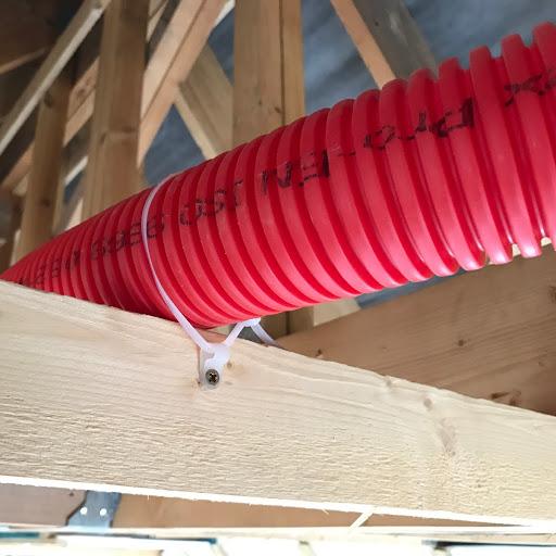

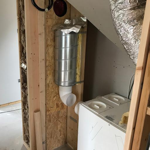

joe90 Posted February 24, 2020 Share Posted February 24, 2020 I have i joists and as long as the holes are in the right place (not near ends) it’s quite alright, mine is installed in a warm loft but an airing cupboard is ok, I suppose if it’s central in the house it would be better. I used the 75mm flexi duct, built my own manifold from ply and also made it a silencer I also made my own room vents from cheap bits. I located vents at opposite ends of the room to doors to create cross flow within those rooms. I have not balanced mine yet and have just installed a humidity stat to turn on boost based on RH. Link to comment Share on other sites More sharing options...
RandAbuild Posted February 24, 2020 Share Posted February 24, 2020 Easijoists are lot easier to thread the ducts through than I-Joists An MVHR unit can go in an airing cupboard if it's big enough. Try to locate it centrally in the house so the duct runs are kept short. Remember you will need a condensate drain We used BPC flexi duct. It's typically 75mm in diameter - these can be doubled up where required Rectangular ducts are available and can come insulated, but I think they are more expensive The general consensus is the supply ducts should go in the opposite end of the room to the entrance door (so a flow of fresh air is provided through the room), and extracts located centrally or close to (not immediately above) the main source of moisture The MVHR will be on permanently; there is usually a humidity control in the unit that provides a boost eg during showers. Our en-suite clears within about 5 minutes after a shower 1 Link to comment Share on other sites More sharing options...

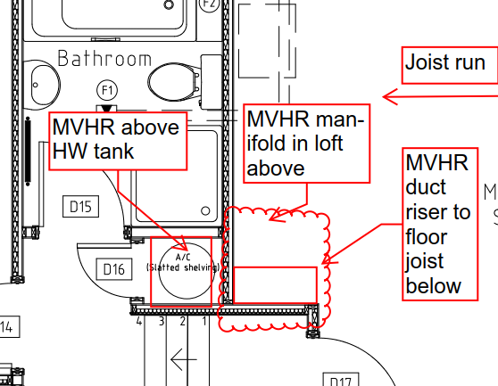

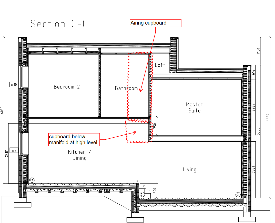

Moonshine Posted February 24, 2020 Author Share Posted February 24, 2020 Thanks both, especially those pictures. I have attached some very rough marked up drawings of the house plans which is where i think the duct runs may have to go, as well as the joist orientation. I am proposing that the airing cupboard is uses as this is on the first floor and has the smallest atmosphere supply and extract runs. I think that its going will be very tight to accommodate the MVHR and also manifolds. Any comments on the layout and better siting for things (note, there is a mini warm loft area above the master bedroom which could accommodate a manifold, and atmosphere supply and extract runs. floor plans - 200220 - MVHR.pdf Link to comment Share on other sites More sharing options...
Mr Punter Posted February 24, 2020 Share Posted February 24, 2020 I once sited a Vent Axia Sentinel Kinetic Plus in a small loft as per the specialist design. You needed to be a contortionist to clean the filters and I doubt the current owners will have ever done so. Link to comment Share on other sites More sharing options...
RandAbuild Posted February 24, 2020 Share Posted February 24, 2020 +1 on the filters - you need good access to these and the take out the heat exchanger to clean it. On the plans: I would do away with ducts to the basement - getting one down there would be more trouble than it's worth All duct runs on the ground floor and first floor have sections that run at right angles to the joists - try to minimise this where you can. The airing cupboard is well located but probably too small. Don't forget you'll have 10+ 75mm pipes that have to meet up in there. It will be like Clapham Junction on steroids If you locate the unit in a warm loft, you've still got to get all those pipes up to it. This might need the space of a HWC alone Don't get me wrong, I'm a strong advocate for MVHR as a cost-effective solution to controlled ventilation. But it need planning in now and you need to give up space to have it 1 Link to comment Share on other sites More sharing options...

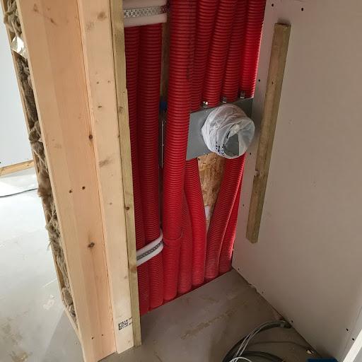

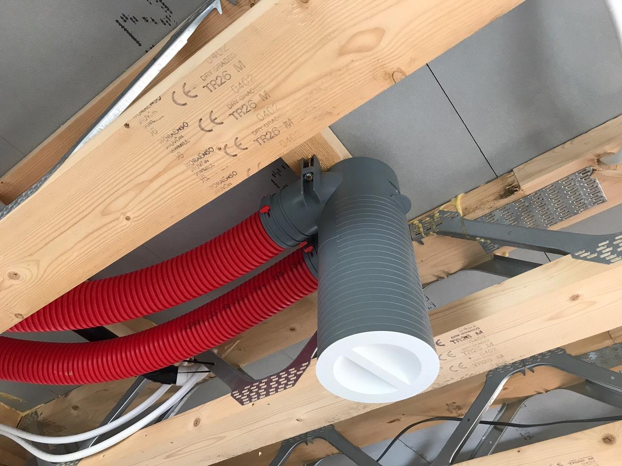

Mr Punter Posted February 24, 2020 Share Posted February 24, 2020 Here is the one they designed: The top floor had skeilings so the vents could not go in the corners. Timber frame designer unhelpfully put a strongback where it got in the way. This used 125mm rigid duct. I think the flexi stuff with the manifold boxes would be easier to do. 1 Link to comment Share on other sites More sharing options...
Moonshine Posted February 24, 2020 Author Share Posted February 24, 2020 37 minutes ago, RandAbuild said: But it need planning in now and you need to give up space to have it yep that is the stage i am now. The floor plans as they stand rely on a standard ventilation strategy, and i want to see how much compromise is needed if MVHR was used. Link to comment Share on other sites More sharing options...
Moonshine Posted February 24, 2020 Author Share Posted February 24, 2020 40 minutes ago, RandAbuild said: The airing cupboard is well located but probably too small. Don't forget you'll have 10+ 75mm pipes that have to meet up in there. It will be like Clapham Junction on steroids If you locate the unit in a warm loft, you've still got to get all those pipes up to it. This might need the space of a HWC alone I am thinking that maybe the MVHR unit can go in there, but the manifold (first floor) can go up in the mini loft as below, and the ground floor manifold would go in the cupboard below at high level, so that would only be two trunk large ducts going down before the octopus legs spread out. Link to comment Share on other sites More sharing options...

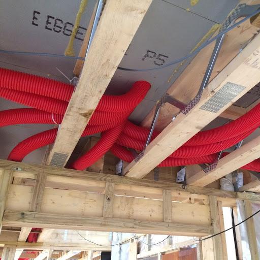

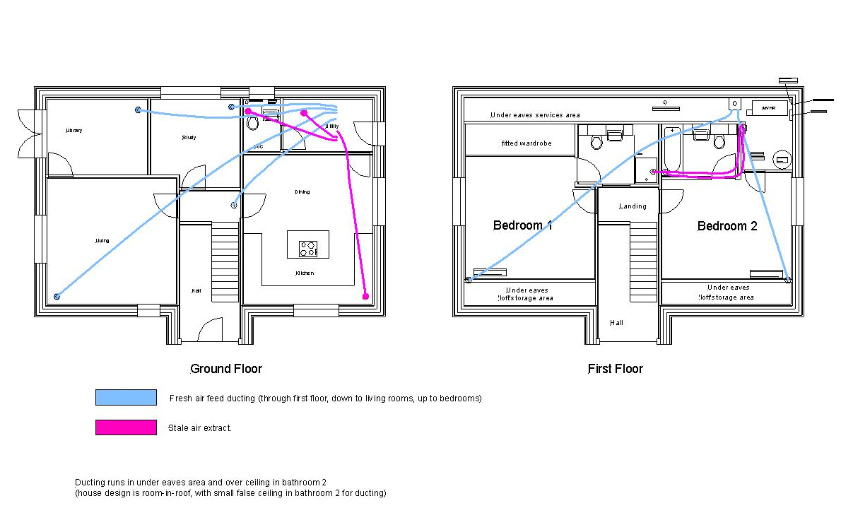

Jeremy Harris Posted February 24, 2020 Share Posted February 24, 2020 This is the way I ran ours: I ran almost all the ducts in the floor space between the ground and first floor, threaded through Easijoists. The bedroom fresh air terminals are wall mounted, as we have vaulted ceilings upstairs. The bathroom extract terminal ducts run above a false ceiling. I tried hard to ensure that the air paths were as long as practical, with no terminals in the centre of a room, as that can create "dead spots", where the ventilation air tends to short-circuit from the point of entry to the point of exhaust. Link to comment Share on other sites More sharing options...

RandAbuild Posted February 24, 2020 Share Posted February 24, 2020 18 minutes ago, Moonshine said: I am thinking that maybe the MVHR unit can go in there, but the manifold (first floor) can go up in the mini loft as below, and the ground floor manifold would go in the cupboard below at high level, so that would only be two trunk large ducts going down before the octopus legs spread out. That change of level would give me a few headaches, as the third dimension becomes more important. But I would have thought that using that cupboard / boxing-in at high level for the unit was possible if you had the headroom in the kitchen Link to comment Share on other sites More sharing options...
Russdl Posted February 24, 2020 Share Posted February 24, 2020 4 hours ago, Moonshine said: the manifold (first floor) can go up in the mini loft as below, and the ground floor manifold would go in the cupboard below at high level, Unless I’ve misunderstood you, that sounds to me as though you expect one manifold for each floor whereas each manifold serves both floors (extract from the kitchen/supply to the lounge. Extract from the bathroom, supply to the bedrooms) Link to comment Share on other sites More sharing options...

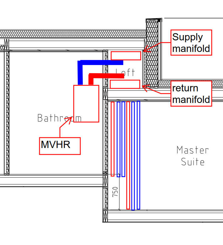

Moonshine Posted February 26, 2020 Author Share Posted February 26, 2020 On 24/02/2020 at 20:51, Russdl said: Unless I’ve misunderstood you, that sounds to me as though you expect one manifold for each floor whereas each manifold serves both floors (extract from the kitchen/supply to the lounge. Extract from the bathroom, supply to the bedrooms) I think that i have mis understood that part then, so its one manifold for return air, and one for supply. In that case i think that it could work by having the MVHR in the Airing cupboard, with ducting to the loft above to the side (see section C-C above), and both the manifolds in that loft space (may be tight! its 750mm x 800mm section), and then i put a boxed in riser in the master suite which will take a number (no. 5-6) 75mm flexi ducts down to the joists of the floor below for supply and return air Link to comment Share on other sites More sharing options...
Russdl Posted February 26, 2020 Share Posted February 26, 2020 @Moonshine It does sound like it'll be a bit tight. Where do you plan to route the inlet and exhaust for the MVHR? Straight up through the roof? It'll looks like it will definitely get a bit crowded up there. Link to comment Share on other sites More sharing options...

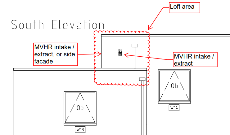

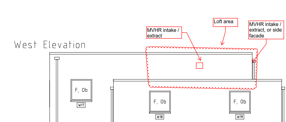

Moonshine Posted February 27, 2020 Author Share Posted February 27, 2020 9 hours ago, Russdl said: @Moonshine It does sound like it'll be a bit tight. Where do you plan to route the inlet and exhaust for the MVHR? Straight up through the roof? It'll looks like it will definitely get a bit crowded up there. tbh i want to minimise the amount of roof penetrations as its a flat roof and paranoid about leaks, my plan would be to take them out of the exterior walls of the loft area on separate facades as below. The Loft is looking as though it is going to be a MVHR duct area. Link to comment Share on other sites More sharing options...
Bitpipe Posted February 27, 2020 Share Posted February 27, 2020 You want to ensure your external vents are on the same wall face to minimise unbalancing when the wind is blowing. You also need to keep them about 1m apart to prevent the intake consuming the exhaust. 1 Link to comment Share on other sites More sharing options...
Russdl Posted February 27, 2020 Share Posted February 27, 2020 @Moonshine, as @Bitpipe says, you want them on the same elevation. Could they both go out of the west elevation above your master suite? 1 Link to comment Share on other sites More sharing options...
Moonshine Posted February 27, 2020 Author Share Posted February 27, 2020 16 minutes ago, Bitpipe said: You want to ensure your external vents are on the same wall face to minimise unbalancing when the wind is blowing. That is a new bit of information, thanks. I assumed best to be on separate facades to stop mixing, looks like they can be both on the west elevation with a decent (> 1m) elevation. Link to comment Share on other sites More sharing options...
Moonshine Posted February 27, 2020 Author Share Posted February 27, 2020 8 minutes ago, Russdl said: Could they both go out of the west elevation above your master suite? absolutely Link to comment Share on other sites More sharing options...
Bitpipe Posted February 27, 2020 Share Posted February 27, 2020 Even when MVHR is on full boost, the combined external airflow is quite modest so risk of mixing is low if that minimal separation is maintained. Link to comment Share on other sites More sharing options...

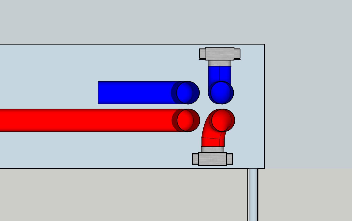

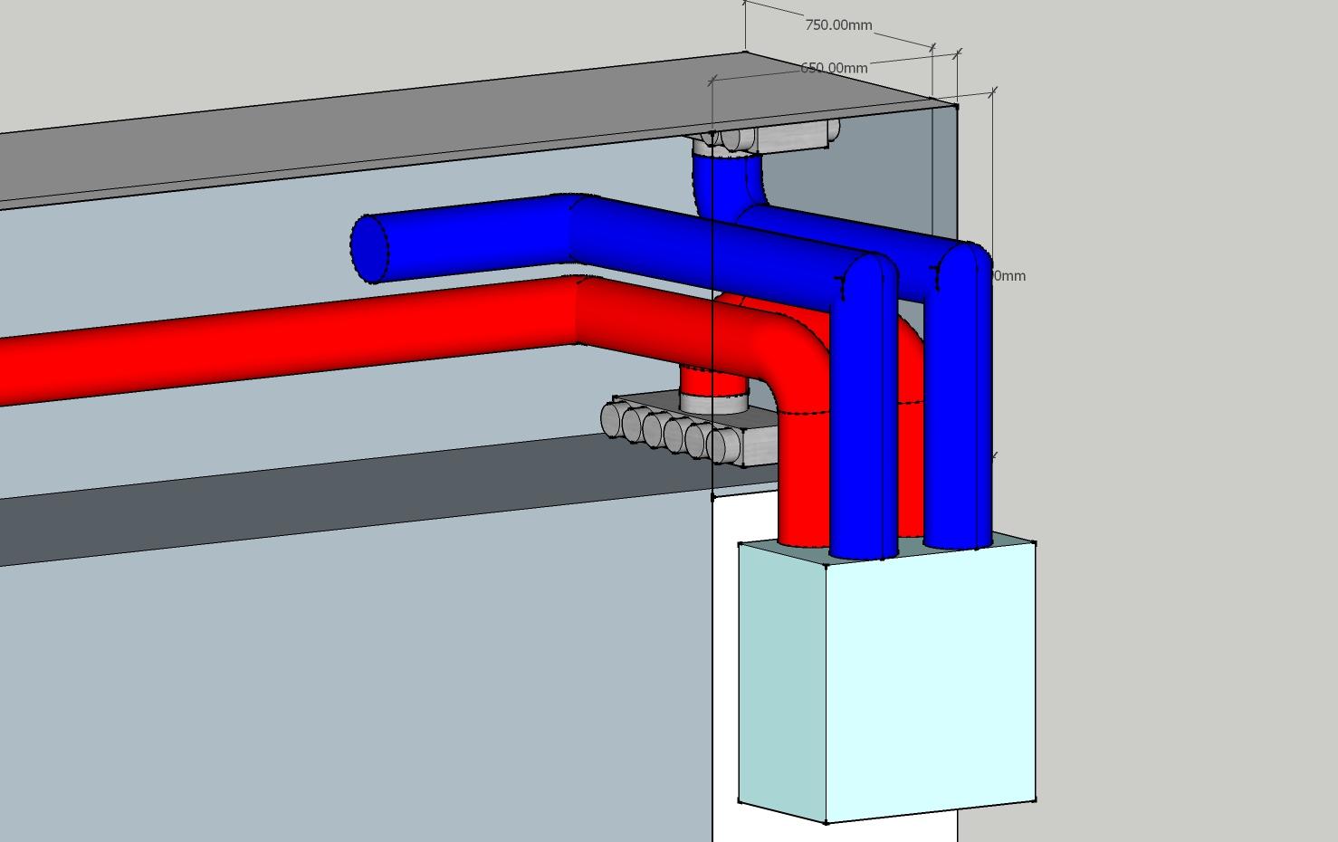

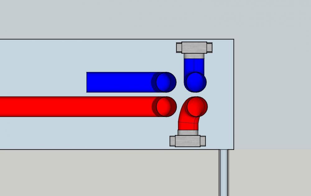

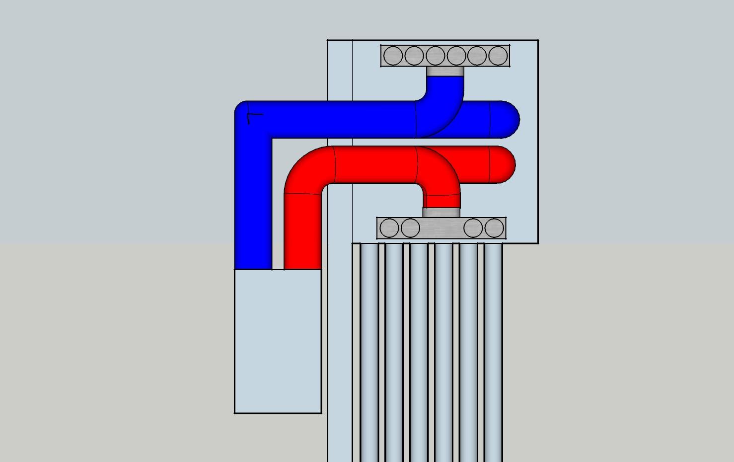

Moonshine Posted February 27, 2020 Author Share Posted February 27, 2020 I have been giving this a bit more thought and have sketchup'd the following arrangement in 3D, with the MVHR in the airing cupboard, and ducts running down a riser It seems that it works (Just!), with the return manifold on the floor, and the supply manifold on the the ceiling, as below Section through loft (short section) Long section through loft 1 Link to comment Share on other sites More sharing options...
