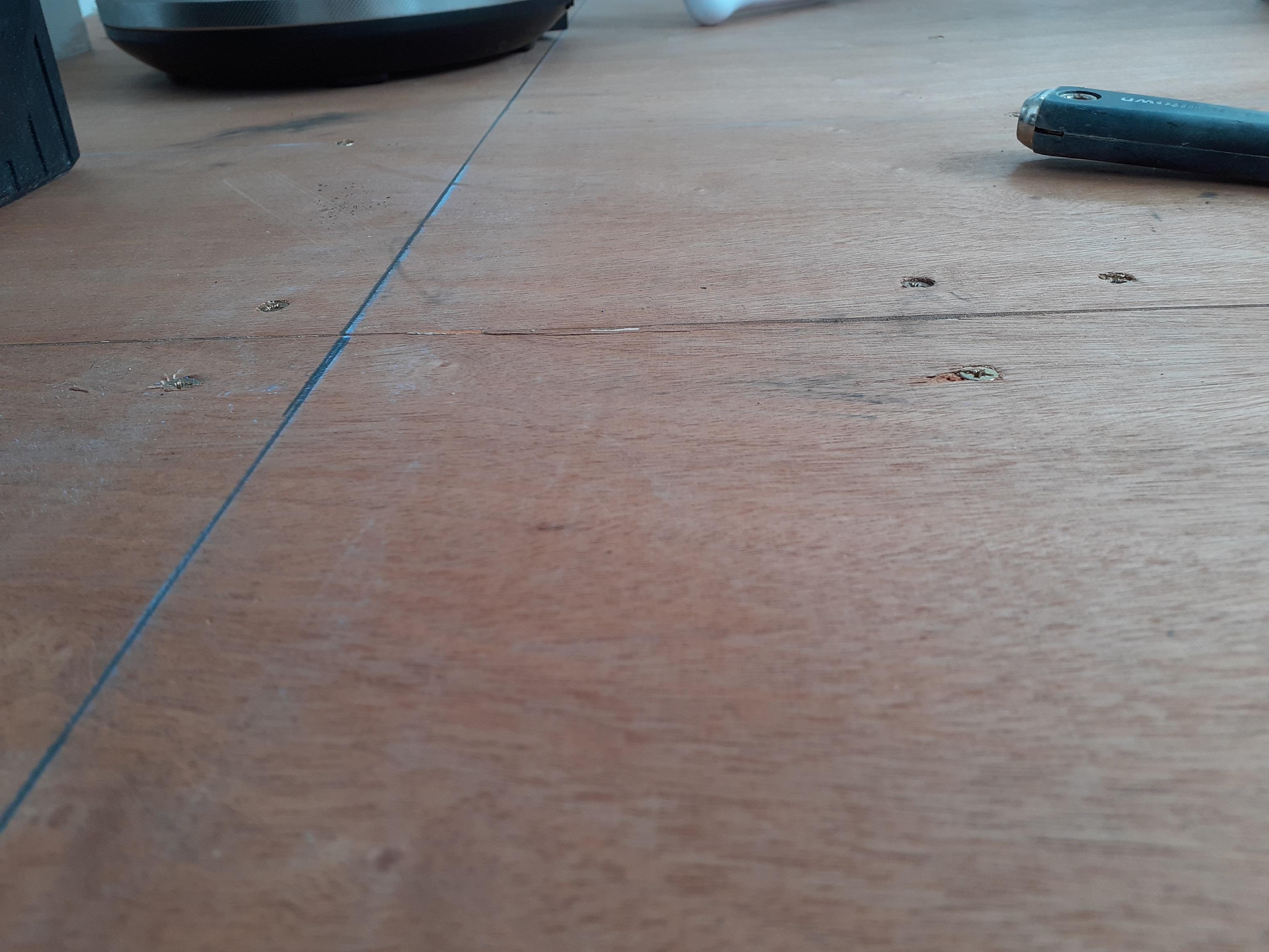

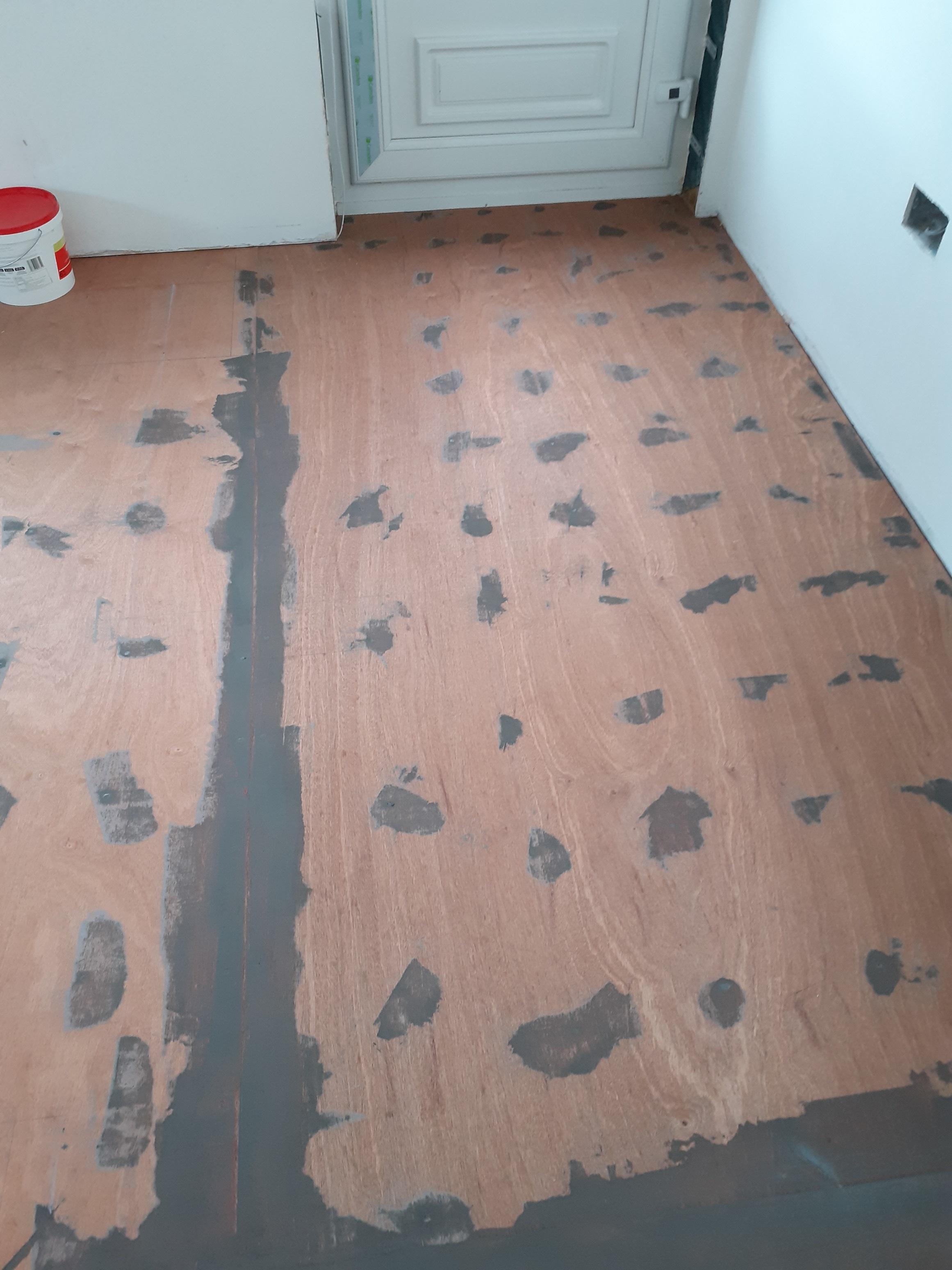

Carrerahill Posted March 16, 2020 Author Share Posted March 16, 2020 (edited) OK - I made a start. 12mm Hardwood core external grade ply was finished last weekend. I screwed it down on a grid, 8x12" in the field and 6" on edges, this resulted in a very smooth level floor (floor deck was level anyway). I then used F-Ball Stopgap to fill the screw heads and also to feather a section of the ply that differed in height by about 0.5mm - as I had the stuff I ended up just feathering the whole joint, took the finest of skim and that's me happy it is damn flat and level and these variations and marks cannot telegraph up through the Amtico. I then snapped lines to work out where cabinets would be and the centre line, I was going to butt a piece up to either side of the centre line but after a little test layout I discovered I would be better centring a piece on the centre line as that would save me awkward slither cuts. I even sanded the F-Ball just to get it super smooth, I then vacuumed it all. Edited March 16, 2020 by Carrerahill Typo. 2 Link to comment Share on other sites More sharing options...

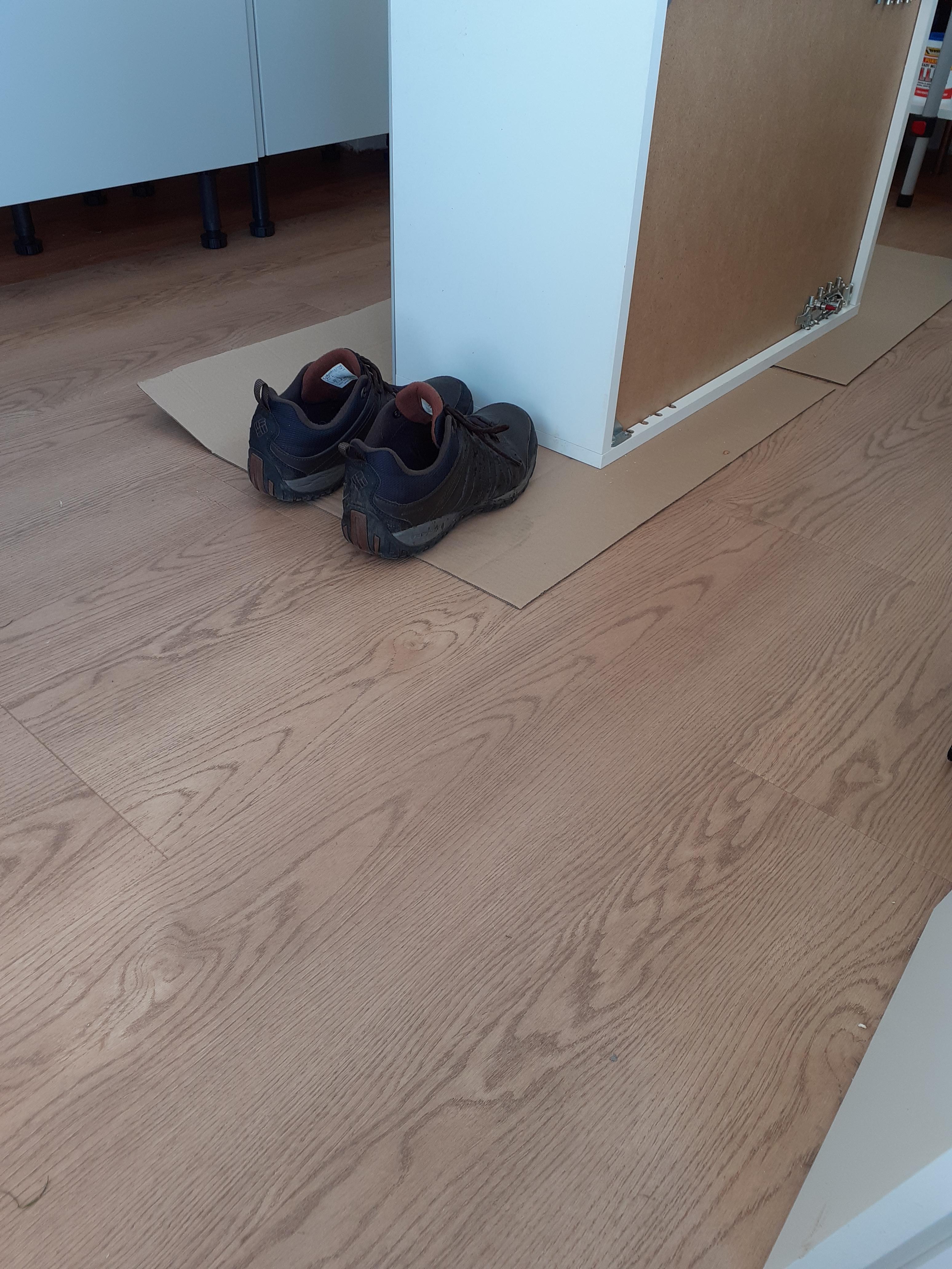

Carrerahill Posted March 23, 2020 Author Share Posted March 23, 2020 (edited) Well that is the Amtico part of the floor down, it looks great, I am very happy with it and considering it is my first DIY Amtico adventure I am quite pleased with myself. I now need to do the cheaper stuff around the perimeter which will be under the cabinets. I do have some photos but don't have the time to email them over and what not, I will soon. So in summary, Amtico is very much a DIY job unless you are going for a complex floor with motifs etc, where maybe I'd not want to risk it, although, if I had plenty spare lengths I might risk it... I would be happy to lay a border with what I now know. So, if you are thinking about it - go for it! I used Ardex Universal adhesive spread with an A2 notched trowel, I used a Marshaltown 4 inch jointing knife to scoop it out the tub and generally spread about the place before hitting the whole area with the notched trowel until I had 100% coverage but notched sized lines so there was room for it to squeeze out into the troughs and not so much adhesive the flooring just starts to slide about. I'd do it again in another room tomorrow, as with most jobs, the time is in the prep, the flooring actually goes down very fast and cuts very easily - if I was doing it again I'd setup a workbench with a "cutting station" on it. Edited March 23, 2020 by Carrerahill 3 Link to comment Share on other sites More sharing options...

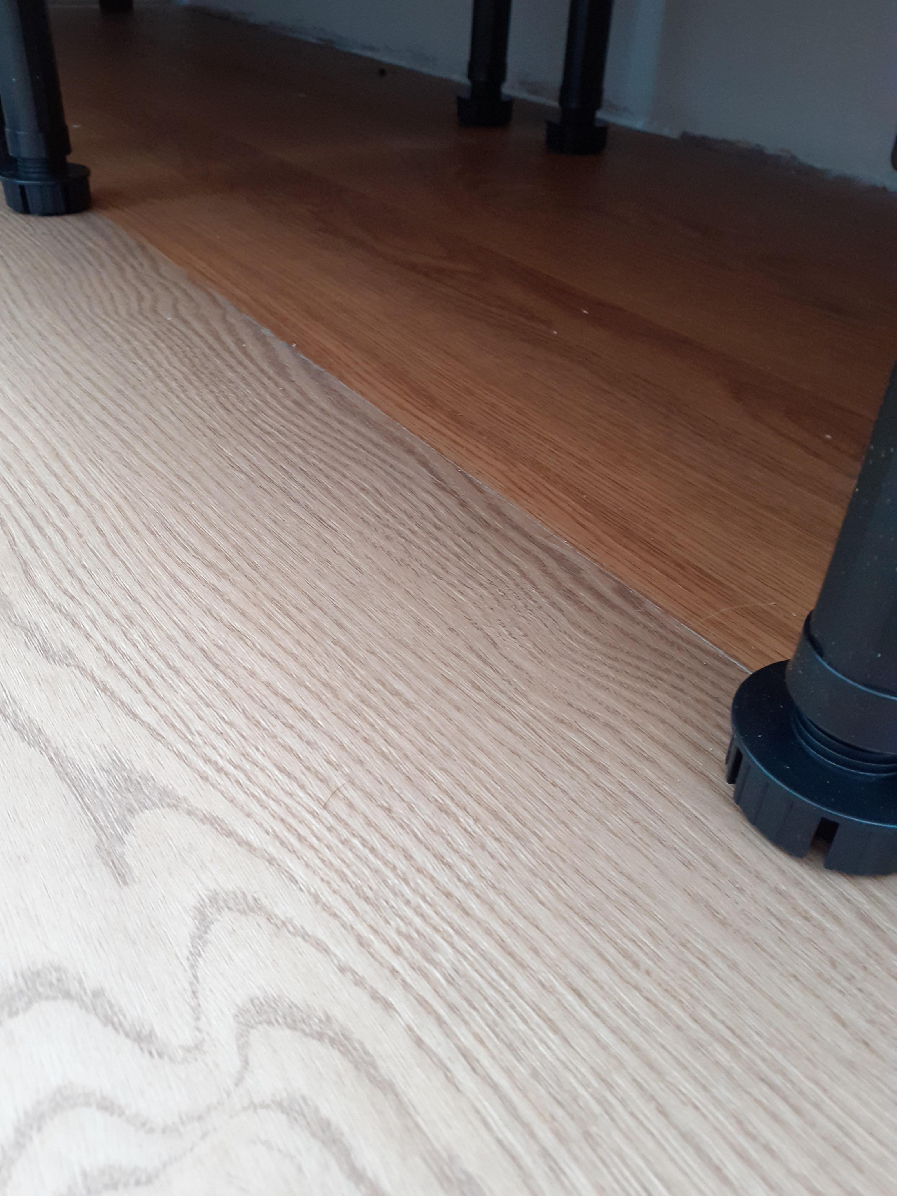

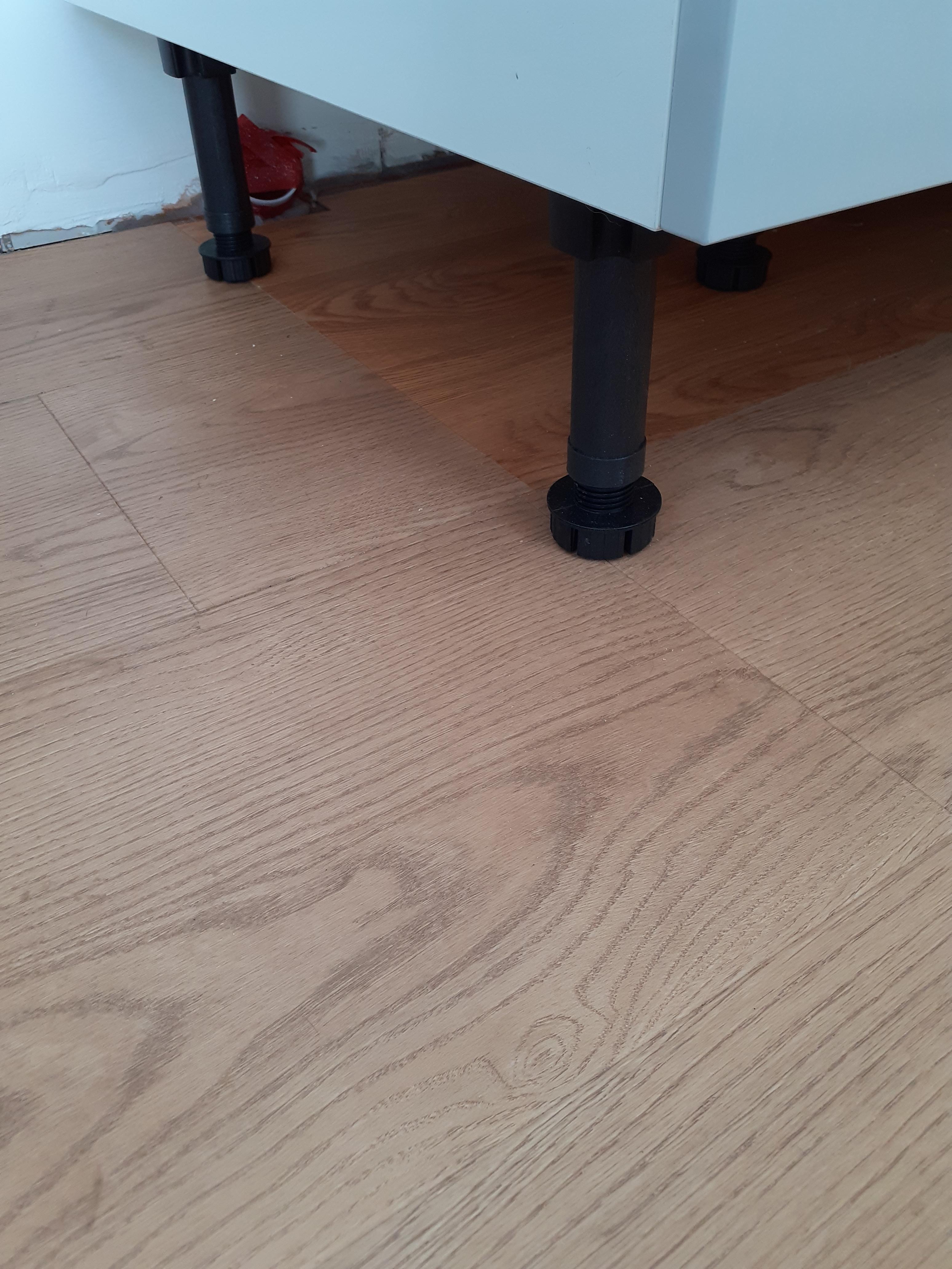

Carrerahill Posted April 20, 2020 Author Share Posted April 20, 2020 @SuperJohnG thanks for the reminder, sort of forgot about this post. Here are some photos, you can see where I went from the Amtico to the Vusta stuff for under cabinets, I am glad that I did it this way. 1 Link to comment Share on other sites More sharing options...
SuperJohnG Posted April 20, 2020 Share Posted April 20, 2020 @Carrerahill thanks, and looks a good transition. I'm just at the moment trying to price and see the cost vs benefits between Amtioc/ Tiles/ engineered wood. Link to comment Share on other sites More sharing options...
Carrerahill Posted April 20, 2020 Author Share Posted April 20, 2020 12 minutes ago, SuperJohnG said: @Carrerahill thanks, and looks a good transition. I'm just at the moment trying to price and see the cost vs benefits between Amtioc/ Tiles/ engineered wood. I'd say for me as it going into a kitchen it was going to be Amtico or tiles, I went for Amtico as I felt confident, after research, DIYing it, I also have experience of living with Amtico flooring and thought it would be a good option as it is never as cold as tile and dropped glasses and plates stand a chance of survival, being able to do it DIY was a big factor too. Of course I know you can DIY tiles but I couldn't really be bothered with the hassle. I choose tradesmen very carefully and when it comes to letting them into my house the bar is raised even higher - I don't have any flooring contractors on my speed dial and the monkey I did phone for a quote put me off so badly that I didn't even try a second. My mind was made up right then and there that I was doing it myself. I opted for a fairly expensive Amtico product on the basis labour was free so I think in the end I got a better floor. Amtico installation difficultly is one of these myths spread by the installers themselves. If you really think about it, it is gluing bits of plastic to the floor! After 2 attempts I was even able to cut and bevel the edges for that clean lines you will see at the transition from Amtico to Vusta on the plank ends, this is the same skill required where doing Amtico with borders etc. 1 Link to comment Share on other sites More sharing options...

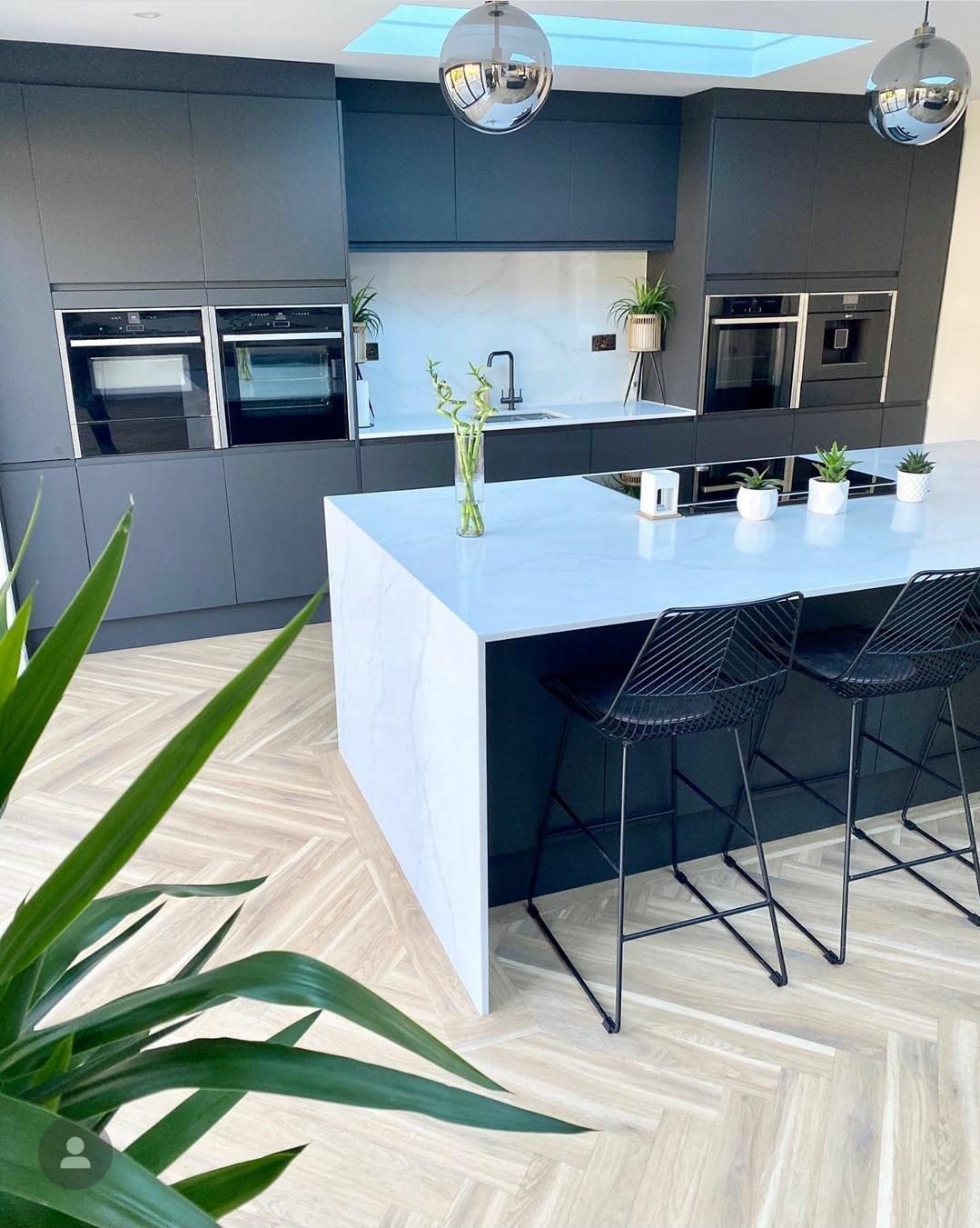

Carrerahill Posted April 21, 2020 Author Share Posted April 21, 2020 (edited) 17 hours ago, SuperJohnG said: Thanks @Carrerahill I think what drew me to it was it looks like tiles/ engineered wood but you can do these nice patterns but the joins are tiny? is that correct? see image attached, I believe this is eden oak. Yes correct, the pieces are made to very fine tolerances, when you push two pieces together the gap is very small, in essence there is no gap, just a joint line which if done well will be very tight. If you look at the above then you will note the herringbone layout abuts a border, so this will require good clean straight cuts. If you need to cut a plank/tile that abuts a border or something then you need to make a perfectly straight and square cut, I used a combination of a 6 inch speed square, a steel rule and a Stanley knife with a brand new blade. Where the joint is going to be on show, such as at a border, you then bevel the edge to factory edge finish (assuming your product has this) by literally shaving a tiny slither off the top edge of the wearing surface with a small, sharp plane. I didn't really need to do this as although I had cut edges of the Amtico abutting factory edges of the cheaper Vusta stuff I didn't care about the bevel, but I did do a couple just to try it. The joint is perfectly straight and tight (look at the top picture that shows an Amtico cut piece abutting a Vusta factory edge). I pinged a line down the middle of my kitchen and worked out my ideal layout to minimise waste, I then started from the middle of the room and laid 1 full piece, I then worked out how much I would need to cut off the last plank in that run and made that cut and started the second row with this off-cut (my cut line to the wall), I the worked out what size the last piece of the second row would be and made that cut and put that off-cut in as the third row. The result was 3 starter pieces down in a nice staggered arrangement. I then left that over night to set. The result was on day 2 I was able to crack on with the rest and really push the pieces together hard knowing that the first 3 pieces wouldn't move. If you have 2-3 pieces set up and you push the last piece in tight the whole lot will move slightly so you need to work to something solid to get tight joins. I could have fixed a square cornered batten to the floor and screwed that down and done one side of the room to that batten but I was in no hurry to hit it in one go. I wonder if the pro's use a batten or a couple of panel pins knocked in as "stops" for the first pieces. Edited April 21, 2020 by Carrerahill 2 Link to comment Share on other sites More sharing options...
