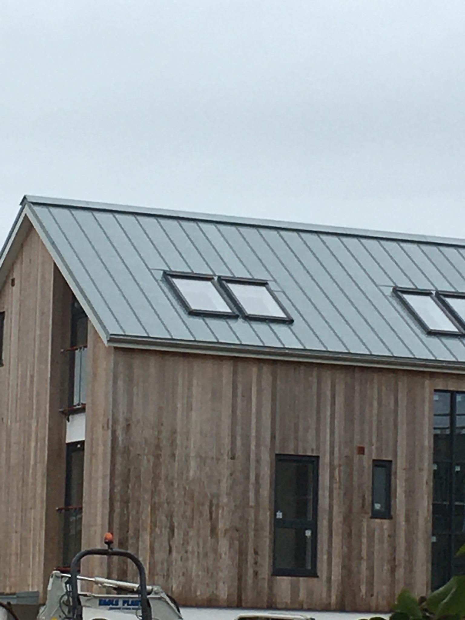

Russell griffiths Posted February 23, 2020 Share Posted February 23, 2020 (edited) I’ve noticed a few people doing metal roofs with roof windows, and noticed all having a bit of a nightmare trimming around the windows. Over the road from me they are building loads of new houses all with metal roofs i have been keeping a keen eye on them to look at details and thought would share it in case anybody needs ideas. The photos are rubbish as I took them on my phone from 200m away what they have basically done is above the windows they have turned a sheet 90degrees and run it sideways as a big wide flashing, the sheets above the windows are trimmed down onto this horizontal sheet, probably with a fold that tucks under to prevent wind uplift. Hope that makes sense, if I haven’t explained properly and your interested I will go around with a proper camera. Edited February 24, 2020 by Russell griffiths Bloody spell checker 1 Link to comment Share on other sites More sharing options...
Visti Posted February 23, 2020 Share Posted February 23, 2020 Good idea for standing seam roofs like these, though the fact the windows don't line up with the seams make me twitch a bit! Link to comment Share on other sites More sharing options...
Cpd Posted February 23, 2020 Share Posted February 23, 2020 I wonder how they seal the bottom as it looks like the roof sheet buts up to the bace of the window but there is no skirt / flashing ? Link to comment Share on other sites More sharing options...

Patrick Posted February 24, 2020 Share Posted February 24, 2020 2 hours ago, Cpd said: I wonder how they seal the bottom as it looks like the roof sheet buts up to the bace of the window but there is no skirt / flashing ? On the bottom, the sheets are tucked under the window flashing kit in this case. This can be easy or difficult (depending on the manufacturer) The top piece above the window is(should be) a made up flashing to fit the specific window. Same can be done on the bottom. Link to comment Share on other sites More sharing options...
Cpd Posted February 24, 2020 Share Posted February 24, 2020 6 hours ago, Patrick said: On the bottom, the sheets are tucked under the window flashing kit in this case. This can be easy or difficult (depending on the manufacturer) Ok so please humour me as I am interested...... how do you “tuck” the standing seam bit under the window flashing ? Thanks. Link to comment Share on other sites More sharing options...
Russell griffiths Posted February 24, 2020 Author Share Posted February 24, 2020 9 hours ago, Visti said: Good idea for standing seam roofs like these, though the fact the windows don't line up with the seams make me twitch a bit! The sheet size on some of the roofs have been altered to purposely not be near a seam. Tbh the work is spot on, for a new development the work is very very good but it should be, they are a lot of money. Link to comment Share on other sites More sharing options...
Patrick Posted February 24, 2020 Share Posted February 24, 2020 1 hour ago, Cpd said: Ok so please humour me as I am interested...... how do you “tuck” the standing seam bit under the window flashing ? Thanks. You flatten it.make it come up in a wave form. 1 Link to comment Share on other sites More sharing options...
