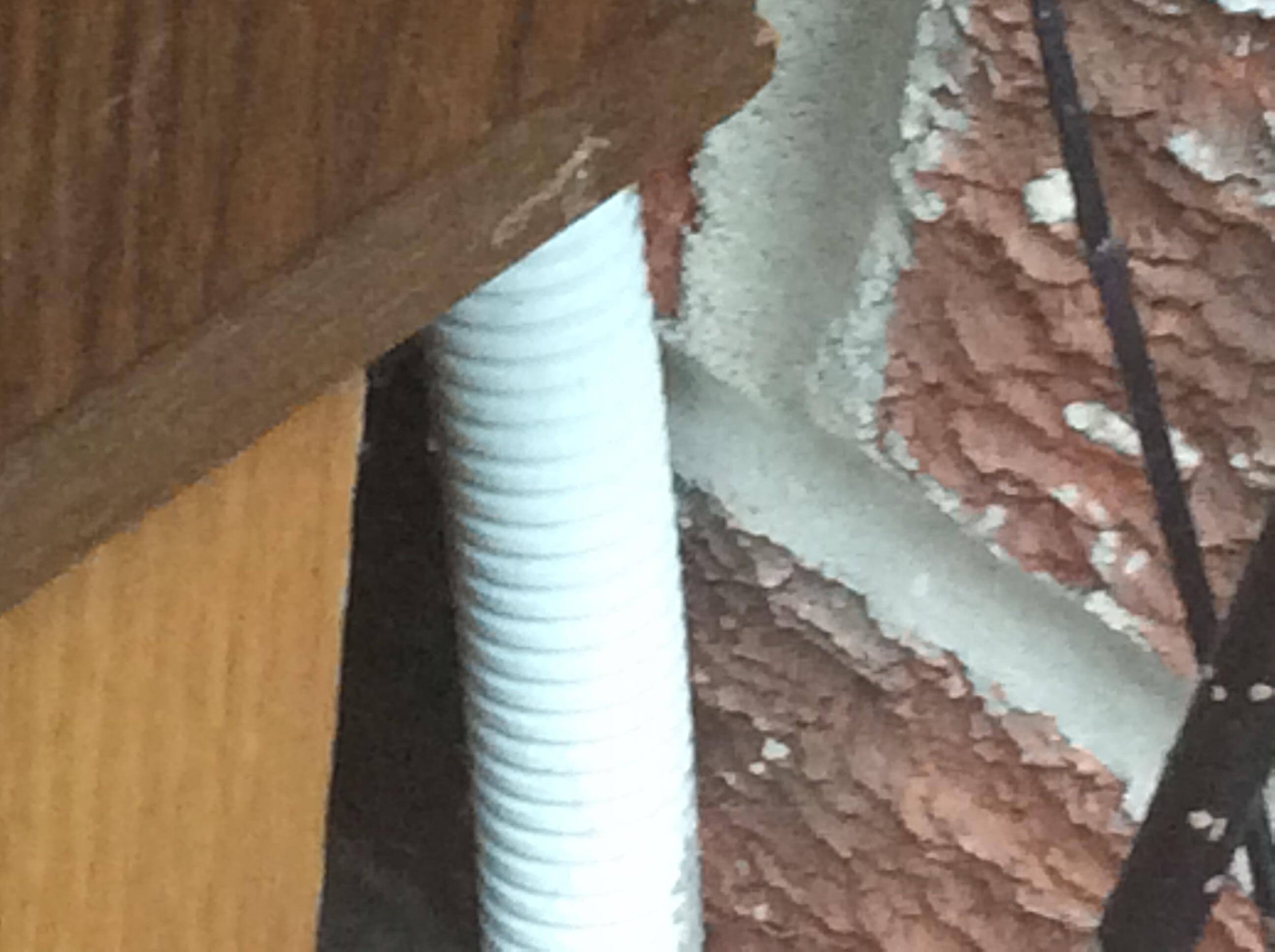

Ferdinand Posted February 23, 2020 Posted February 23, 2020 (edited) On 20/02/2020 at 15:24, MikeGrahamT21 said: not sure about taping to foam, doesn't seem like a reliable connection? OK, will consider running a couple of pipes through, seems like a decent solution. I suppose I should consider just running the pipes and cables bare as well, and taping them to the fabric, would be no different to when I did heating pipes a couple of years back and they were OK, maybe i'm over complicating things as usual! lol. I think its more the electrical wires which could do with being piped, and so I can pull new ones in if needed in future without disturbing everything. Do not run the, bare .. put conduits in. Am stuck with tiny cables in my kitchen floor because they did not conduit. This is the stuff I used for runs within my conservatory for electrics. About 20-25mm, flexible, inexpensive of whatever sort.and the foam should get a key on the ribs. If necessary use similar but larger as I think I did when provisioning for Virgin, with cords pre-installed. Edited February 23, 2020 by Ferdinand

MikeGrahamT21 Posted February 24, 2020 Author Posted February 24, 2020 On 23/02/2020 at 08:45, Ferdinand said: Do not run the, bare .. put conduits in. Am stuck with tiny cables in my kitchen floor because they did not conduit. This is the stuff I used for runs within my conservatory for electrics. About 20-25mm, flexible, inexpensive of whatever sort.and the foam should get a key on the ribs. If necessary use similar but larger as I think I did when provisioning for Virgin, with cords pre-installed. Yeah definitely going to run the cable through conduit, was just the pipes I was thinking of taping direct to the membrane.
