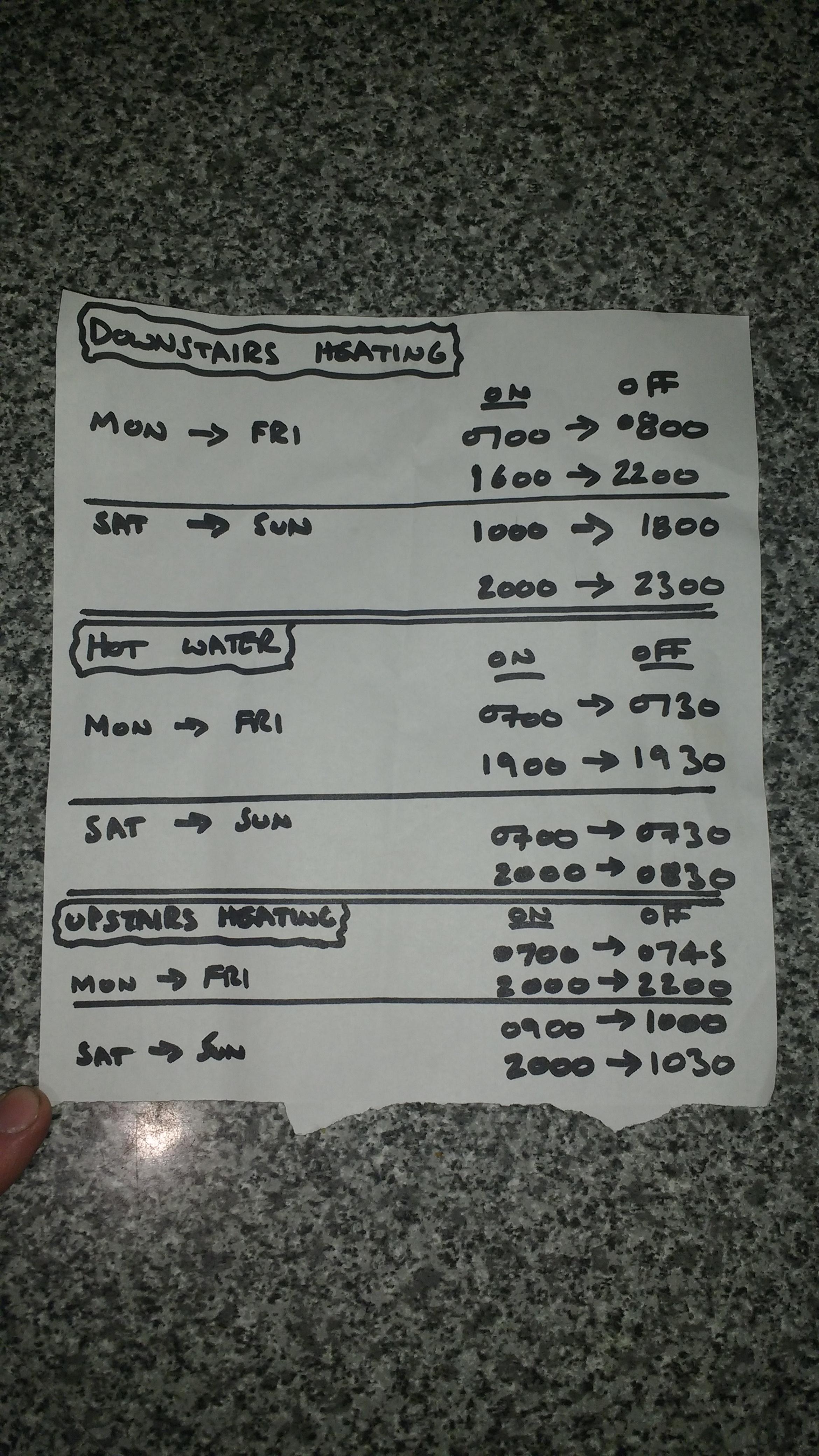

Onoff Posted February 28, 2021 Share Posted February 28, 2021 17 minutes ago, PeterW said: More likely a 130 litre cylinder as the insulation will be 35mm thick or so. Assume this is in the plan to replace ..? Is the heating set to W-Plan as I assume as it’s oil you keep the hot water on constant ..? The hot water is on timed. Basically this: I however added 2 2-port valves to zone upstairs and downstairs CH. Link to comment Share on other sites More sharing options...
PeterW Posted February 28, 2021 Share Posted February 28, 2021 Ok. What programme is the hot water on though ..? And is the 3 port over to water when it’s off ..?? Link to comment Share on other sites More sharing options...
Onoff Posted February 28, 2021 Share Posted February 28, 2021 13 minutes ago, PeterW said: Ok. What programme is the hot water on though ..? And is the 3 port over to water when it’s off ..?? Sorry, what do you mean what programme? Times? No idea on the second question. Link to comment Share on other sites More sharing options...
PeterW Posted February 28, 2021 Share Posted February 28, 2021 So when the hot water comes on, does the 3 way valve spin over to open or does it just heat the water ..?? With a HRC and small cylinder you may want to add a midday time slot to the programme. Would also say that if it can heat a tank in 30 mins then most likely it’s sub 150 litres. Link to comment Share on other sites More sharing options...
