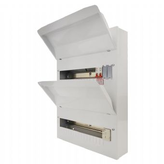

Posted
Double decker/stacked/duplex consumers units are OK, like this:
If you have the room, get the largest case size you can though, as it's always a lot easier to work on one where there's plenty of room.

Yeah I looked at this type of thing ; width was 40cm + ...

Bear in mind that you can have several outlets per radial, the limit is set by the total load per circuit (typically 20 A for a radial).  Most household loads are now pretty small, and the worst that can happen if you do overload a circuit is that it will trip, with no harm caused.
