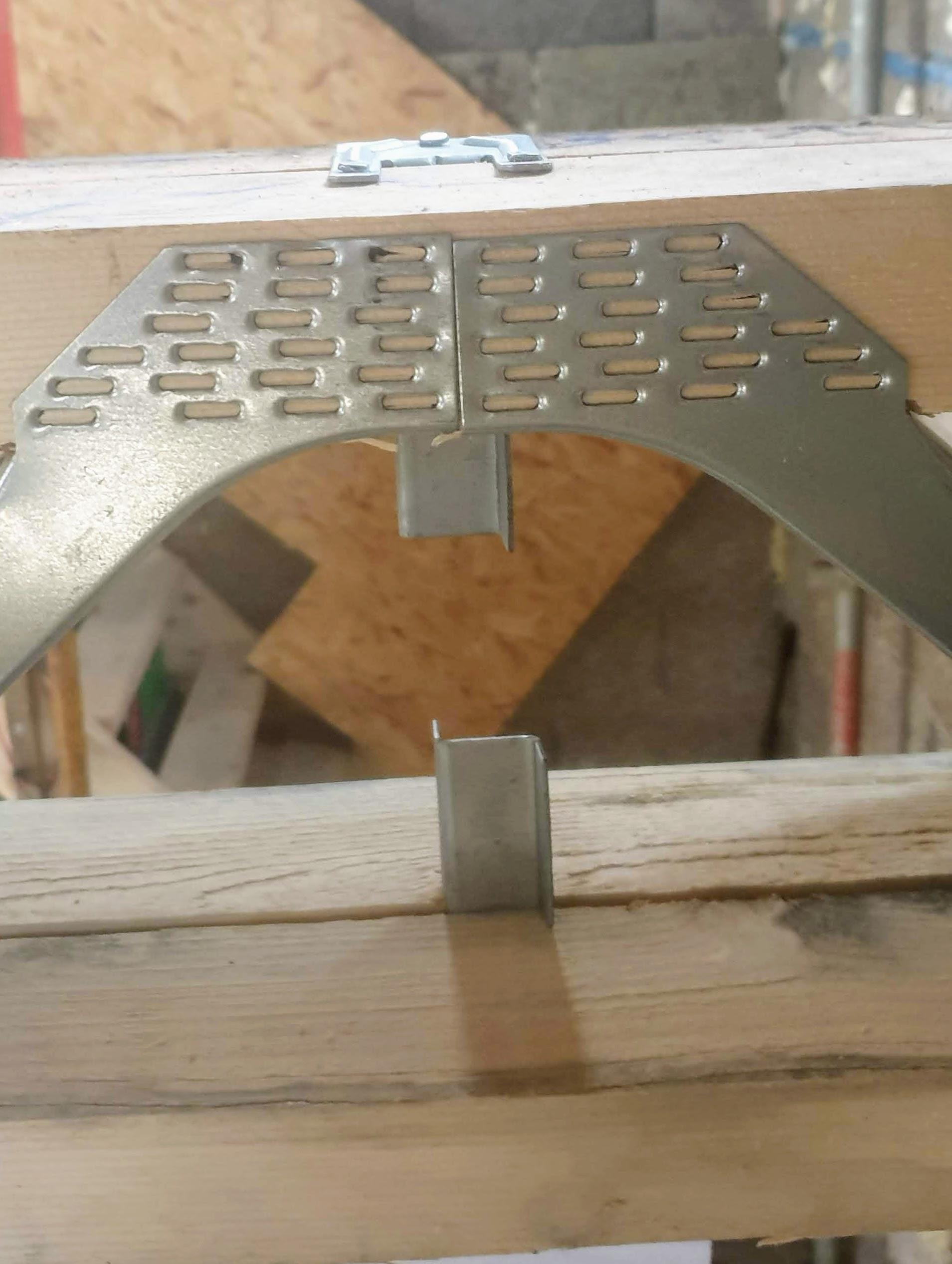

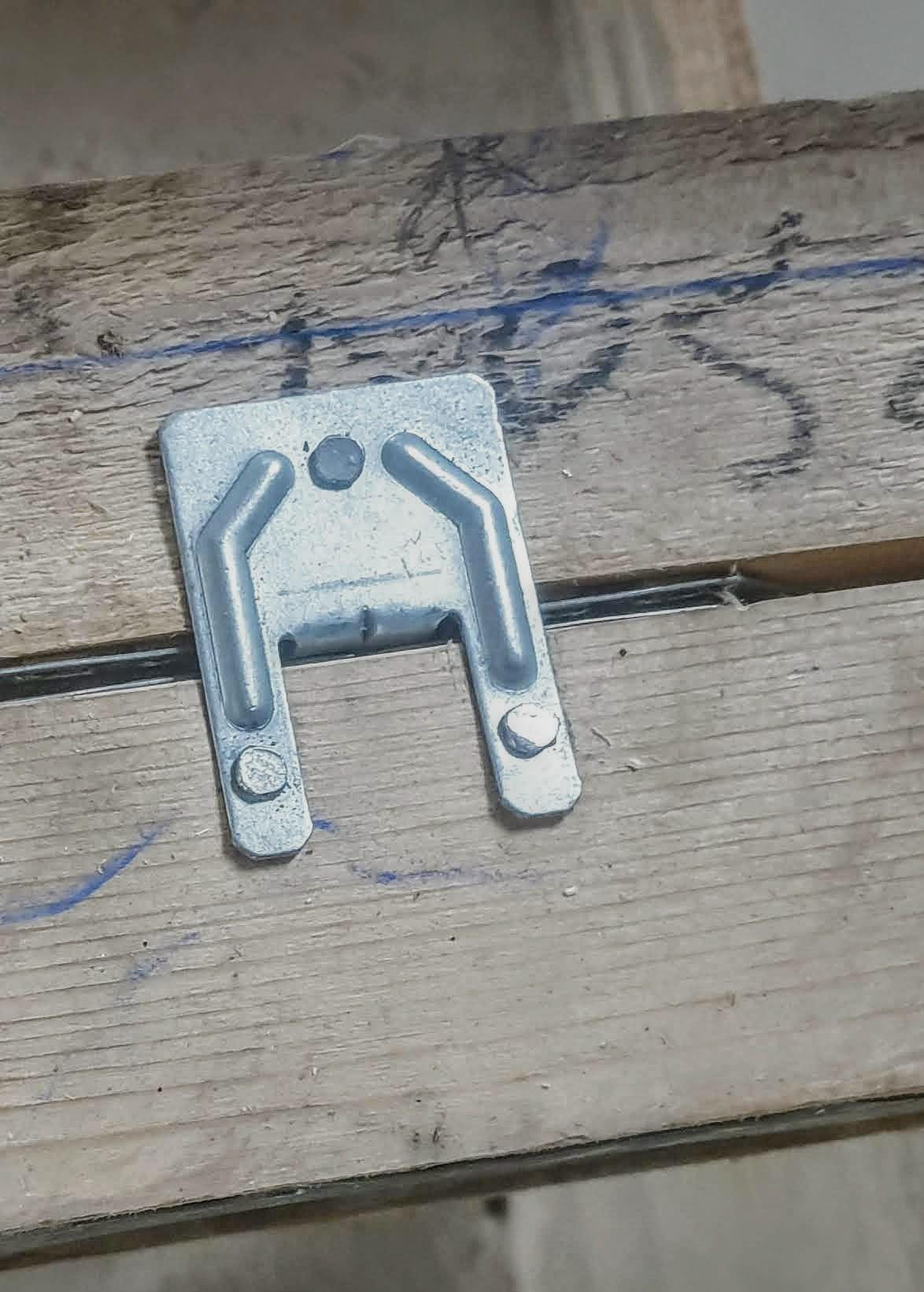

ToughButterCup Posted February 17, 2020 Share Posted February 17, 2020 31 minutes ago, Mr Punter said: Sometimes you have to double up or use a glulam or two. The 5.4 is a fair span. And that's how we got our mezannine .... doubled the POSIs using the clips provided Link to comment Share on other sites More sharing options...
