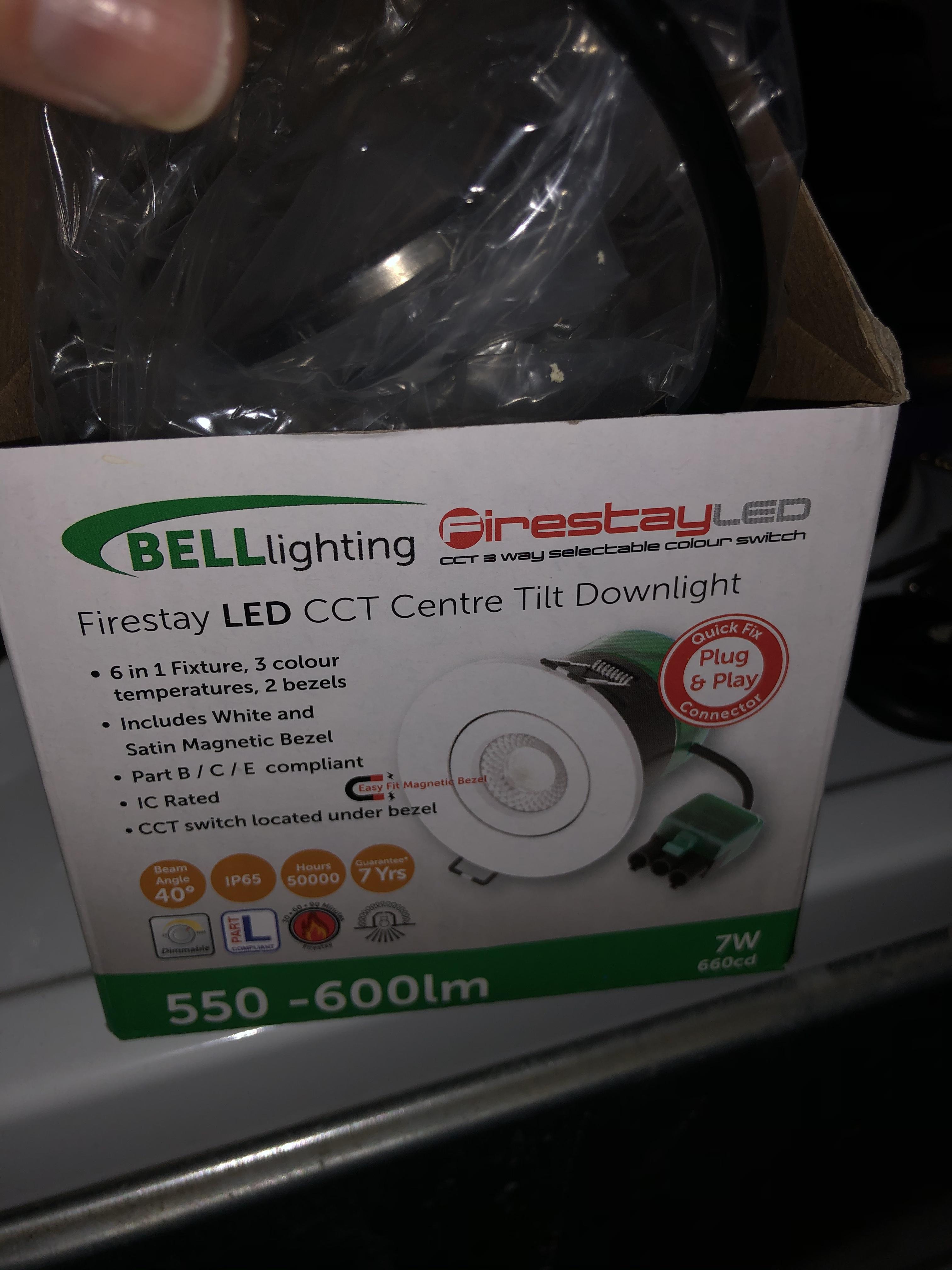

DC5 Posted February 14, 2020 Author Share Posted February 14, 2020 15 minutes ago, Ed Davies said: All a bit irrelevant as the OP said they wanted to use a non-IP-rated light, anyway. sorry maybe wasn't totally clear but will most likely need to use ip65+ but most of my first choice light fittings were ip44 or less so was just trying to clarify Link to comment Share on other sites More sharing options...
Pocster Posted February 15, 2020 Share Posted February 15, 2020 They seem good Link to comment Share on other sites More sharing options...
