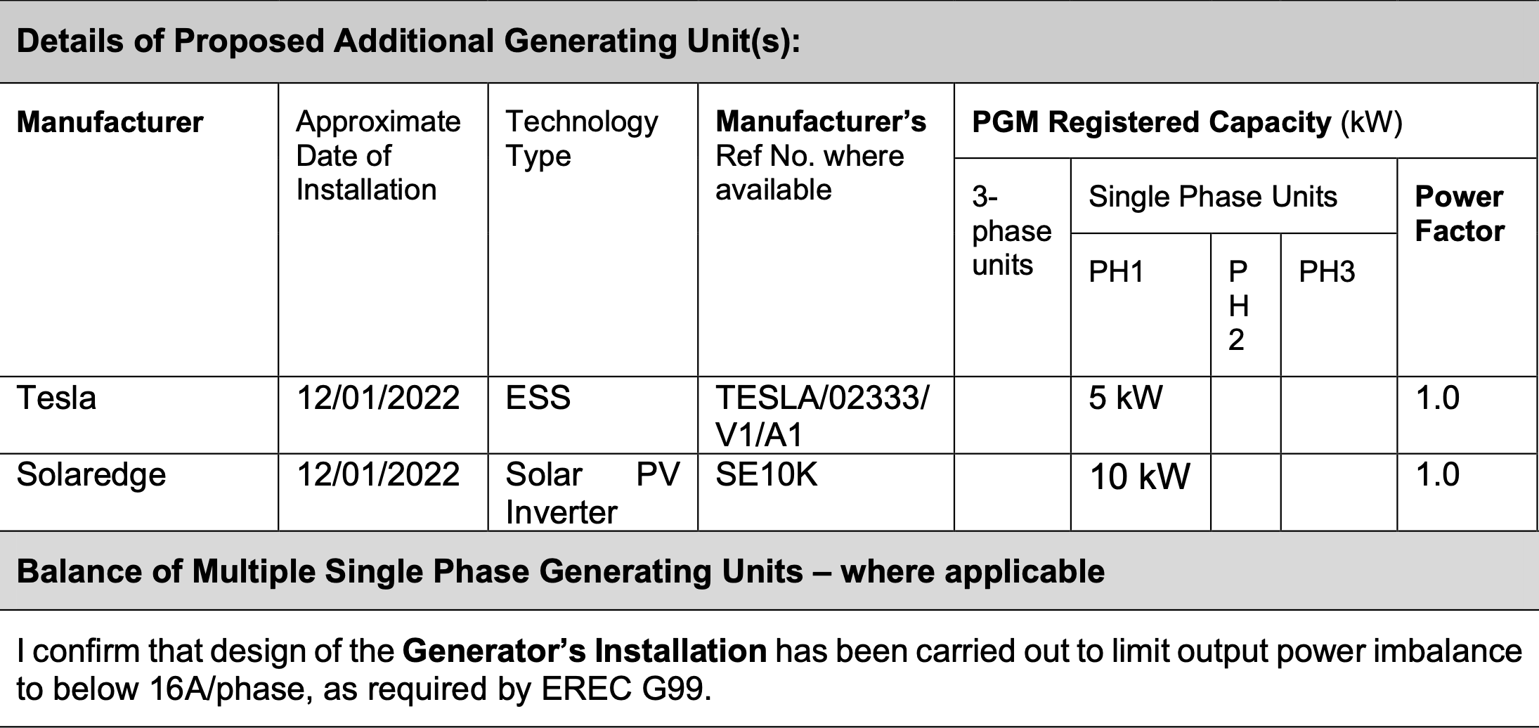

Thorfun Posted March 29, 2022 Author Share Posted March 29, 2022 on the subject of informing DNO....our G99 application that has been approved has this: if I'm not going for the PW2 any more but using another battery storage solution do I still need to inform the DNO? if so, is that a whole new G99 application? Link to comment Share on other sites More sharing options...
Pocster Posted March 29, 2022 Share Posted March 29, 2022 4 minutes ago, Thorfun said: on the subject of informing DNO....our G99 application that has been approved has this: if I'm not going for the PW2 any more but using another battery storage solution do I still need to inform the DNO? if so, is that a whole new G99 application? I would *just in case * - but as your storage is off the pv inverter they won’t care … Link to comment Share on other sites More sharing options...
Thorfun Posted March 29, 2022 Author Share Posted March 29, 2022 1 minute ago, pocster said: I would *just in case * - but as your storage is off the pv inverter they won’t care … a whole new G99 application though? I've never done one of those before. 🤔 Link to comment Share on other sites More sharing options...
Pocster Posted March 29, 2022 Share Posted March 29, 2022 (edited) 5 minutes ago, Thorfun said: a whole new G99 application though? I've never done one of those before. 🤔 Nor me I’d just ring the DNO and ask . In theory it shouldn’t matter as you are removing something rather than adding . But you know it could come back and bite you … Edited March 29, 2022 by pocster 1 Link to comment Share on other sites More sharing options...
Thorfun Posted March 29, 2022 Author Share Posted March 29, 2022 1 hour ago, pocster said: Nor me I’d just ring the DNO and ask . In theory it shouldn’t matter as you are removing something rather than adding . But you know it could come back and bite you … spoke to UKPN and they said new G99 application. guess I'll Google how to do that (after searching on here first of course. 😉 ) 1 Link to comment Share on other sites More sharing options...

Thorfun Posted March 29, 2022 Author Share Posted March 29, 2022 43 minutes ago, pocster said: Isn’t that all part of your installers job though ?? that's the thing isn't it. going to get my sparkie to install the battery system. Solar PV is already installed as per that G99 application. then the M&E consultants got taken over and are no longer doing batteries and so gave me a refund for the PW2 and dumped me to find someone else to do the work. that's what led me down this path! so I don't have an installer any more. 1 Link to comment Share on other sites More sharing options...
