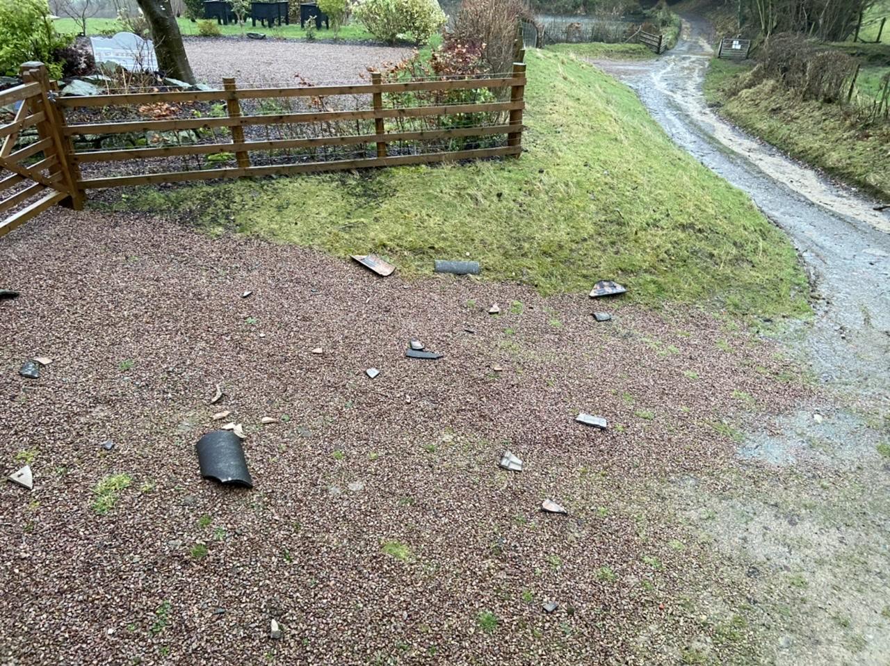

H F Posted February 10, 2020 Posted February 10, 2020 Storm Ciara decided it didn’t like our ridge tiles - to be fair, we don’t either. were going call the insurance company today. When we had our chimney redone, the roofers told us there was a new way of fitting ridge tiles where they were screwed down as opposed to cemented. Should we pursue this?
ProDave Posted February 10, 2020 Posted February 10, 2020 It's called a dry ridge system. You will have to strip the whole of the ridge and you may need to insert a length of timber if there is nothing suitable already to screw them down to.
Barney12 Posted February 10, 2020 Posted February 10, 2020 Some more info here: https://www.roofinglines.co.uk/blog/switching-to-a-dry-ridge-system Your insurer will likely only cover the cost of refixing/replacing damaged ridges. They may well cash settle which you could put towards the cost of renewing with a dry ridge. Just be careful that you are content that there is no other damage. Depending on your insurer they may try and “cash you out” from nothing more than a look at the roof from the ground.

H F Posted February 10, 2020 Author Posted February 10, 2020 8 minutes ago, Barney12 said: Some more info here: https://www.roofinglines.co.uk/blog/switching-to-a-dry-ridge-system Your insurer will likely only cover the cost of refixing/replacing damaged ridges. They may well cash settle which you could put towards the cost of renewing with a dry ridge. Just be careful that you are content that there is no other damage. Depending on your insurer they may try and “cash you out” from nothing more than a look at the roof from the ground. Thanks Barney. Some good advice there. We’re also getting some water ingress into the loft (not surprisingly). One would assume that since that portion of roof is 10m high, scaffolding will be required.

H F Posted February 11, 2020 Author Posted February 11, 2020 We spoke to our insurance company and it looks like we’ll be able to get our own contractors to do the work and they’ll reimburse us. It looks like odd roof tile was also cracked and damaged when the ridge tiles came tumbling down. Won’t be a ‘cheap job so worth claiming.
