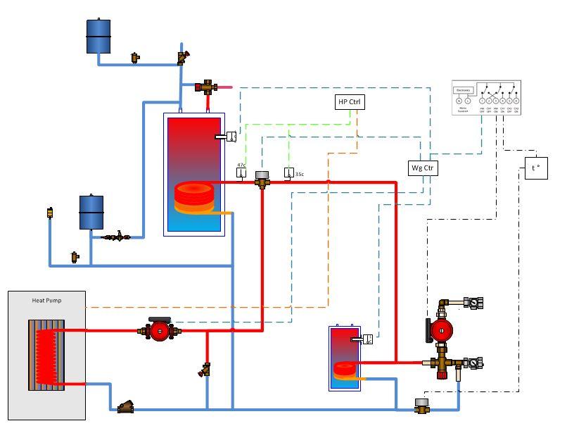

joe90 Posted February 2, 2020 Share Posted February 2, 2020 (edited) I found this diagram but one thing is wrong!,the UFH manifold in the bottom right corner should be fed from the tank, not the pipework from the internal coil. Hope this helps! Edited February 2, 2020 by joe90 Add pic Link to comment Share on other sites More sharing options...
Ed Davies Posted February 3, 2020 Share Posted February 3, 2020 11 hours ago, joe90 said: I found this diagram but one thing is wrong!,the UFH manifold in the bottom right corner should be fed from the tank, not the pipework from the internal coil. Hope this helps! Why? I'm not sure what the point of the coil is in this case, you could just as easily pipe directly into and out of the tank. I suppose it might save on inhibitor, though. More significantly, directly connecting the heat pump to the manifold allows immediate heat to the UFH when the system is starting from cold. Only when the demand from the UFH drops off would you then allow the HP to keep running and heat the tank avoiding short cycling. That way you don't need to keep the tank hot throughout the heating season; particularly in the shoulder months you can allow it to cool off during less chilly spells when there's less need for the UFH. Link to comment Share on other sites More sharing options...
joe90 Posted February 3, 2020 Share Posted February 3, 2020 (edited) 15 minutes ago, Ed Davies said: Why? I'm not sure what the point of the coil is in this case, you could just as easily pipe directly into and out of the tank. I suppose it might save on inhibitor, though. More significantly, directly connecting the heat pump to the manifold allows immediate heat to the UFH when the system is starting from cold. Only when the demand from the UFH drops off would you then allow the HP to keep running and heat the tank avoiding short cycling. That way you don't need to keep the tank hot throughout the heating season; particularly in the shoulder months you can allow it to cool off during less chilly spells when there's less need for the UFH. This was suggested by the welsh wizard, my understanding of this is the buffer tank allows an immersion in case of ASHP breakdown (although a Willis heater is another idea), the buffer with a coil stops the ASHP short cycling, during winter I keep the buffer topped up by ASHP so when the UFH calls for heat a store is immediately available whereas an ASHP will take a while getting up to temp. As my water temp is 48’ for buffer and DHW the tanks are very well insulated and I cannot feel any temp difference in the cupboards that they are in (er indoors mentioned the airing cupboard was not very warm? with hindsight I might not instal a buffer tank if I did this again, there are those here that run their UFH direct from their ASHP with no probs (and I would have a Willis heater as backup). Edited February 3, 2020 by joe90 Add comment Link to comment Share on other sites More sharing options...
PeterW Posted February 3, 2020 Share Posted February 3, 2020 Reason for using a coil in the buffer is that you only need antifreeze in the ASHP circuit and not the whole system so can reduce cost. Link to comment Share on other sites More sharing options...
Ed Davies Posted February 3, 2020 Share Posted February 3, 2020 4 minutes ago, PeterW said: Reason for using a coil in the buffer is that you only need antifreeze in the ASHP circuit Ah, yes, not just inhibitor. Link to comment Share on other sites More sharing options...
PeterW Posted February 3, 2020 Share Posted February 3, 2020 TBH unless you end up with a very cold snap below -10c for an extended period with the ASHP off then you’ll not really need a very strong solution but at about £5/litre it can soon add on a fair amount if you have to fill all the loops plus a 60 litre buffer at 25%. Link to comment Share on other sites More sharing options...
PeterW Posted February 3, 2020 Share Posted February 3, 2020 12 hours ago, joe90 said: I found this diagram but one thing is wrong!,the UFH manifold in the bottom right corner should be fed from the tank, not the pipework from the internal coil. Hope this helps! That’s my picture @joe90..!! ? Link to comment Share on other sites More sharing options...
joe90 Posted February 3, 2020 Share Posted February 3, 2020 2 minutes ago, PeterW said: That’s my picture @joe90..!! ? Ha, you must have posted it here at some time and I copied it to my build file ? Link to comment Share on other sites More sharing options...
