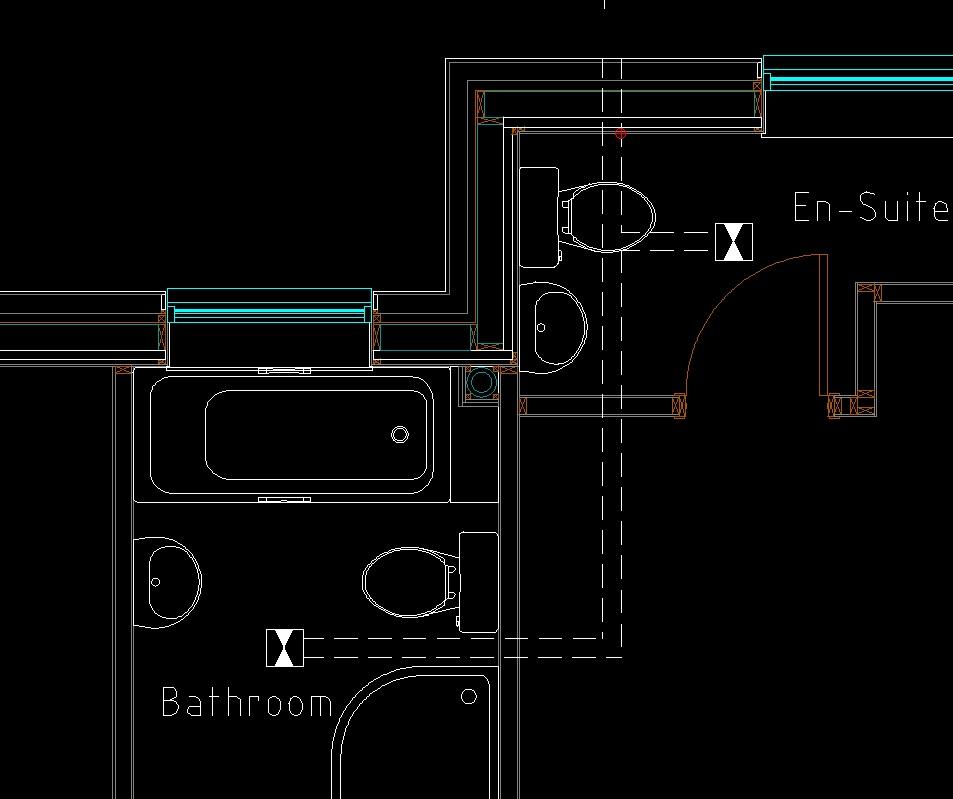

Due to the layout of the house i am designing, as a bathroom and en-suite are close together there is the potential for both to share the same extractor duct work, which means only one external penetration, which is good.
However there vents would need to have some sort of check valve in them so that when the duct was pressured by one room, the extract wouldn't be vented into the other space, does such a thing exist.
The extract fans would likely be ceiling mounted, does anyone know if these have one way valves in them?
While i am looking at this, i have also assumed that both bathroom and en-suite will use a single soil pipe, which is vented through the flat roof

As with @Mr Punter we have a master bathroom and an ensuite shower room next to each other. BC wanted fan in both rooms so we fitted extractors with one way valves/flaps, the pipework from which ran into a t piece in the loft before exiting under eaves.
BC seemed happy and I haven't noticed any backdraft issues?

9 hours ago, joth said:
Soil pipes don't tend to require open venting these days? Use a Durgo/AAV instead
https://www.designingbuildings.co.uk/wiki/Air admittance valve
Interesting, and the use of one of these would negate the need for a penetration through the flat roof.
I presume this could be put on top of the SVP stack within the boxed in section, as long as there was a small vent to within the SVP boxing, like below
https://www.screwfix.com/p/map-vent-fixed-louvre-vent-with-flyscreen-white-229-x-76mm/5104d
