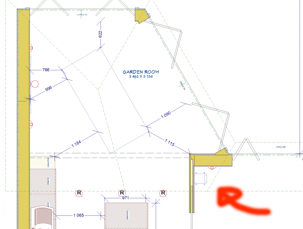

Lesgrandepotato Posted January 28, 2020 Share Posted January 28, 2020 Does it reflect its plot? I prefer the lower one from outside, but the internal junction of the wall that terrine is all wrong. The wall should run round not have a shade making return in it. Link to comment Share on other sites More sharing options...

puntloos Posted January 28, 2020 Author Share Posted January 28, 2020 52 minutes ago, Lesgrandepotato said: Ok, so In my mind the pocket should go to the apparent junction of the two walls instead of being some distance away. Fair enough. I guess the reason for me pulling it back was just to gain space for the living room... but it's only a few cm anyway.. Link to comment Share on other sites More sharing options...
