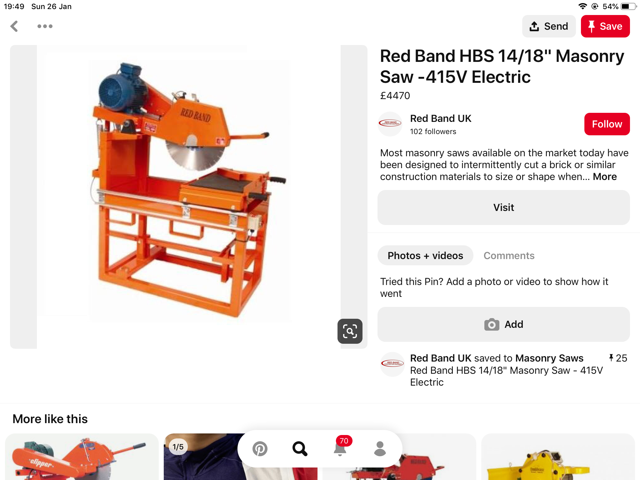

Russell griffiths Posted January 26, 2020 Posted January 26, 2020 (edited) Go and hire a brick cutter with a sliding table popular make is a clipper, it will have a wooden bed inside a steel tray, you screw a piece of wood down so each brick sits at the correct distance, water sprays on the disc, you will cut hundreds of them in a day. Probably don’t need to cut all the way through, 1/3 through and tap with a hammer. Edited January 26, 2020 by Russell griffiths

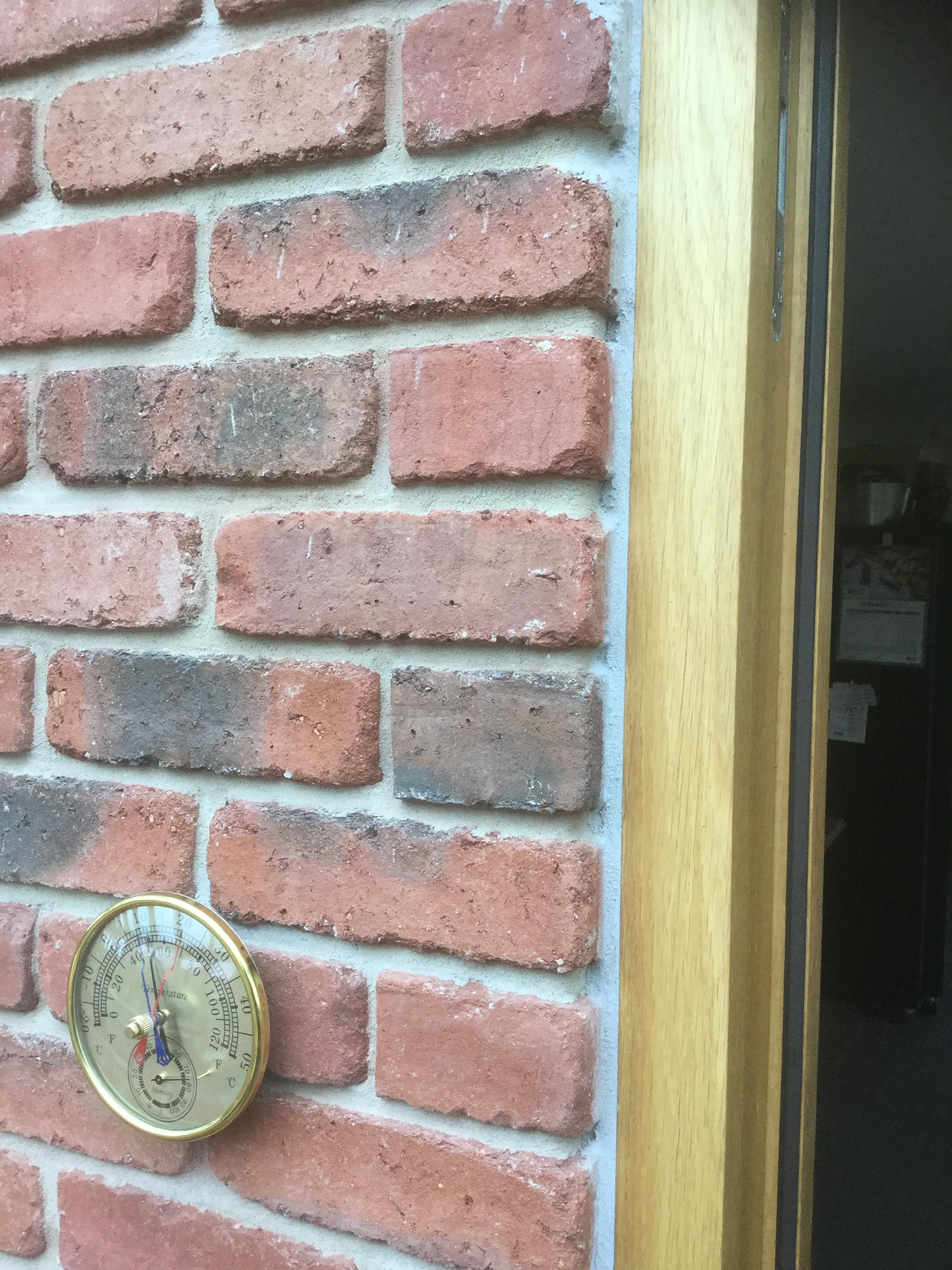

joe90 Posted January 29, 2020 Posted January 29, 2020 (edited) 9 minutes ago, epsilonGreedy said: The current challenge is to split 2500 bricks cleanly in half for the pseudo header courses in an English Bond. Ah!, my builder cut hundreds of my bricks in half as I wanted either full or half bricks at every window and door edge (I am a bit OCD and had doors and windows made to fit the openings), with mine two sides were seen so asked that the cut edge was against the Mortor joint. (They were long bricks so half was not the same as the width) With yours as a header Course you will not see the cut edge so it’s not so important ;is it?. My builder used a disc cutter then bolster. Edited January 29, 2020 by joe90
epsilonGreedy Posted January 29, 2020 Author Posted January 29, 2020 (edited) 1 hour ago, joe90 said: With yours as a header Course you will not see the cut edge so it’s not so important ;is it?. As a fellow OCD sufferer you may comprehend that I do not want the inner face wandering in and out when some bricks split 90mm/125mm. Thanks for the tip about turning half bricks at window apertures, my approved mortar pointing detail is for a flush finish so not as significant as your case. Did the builder have to adjust perp thickness to compensate for the 7mm undersize of a turned brick? I currently have the final mortar colour mix drying in the sun, the answer after many experiment is 5 parts white cement to 1 part standard grey cement plus a local sand with a strong orange tint = nice sandy buff colour mortar near the buff brick colour. Edited January 29, 2020 by epsilonGreedy
Big Jimbo Posted January 29, 2020 Posted January 29, 2020 1 hour ago, joe90 said: Ah!, my builder cut hundreds of my bricks in half as I wanted either full or half bricks at every window and door edge (I am a bit OCD and had doors and windows made to fit the openings), with mine two sides were seen so asked that the cut edge was against the Mortor joint. (They were long bricks so half was not the same as the width) With yours as a header Course you will not see the cut edge so it’s not so important ;is it?. My builder used a disc cutter then bolster. That looks bloody nice fella
joe90 Posted January 29, 2020 Posted January 29, 2020 2 hours ago, epsilonGreedy said: Did the builder have to adjust perp thickness to compensate for the 7mm He worked from the frame inwards so the perps were all (nearly) equal. Great job isnt it?
