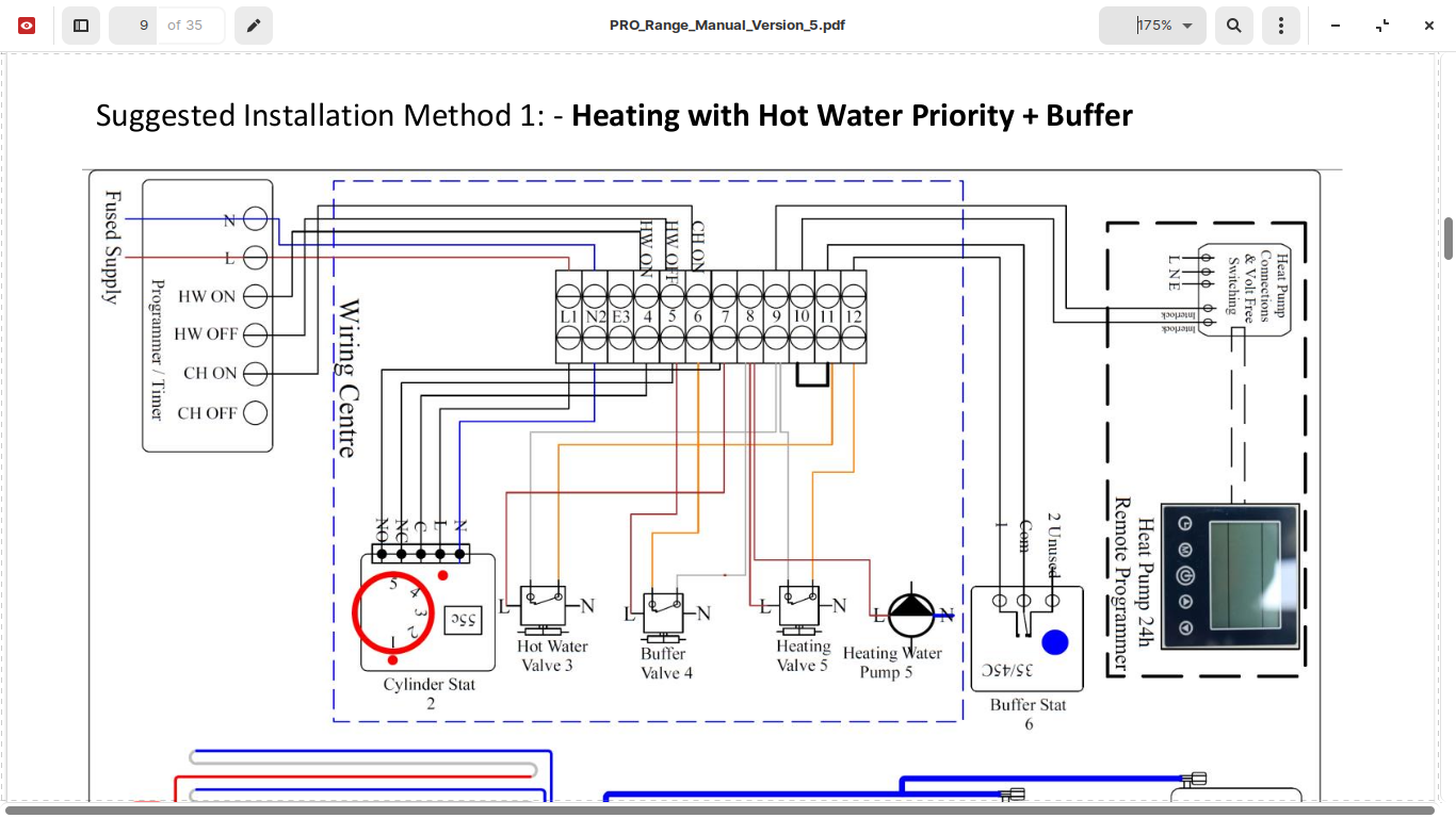

ProDave Posted February 3, 2020 Share Posted February 3, 2020 I have started to look at this in more detail as I will be pre wiring for this Cool Energy ASHP verry soon. This is the wiring diagram from the downloaded manual: It looks VERY basic to me. In particular, the only actual connections to the heat pump appear to be power and a pair of wires labelled "interlock" These appear to me to be just a "call for heat" and seem to be the logical or of the hot water and heating valves plus thermostats. So as far as I can tell, the HP cannot tell if it is being asked to heat DHW or space heating. Which is strange as when you look through the parameter list, it has separate set temperatures for DHW and heating. And it is most definitely NOT an inverter driven heat pump. It will be interesting to see how it performs, but it would not be my choice. Link to comment Share on other sites More sharing options...
dpmiller Posted February 3, 2020 Share Posted February 3, 2020 looks like it's using it's own programmer to do the flow temps based on times? Link to comment Share on other sites More sharing options...
Ed Davies Posted February 4, 2020 Share Posted February 4, 2020 (edited) 13 hours ago, dpmiller said: looks like it's using it's own programmer to do the flow temps based on times? So you have to synchronise the programmer's own timer with the main CH/DHW programmer or are the programmer/timer on the left of that diagram and the heat pump 24 hr remote programmer on the right the same thing? If the second that's a pretty misleading diagram. It's quite poor anyway: e.g, I'm only guessing but I doubt the cylinder stat, etc, are in the wiring centre. Edited February 4, 2020 by Ed Davies Link to comment Share on other sites More sharing options...
ProDave Posted February 4, 2020 Share Posted February 4, 2020 It does seem a pretty poor setup. But I can only see the one "interlock" (call for heat) connection so I can't see what else it can do. The default set temperature for heating is 55 degrees, same as the default set temperature for DHW so unless you change those it's immaterial The install I am about to do the customer is using radiators to heat the house so will want high temperature heating water anyway, so probably not a big issue. It would not exactly have been difficult when designing it, to give it two call for heat inputs, one for heating and one for DHW then it could easily run at 2 different temperatures. I would not be buying one of these for my own use. The more I look at that wiring diagram the more it puzzles me. I have never yet seen a cylinder thermostat that needs a L and N as well as com, no and nc. This one is going into a 3 bedroom semi detached house. It's near identical twin is having a Mitsubishi Ecodan heat pump and cylinder. It would be interesting to compare the heating bills between the two down the line. Link to comment Share on other sites More sharing options...
Ed Davies Posted February 4, 2020 Share Posted February 4, 2020 42 minutes ago, ProDave said: But I can only see the one "interlock" (call for heat) connection so I can't see what else it can do. There's that dashed connection of some sort between the remote programmer and the heat pump itself. I'd assume that's representing a pre-wired multicore cable giving more nuanced control over the HP. If the two programmers on opposite sides of that diagram are actually the same thing then it's pretty easy for it to do all the temperature setting, etc. The “interlock” connection would then just be signalling to the HP that the zone valves have operated properly (or, at least, that one of them has). Link to comment Share on other sites More sharing options...
dpmiller Posted February 4, 2020 Share Posted February 4, 2020 I think they're seperate. Looking at the menu for the non-inverter controller it does seem to have two temperatures but the timer programming bit doesn't allude to DHW and CH schedules. Link to comment Share on other sites More sharing options...
Ed Davies Posted February 4, 2020 Share Posted February 4, 2020 40 minutes ago, dpmiller said: I think they're seperate. Having read through the manual I think they're separate, too. 41 minutes ago, dpmiller said: Looking at the menu for the non-inverter controller it does seem to have two temperatures but the timer programming bit doesn't allude to DHW and CH schedules. Yes, that's a puzzle. I think there's some connection missing from the manual somewhere. Link to comment Share on other sites More sharing options...
ProDave Posted February 4, 2020 Share Posted February 4, 2020 I am just going to throw in a length of multicore control cable for now and see what connections the thing has when it arrives. Link to comment Share on other sites More sharing options...
