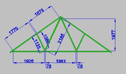

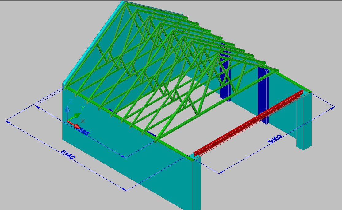

Onoff Posted April 7, 2020 Author Share Posted April 7, 2020 Having a bit of time to kill I'm looking to resurrect my plan to put some storage space in the currently truss raftered roof. Just found my old sketches and re-did the CAD. Trusses are made out of nom. 70x35 timbers. There's a 178 x 102 RSJ spanning the front opening top of which is 80mm lower than the u'side of the trusses. Construction is 4" Celcon blocks with pillars. Gable end is 4" Celcon carried on up to the peak (some pillars on that wall too that I should add. The end where the trusses aren't shown is a hip end. One "plan" is to span some deep (thus expensive) timbers across and sister them to the trusses. Then build up a frame inside and cut out the trusses to give a clear storage area. Another option was to install a new steel, front to back from the middle of that RSJ and support it on a post at the gable end. Ideally I don't want any other vertical posts along it's length to open car doors into etc. Or maybe steel goal posts tucked tight to the side walls, again with a central steel. Whatever option it'll be without taking the existing roof felt & tiles off. Any thoughts, pointers? Getting an SE in, not going to happen! Link to comment Share on other sites More sharing options...

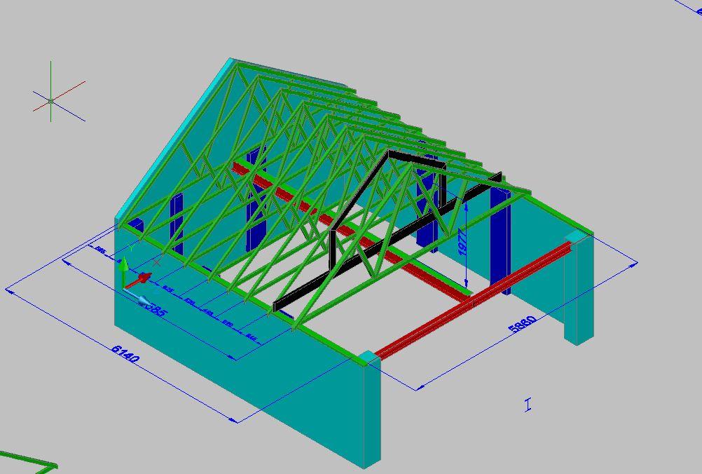

Onoff Posted April 11, 2020 Author Share Posted April 11, 2020 (edited) @scottishjohn, continuing here from the other thread: I have a double garage with truss rafters. I desperately need more storage space. I've been up in there and measured the section of the trusses, nominally 70x35mm. Across the front entrance is a 178x102 RSJ (as in tapered flanges). I'd thought about just spanning the walls with bfo timbers, say 9"x3". I've an old Approved Document A here from 1985 and even 225x75 SC3 at 600 centres doesn't cut it as floor joists. Again, this will not be a "living" area, just storage. Thus half a plan then to run a new UB down the centre, mid span and underneath of the existing trusses. I've drawn this in as a 254x146x31kg/m as it fits with just 7mm of packing between it and the u/side of the existing trusses. Connect the UB to the RSJ at the front. I imagine I'll need square posts coming up from the floor to support the new UB. Then span wall to wall, on the existing wall plate with 200x47. Then frame out up and over in 150x47, screwed to the existing trusses. Then CUT AWAY the existing trusses giving me an open "room". I'll cost it versus a new timber roof trusses. If money were no object! Edited April 11, 2020 by Onoff Link to comment Share on other sites More sharing options...
scottishjohn Posted April 11, 2020 Share Posted April 11, 2020 that will work for sure - If you made the black frame work out of large enough wood ,then no need fro the longditudinal RSJ would just shadow the original trusses with larger ones and fix together then a cross brace close to the apex along with larger lower cross beam it will be fine --verticals if you like to make it stronger and have fixing for walls of upper room Link to comment Share on other sites More sharing options...
Onoff Posted April 11, 2020 Author Share Posted April 11, 2020 3 hours ago, scottishjohn said: that will work for sure - If you made the black frame work out of large enough wood ,then no need fro the longditudinal RSJ would just shadow the original trusses with larger ones and fix together then a cross brace close to the apex along with larger lower cross beam it will be fine --verticals if you like to make it stronger and have fixing for walls of upper room It'll work in essence but I'd like to be a bit more scientific about it. I'm all rule of thumb generally! My new, proposed ceiling horizontal joists. Do I consider them Floor Joists or Ceiling Joists for a start? Now for Floor Joists there are 3 dead load options: - Not more than 0.25kN/m2 - More than 0.25 but not more than 0.50kN/M2 - More than 0.50kN/M2 but not more than 1.25kN/M2 But for Ceiling Joists only two options: - Not more than 0.25kN/m2 - More than 0.25 but not more than 0.50kN/M2 In each case 3 joist spacings; 400, 450 & 600mm. In my case I've assumed 600mm though it varies from 440 to 645mm. Not one pair of trusses is centred the same. Assuming Ceiling Joists then: Taking SC3 tables as it was, now C16 I believe. Not more than 0.25kN/M2 is 250kg over an area of 1 square metre. I'd never exceed that. A 225x50 joist allows a maximum clear span of 5280mm. I've a clear span between my walls of 5860mm. (For Floor Joists a 225x75 only does 4880mm at 600mm centres). Link to comment Share on other sites More sharing options...
scottishjohn Posted April 11, 2020 Share Posted April 11, 2020 5 minutes ago, Onoff said: It'll work in essence but I'd like to be a bit more scientific about it. I'm all rule of thumb generally! My new, proposed ceiling horizontal joists. Do I consider them Floor Joists or Ceiling Joists for a start? Now for Floor Joists there are 3 dead load options: - Not more than 0.25kN/m2 - More than 0.25 but not more than 0.50kN/M2 - More than 0.50kN/M2 but not more than 1.25kN/M2 But for Ceiling Joists only two options: - Not more than 0.25kN/m2 - More than 0.25 but not more than 0.50kN/M2 In each case 3 joist spacings; 400, 450 & 600mm. In my case I've assumed 600mm though it varies from 440 to 645mm. Not one pair of trusses is centred the same. Assuming Ceiling Joists then: Taking SC3 tables as it was, now C16 I believe. Not more than 0.25kN/M2 is 250kg over an area of 1 square metre. I'd never exceed that. A 225x50 joist allows a maximum clear span of 5280mm. I've a clear span between my walls of 5860mm. (For Floor Joists a 225x75 only does 4880mm at 600mm centres). they are not only floor +ceiling joists but also roof trusses -if you fit your vertical ones as shown in picture-as they are taking downwards load from roof ,unless you make the "sister trusses big enough to take all roof + a bit leaving originals inplace and fixing to them I am guessing would make them plenty strong-that of course is a guess on my part- I am not an SE you could of ocurse cross brce the sections outside the verticals you are using as walls for top room you would end up with four triangles then with the small top brace up nearthe apex Link to comment Share on other sites More sharing options...

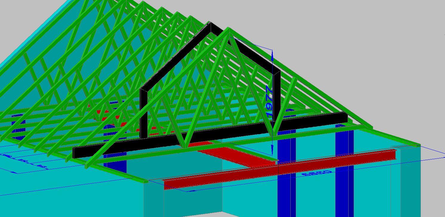

Onoff Posted July 9, 2020 Author Share Posted July 9, 2020 1 hour ago, Nickfromwales said: What centres, what? 400, 450, 600 centres? Flitch beam spacing or was there just the one? I'd need up to 9 such beams: Just realised there is/are flitch beams in this house now. Didn't put two and two together! I've the dormer extension drawings that I got (as a freebie) from BC a couple of years back. Link to comment Share on other sites More sharing options...
Nickfromwales Posted July 9, 2020 Share Posted July 9, 2020 (edited) You don’t use the FB’s throughout! One steel across the garage door opening, one FB mid span, parallel to the steel, a wall plate on the back wall, and then timbers stitched in between. Looking at the pic, why not just use steel to form a T and then span from centre out? However......... As we are in fear of over-engineering this ( ? ) why not revert to the earlier suggestion of a 5x2 each side of the bottom of the trusses? So bloody simple, and if you’re going to board out and form I deck you there, glued and screwed, it’ll be rock solid. Every time I do structural joinery I look at it and think to myself “that’s way over the top”, but get an SE involved and that’s what usually happens ( as they have to professionally underwrite that solution ) so do you really need this degree of technicality for this project ? Edited July 9, 2020 by Nickfromwales Link to comment Share on other sites More sharing options...
