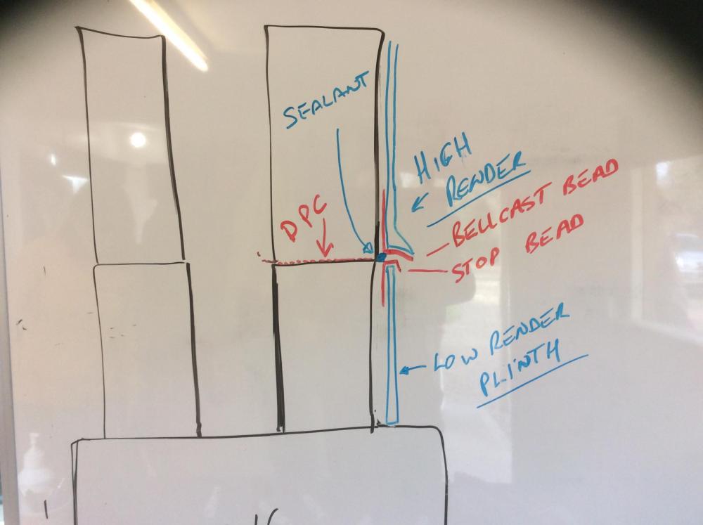

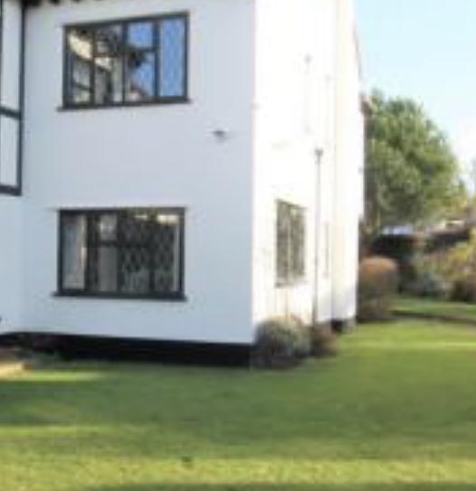

Grant Posted January 12, 2020 Author Share Posted January 12, 2020 The house is currently rendered top to bottom - but with the lowest section in a black render. are you saying that I can’t match this, and instead need to have exposed brick below DPC? attached image hopefully clarifies what I’m working with Link to comment Share on other sites More sharing options...
Construction Channel Posted January 12, 2020 Share Posted January 12, 2020 Can't is a strong word. I'm sure there will be a way round it but it's not standard practice to render below dpc as it bridges it. Dpc is usually set 2 courses (150mm) above ground level so that rain splash / snow won't reach above the dpc. This can sometimes be overcome with a French drain (100mm wide gravel channel around the building) but all these things will come down to what the BCO will accept. Link to comment Share on other sites More sharing options...
Grant Posted January 12, 2020 Author Share Posted January 12, 2020 1 hour ago, Construction Channel said: Can't is a strong word. I'm sure there will be a way round it but it's not standard practice to render below dpc as it bridges it. Dpc is usually set 2 courses (150mm) above ground level so that rain splash / snow won't reach above the dpc. This can sometimes be overcome with a French drain (100mm wide gravel channel around the building) but all these things will come down to what the BCO will accept. this is super helpful! Thank you for the advice ? Link to comment Share on other sites More sharing options...
Russell griffiths Posted January 12, 2020 Share Posted January 12, 2020 You can render below dpc no problem, but you must show that this render is completely separate from the render above dpc. So the bit below will need to finish level with the dpc and you need to show a detail of separation as I’m sitting here having a cuppa I found you a couple of pics First pic is the sort of detail you need to achieve, ignore the external insulation as it’s the first pic I could find, second pic shows what it would look like very roughly just to give you some ideas. Link to comment Share on other sites More sharing options...
Russell griffiths Posted January 12, 2020 Share Posted January 12, 2020 Just did this as it may be easier to see, depends on my poor drawing skills. Lots of details missing but it might point you in the right direction. Link to comment Share on other sites More sharing options...
Grant Posted January 12, 2020 Author Share Posted January 12, 2020 17 minutes ago, Russell griffiths said: Just did this as it may be easier to see, depends on my poor drawing skills. Lots of details missing but it might point you in the right direction. A picture like this is exactly the sort of info I was looking for online. When I speak with building control, I’ll ask if this is possible, as the ‘full render’ look was what I was hoping for, giving the style of the house thanks Russell Link to comment Share on other sites More sharing options...
