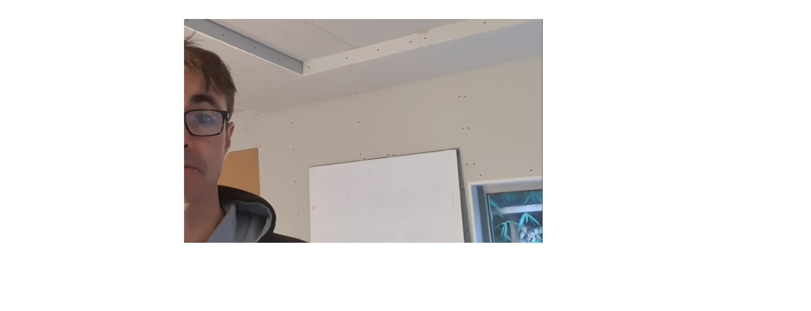

vivienz Posted January 8, 2020 Posted January 8, 2020 Could you do a cardboard mock up and stick it to your ceiling and get a feel for it? 1

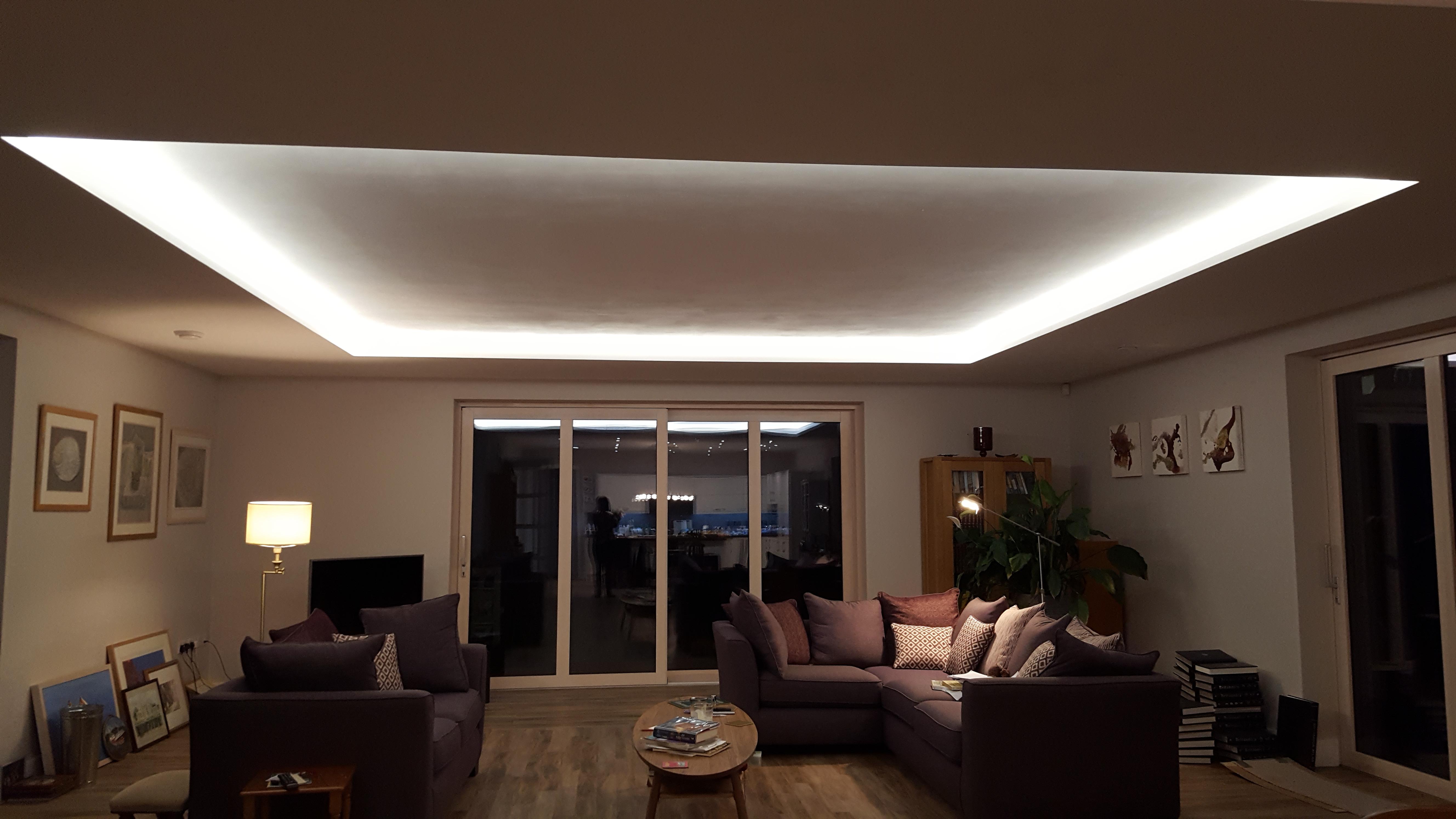

ProDave Posted January 8, 2020 Posted January 8, 2020 1 hour ago, vivienz said: FWIW, this is how ours looks now. What is the ceiling heights of the raised and dropped areas?
vivienz Posted January 8, 2020 Posted January 8, 2020 The centre is the full height ceiling, 2700mm. The border around the edges is about 150mm depth. 1

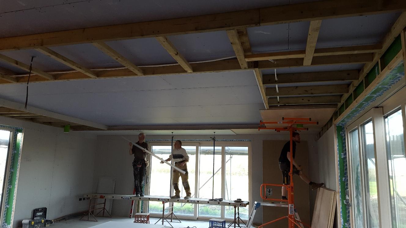

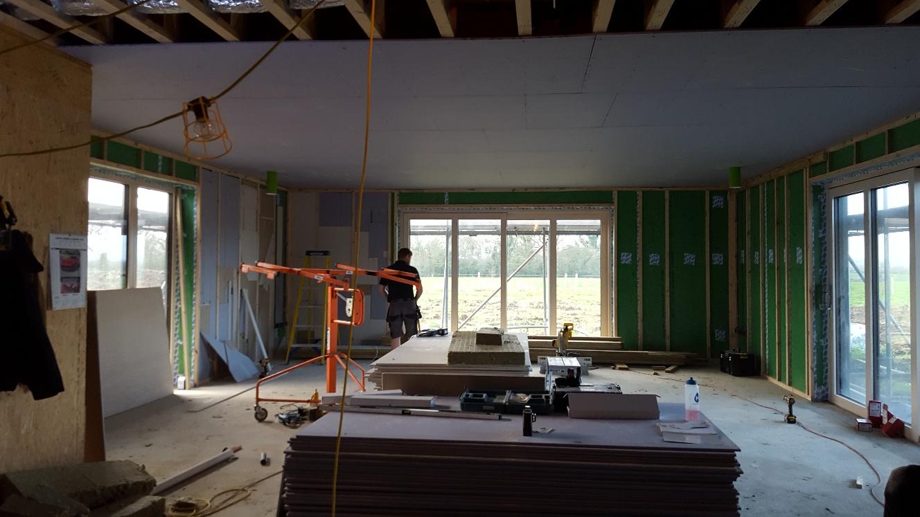

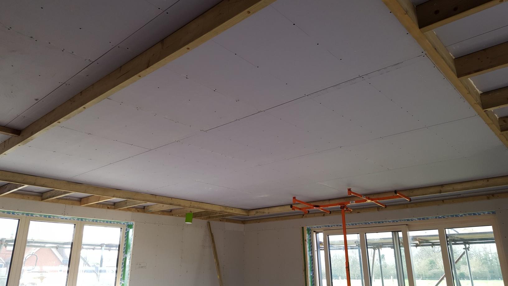

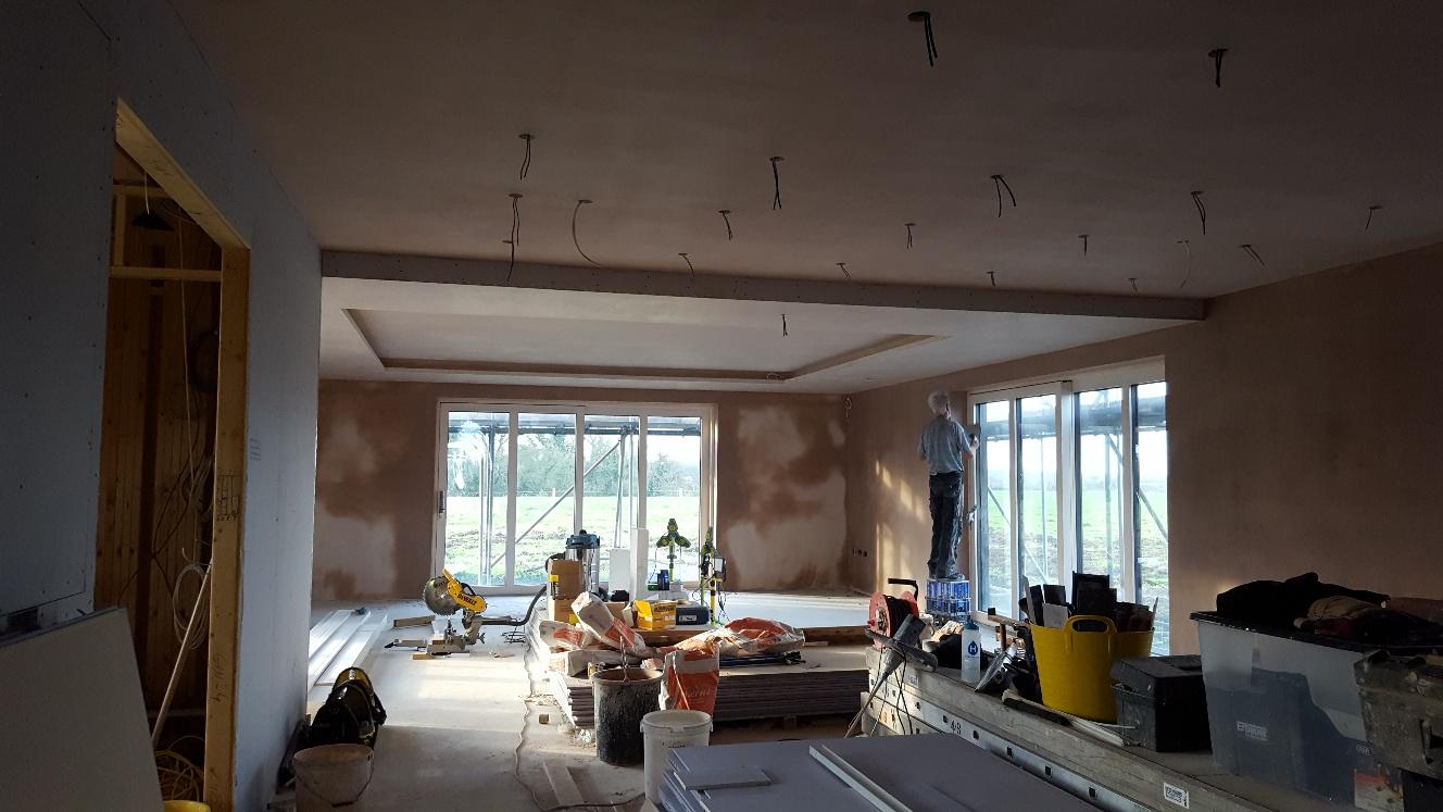

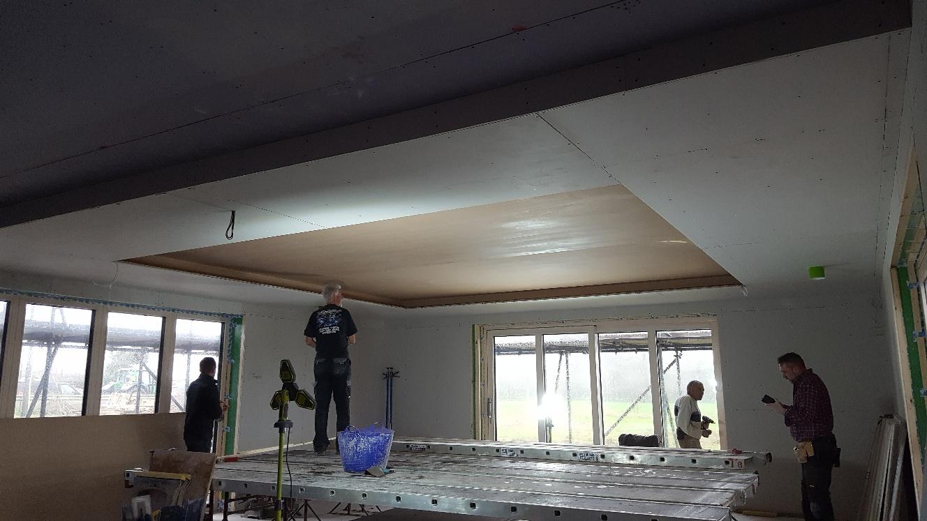

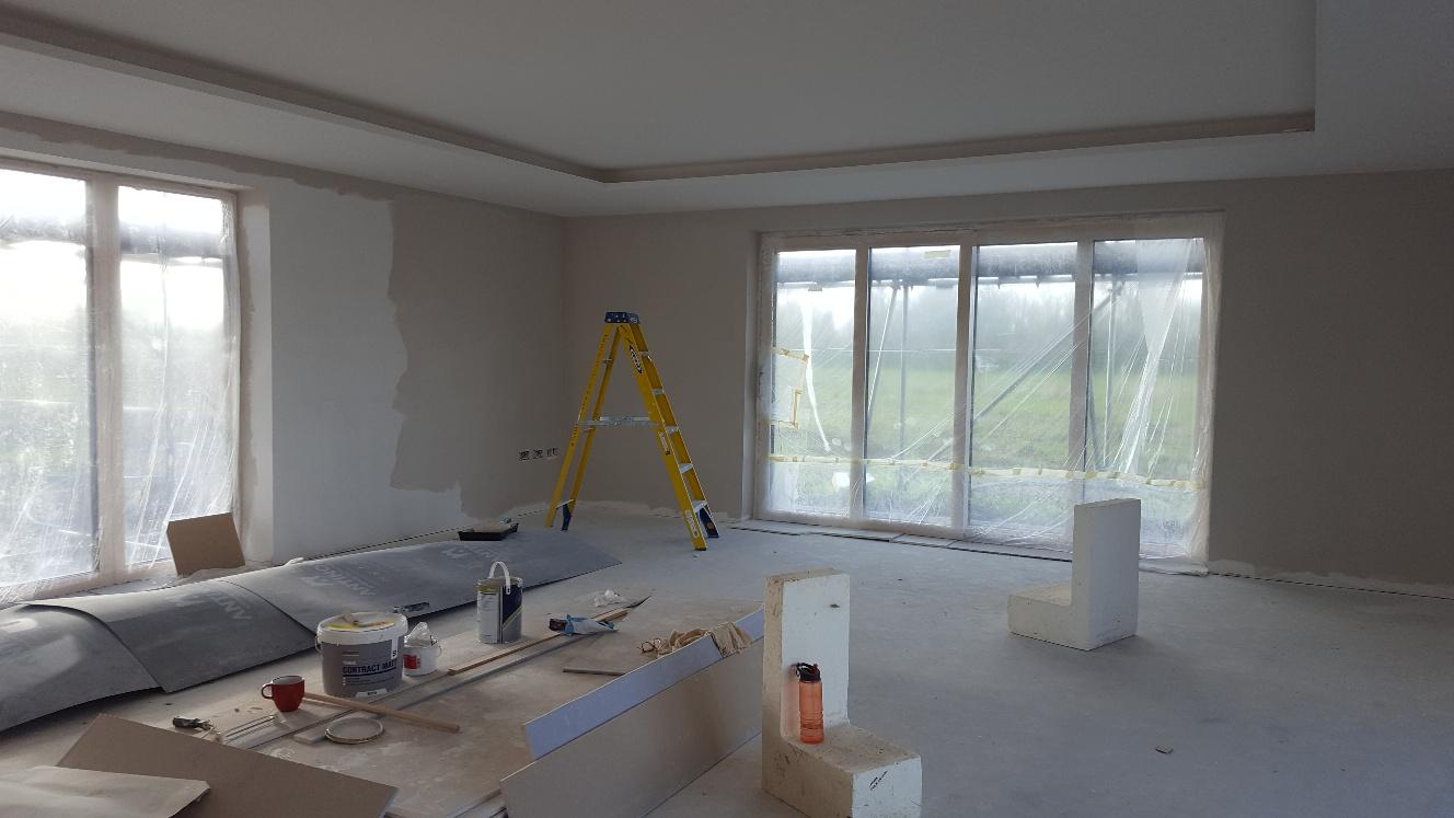

vivienz Posted January 10, 2020 Posted January 10, 2020 Sorry for the delay on the reply here, I've been transferring everything to a new PC in anctipation of the death of Windows XP and 7. Anyhow, I've found a few photos of the ceiling feature in the lounge area whilst under construction, so here they are. First off, the entire ceiling was dry lined with acoustic plasterboard. Heavy stuff, quite literally, and it took the PB lifter and plenty of strong arms to get it all up there. After the entire lounge/diner/kitchen ceiling was boarded, construction of the dropped border area was started. Note that the lighting electrical connections were all pulled through the boarding and in place throughout. There is a perimeter border, on the top of the walls, then the inner border at the appropriate depth. Noggins were put in all around to stabilise the whole thing and to make sure that the next lot of plasterboard had something to attach to. The green tube poking out at the bottom just left of centre is the MVHR inlet. There is another at the mirrored position on the right hand side, just out of shot. Next up was boarding the dropped section. This was done on the horizontal and then vertical pieces on the inner inset part. The horizontal was done in two stages - first up using ply, then the plasterboard was attached to this. Also, timber was put around the edge of the inner rim in the form of an upstand. This gives the impression of greater depth and more substance, as well as something to hide the LED lights behind. Once all the boarding was done, plastering was next. As seen in the photo, the inner section was done first. You can also see the right hand MVHR inlet now. It's worth making a comment on the staging boards, which I hired in for this job. They weren't cheap to hire, but it made the job of plastering so much easier and what it cost in hire was more than made up for by the quality of finish they were able to achieve and not having to waste time moving things around to get from one part to another. The whole of that lounge area ceiling was plastered in a day as a result. Here's the final plastered result, looking from the kitchen. The excess MVHR inlets was cut away immediately before plastering. Then, finally, here it is with the mist coat sprayed on. 1 1
vivienz Posted January 10, 2020 Posted January 10, 2020 @Adam2 I have two sets of LED strips up there - 1 light switch does one set (dipped headlights) and the other brings on the second (full beam). One set of lights is more than enough to read by - they are very effective. If we're watching tv, we just have table lamps on and I have an overhead LED reading lamp if I was to read whilst OH watches the box. 1
AdamSee Posted January 12, 2020 Posted January 12, 2020 Brilliant thanks. It certainly makes your living room feel welcoming and relaxing. My plan was to do the same as this but in a much smaller room (2.2 X 2.9m). Currently I have down lights in my office and they are horrible to have on. This idea seems like it would provide a much more relaxing enviroment to think in.
vivienz Posted January 13, 2020 Posted January 13, 2020 I would use this feature again, not that I plan to. The wash of light on the ceiling is effective and I think it's nicer than the coving lights that you can get, which I also considered.
