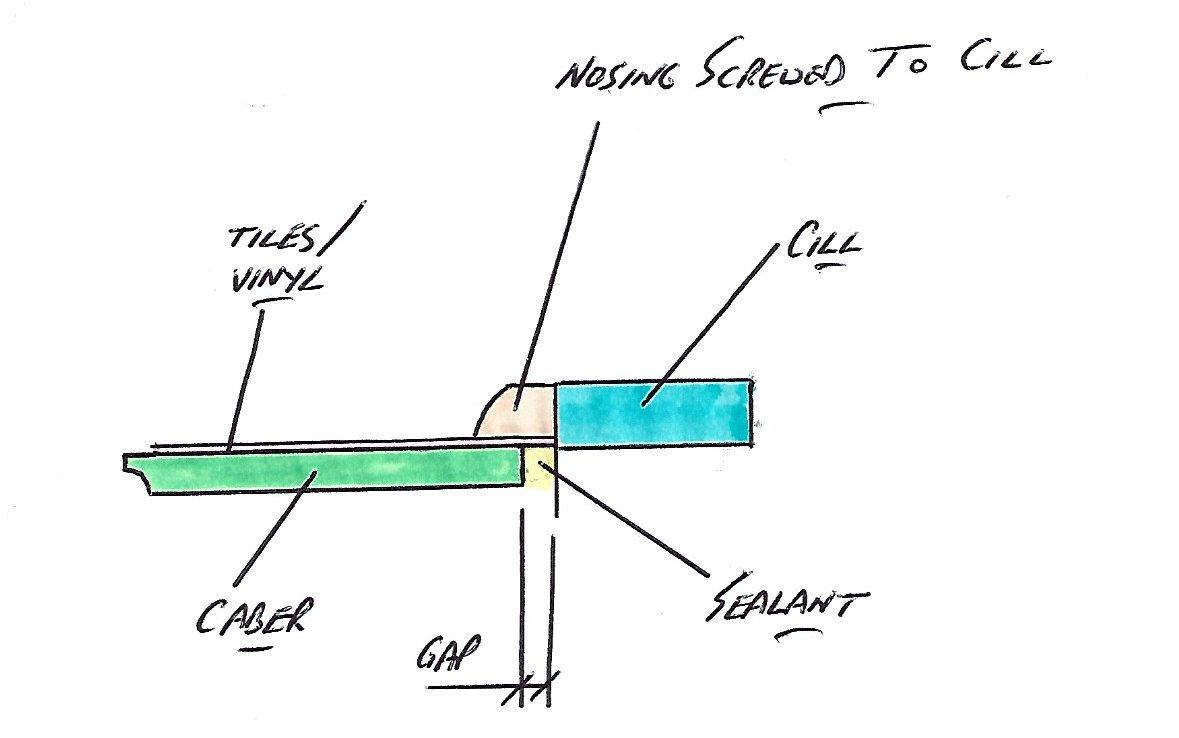

zoothorn Posted April 30, 2020 Author Share Posted April 30, 2020 52 minutes ago, PeterW said: It won’t expand. It’s a myth. Cover it with a piece of timber and move on. But isn't it easier to just fill it with PIR? I don't need to glue if friction-very-tightly in. just trim off top to floor level. no? Link to comment Share on other sites More sharing options...
PeterW Posted April 30, 2020 Share Posted April 30, 2020 PIR will break up over time. Timber or sealant or both. Link to comment Share on other sites More sharing options...
Gone West Posted May 1, 2020 Share Posted May 1, 2020 13 hours ago, zoothorn said: I do need to ask one last thing on the caber boards: I've left the usual 10mm expansion gap @ my threshold, away from the slate sill/ threshold section itself.. & this seems the most susceptible bit to get rained on if not moisture off wet feet etc. What to do here? Will you be having a door mat? You can buy coir door matting off the roll around 15 to 20mm thick. 2 Link to comment Share on other sites More sharing options...
Onoff Posted May 1, 2020 Share Posted May 1, 2020 12 hours ago, zoothorn said: Understood. But why didn't I just butt the floor up to the threshold.. because I had to have an expansion gap (aparantly), so how would this wood addition not negate the whole idea? this is why I thought PIR so it could expand into it, if it had to, in theory. This is how the wood doesn't "negate the whole idea", in greater detail and pretty colours with labels: - You fill you gap with sealant. That still allows expansion. - You lay your vinyl tiles - Screw a nosing, ideally hardwood, to the cill. The floor is free to expand in/out under the nosing. There's no joint between underside of nosing and vinyl tiles so it'll "slide" if required. Link to comment Share on other sites More sharing options...

Onoff Posted May 1, 2020 Share Posted May 1, 2020 20 minutes ago, joe90 said: @Onoff Same as I said (but I don’t have crayons) ? I was spelling it for him, in colour and big words as God knows how, your sketch still prompted questions! ? 1 Link to comment Share on other sites More sharing options...

zoothorn Posted May 2, 2020 Author Share Posted May 2, 2020 22 minutes ago, Onoff said: ...and we also need a tongue in cheek emoji! Am I allowed to glue the nosing to the cill? Its a piece of 'natural' slate/ not a thick solid bit either.. may well split or break if muggins drills into it. Link to comment Share on other sites More sharing options...
PeterW Posted May 2, 2020 Share Posted May 2, 2020 5 minutes ago, zoothorn said: Am I allowed to glue the nosing to the cill? Its a piece of 'natural' slate/ not a thick solid bit either.. may well split or break if muggins drills into it. Just no nails or something similar. No screws required. Link to comment Share on other sites More sharing options...
zoothorn Posted May 2, 2020 Author Share Posted May 2, 2020 56 minutes ago, PeterW said: Just no nails or something similar. No screws required. Great that's a plan then. finishing touches so a while off. cheers zoot Link to comment Share on other sites More sharing options...
