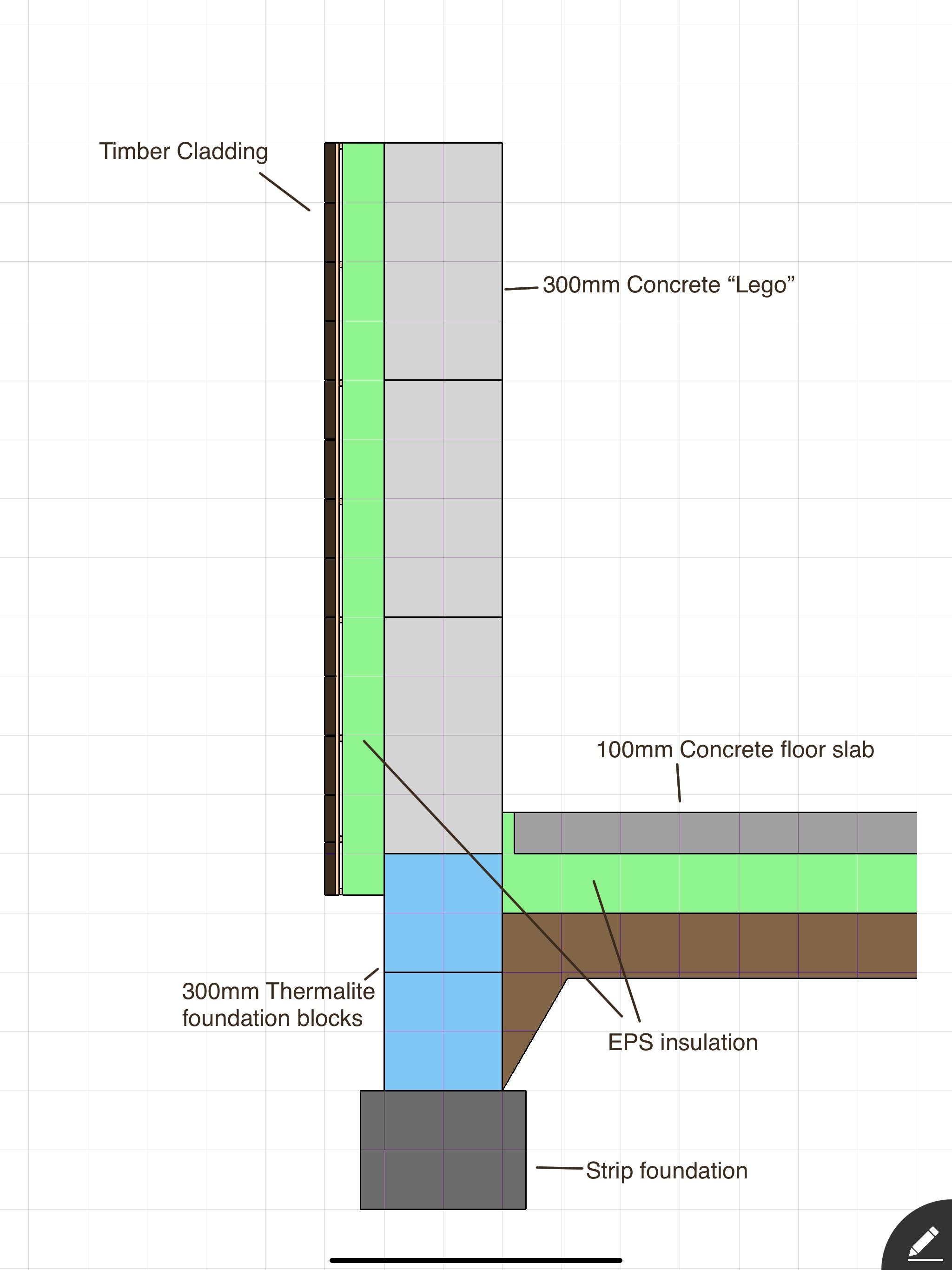

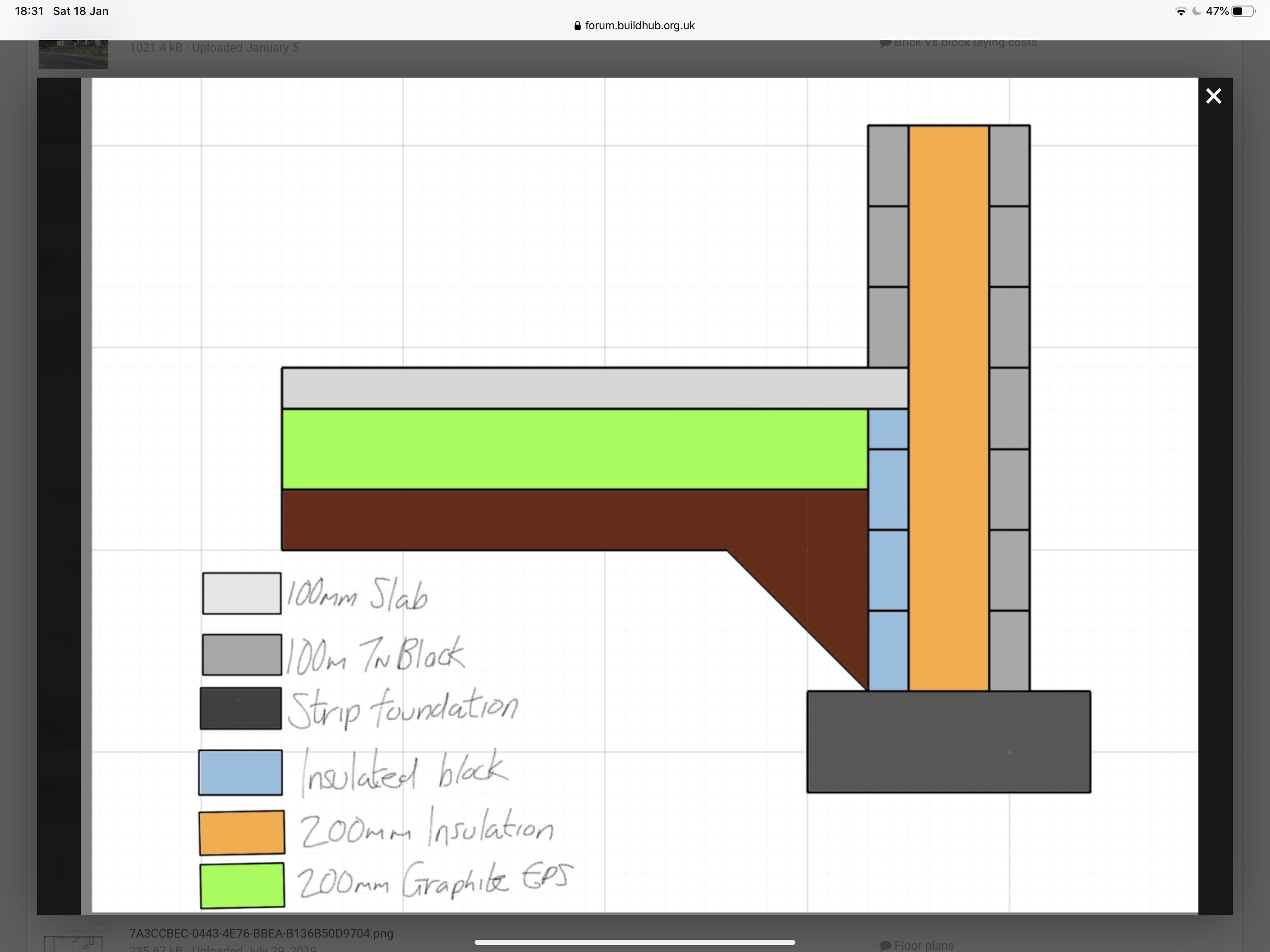

K78 Posted January 18, 2020 Author Share Posted January 18, 2020 (edited) On 17/01/2020 at 08:41, Jeremy Harris said: How would you deal with the big thermal bridge at the base of the blocks. though? You could probably design a passive slab, with a reinforced ring beam around the edge, that would take the loading from the blocks. That would then give you insulation under the floor slab, under the blocks and up around the edge ready to be continued with EWI up the walls, so no thermal bridging at all. If you fitted UFH inside the concrete slab then you would effectively be warming/cooling the slab and the walls, like a giant storage heater/cooler. I was thinking of using a similar approach to what I was going to use for a cavity build. Your idea Is much better but I worry about the design costs. I’ve wasted so much money with SE’s and anything slightly unusual usually costs a fortune. I have emailed Olof at AFT to see what he thinks. Edited January 18, 2020 by K78 Link to comment Share on other sites More sharing options...
Jeremy Harris Posted January 18, 2020 Share Posted January 18, 2020 Worth giving Hilliard Tanner a call, too. He's been designing passive slabs for a decade or so now, and probably knows more about them than a lot of SEs. He wrote this report for Kore, which is probably worth a read: Kore Insulated Foundations Report.pdf 1 Link to comment Share on other sites More sharing options...
Declan52 Posted January 18, 2020 Share Posted January 18, 2020 If on your founds you build a few courses of thermal type blocks this could form your break and reduce the thermal bridge. Will also help you get it perfectly level. You will obviously need to check the blocks are rated to a high enough N to withstand the weight that will be above. 1 Link to comment Share on other sites More sharing options...

Stones Posted January 19, 2020 Share Posted January 19, 2020 14 hours ago, K78 said: I was thinking of using a similar approach to what I was going to use for a cavity build. Your idea Is much better but I worry about the design costs. I’ve wasted so much money with SE’s and anything slightly unusual usually costs a fortune. I have emailed Olof at AFT to see what he thinks. I think this is a very interesting idea, and given your proximity to the supplier (and the potential to negotiate a deal as they want to promote the product for housebuilding), worth serious consideration. Personally, I wouldn't be too worried by the thermal bridge issue of using strip foundations. Our house, (155sqm footprint) is built from ICF (280mm block, 150mm concrete core), the blocks sitting directly on the strip foundation without thermal break. The slab is cast onto insulation but is (in contrast to the detail above) thermally broken from the ICF wall, i.e. it 'floats'. Cost wise we heat to 21C 24/7 and we spend £200 a year on heating, which given our rather exposed location, is IMHO, a pretty good result. Something to think about if you go down this route: the cost of fixings and labour to fit insulation and timber strapping. ICF blocks generally have the benefit of plastic ties holding the two sides of insulation together to form the block, but they also perform another critical function - standardised fixing points into which fixings can be secured without having to drill hundreds if not thousands of holes into the concrete itself. You are going to have to mechanically fit a good depth of EWI, I assume some IWI, and then strap the walls inside to create a service void before you fit plasterboard. That's a lot fixings and a lot of drilling, time and money. Critical I think that you factor this in. If you have a look at my blog there is some info and pictures on some of the fixings used in our build. 1 Link to comment Share on other sites More sharing options...

K78 Posted January 21, 2020 Author Share Posted January 21, 2020 On 19/01/2020 at 09:44, Stones said: I think this is a very interesting idea, and given your proximity to the supplier (and the potential to negotiate a deal as they want to promote the product for housebuilding), worth serious consideration. Personally, I wouldn't be too worried by the thermal bridge issue of using strip foundations. Our house, (155sqm footprint) is built from ICF (280mm block, 150mm concrete core), the blocks sitting directly on the strip foundation without thermal break. The slab is cast onto insulation but is (in contrast to the detail above) thermally broken from the ICF wall, i.e. it 'floats'. Cost wise we heat to 21C 24/7 and we spend £200 a year on heating, which given our rather exposed location, is IMHO, a pretty good result. Something to think about if you go down this route: the cost of fixings and labour to fit insulation and timber strapping. ICF blocks generally have the benefit of plastic ties holding the two sides of insulation together to form the block, but they also perform another critical function - standardised fixing points into which fixings can be secured without having to drill hundreds if not thousands of holes into the concrete itself. You are going to have to mechanically fit a good depth of EWI, I assume some IWI, and then strap the walls inside to create a service void before you fit plasterboard. That's a lot fixings and a lot of drilling, time and money. Critical I think that you factor this in. If you have a look at my blog there is some info and pictures on some of the fixings used in our build. I have just done a sketch of the wall build up I was thinking of using if I go with strip foundations. All the EWI and cladding would be DIY with skilled assistance. I think @Jeremy Harris suggestion of hilti nailing is the best option. 1 Link to comment Share on other sites More sharing options...
