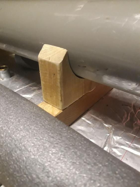

PeterW Posted January 13, 2020 Share Posted January 13, 2020 More likely that it is too shallow and it’s a convoluted route slowing it down. Why can’t it go directly across the ceiling ..? Link to comment Share on other sites More sharing options...
Onoff Posted January 13, 2020 Author Share Posted January 13, 2020 10 minutes ago, PeterW said: More likely that it is too shallow and it’s a convoluted route slowing it down. Why can’t it go directly across the ceiling ..? It did originally, but that got in the way of doing other new pipes etc. Link to comment Share on other sites More sharing options...
PeterW Posted January 13, 2020 Share Posted January 13, 2020 Looks like you have clearance - I would be re-routing that as it looks too shallow and the changes in direction will not be helping. Link to comment Share on other sites More sharing options...

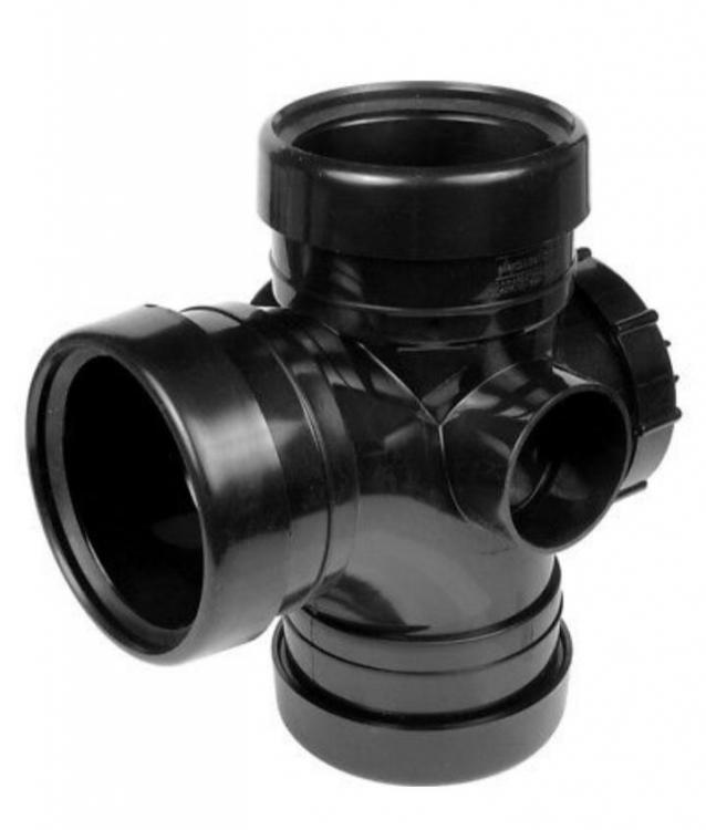

joe90 Posted January 13, 2020 Share Posted January 13, 2020 4 minutes ago, Cpd said: pretty sure when I was researching about this that a steep fall is not a problem I agree, and with @PeterW above, too shallow a run. Why the two 90’ bends with spurs and blanks in? Link to comment Share on other sites More sharing options...

Mr Punter Posted January 13, 2020 Share Posted January 13, 2020 Can you get rid of the branch on top of the elbow, just have the elbow and lift the horizontal pipe so it all has a really nice fall to the outside? You would probably gain 200mm in fall and therefore no issues. Link to comment Share on other sites More sharing options...
