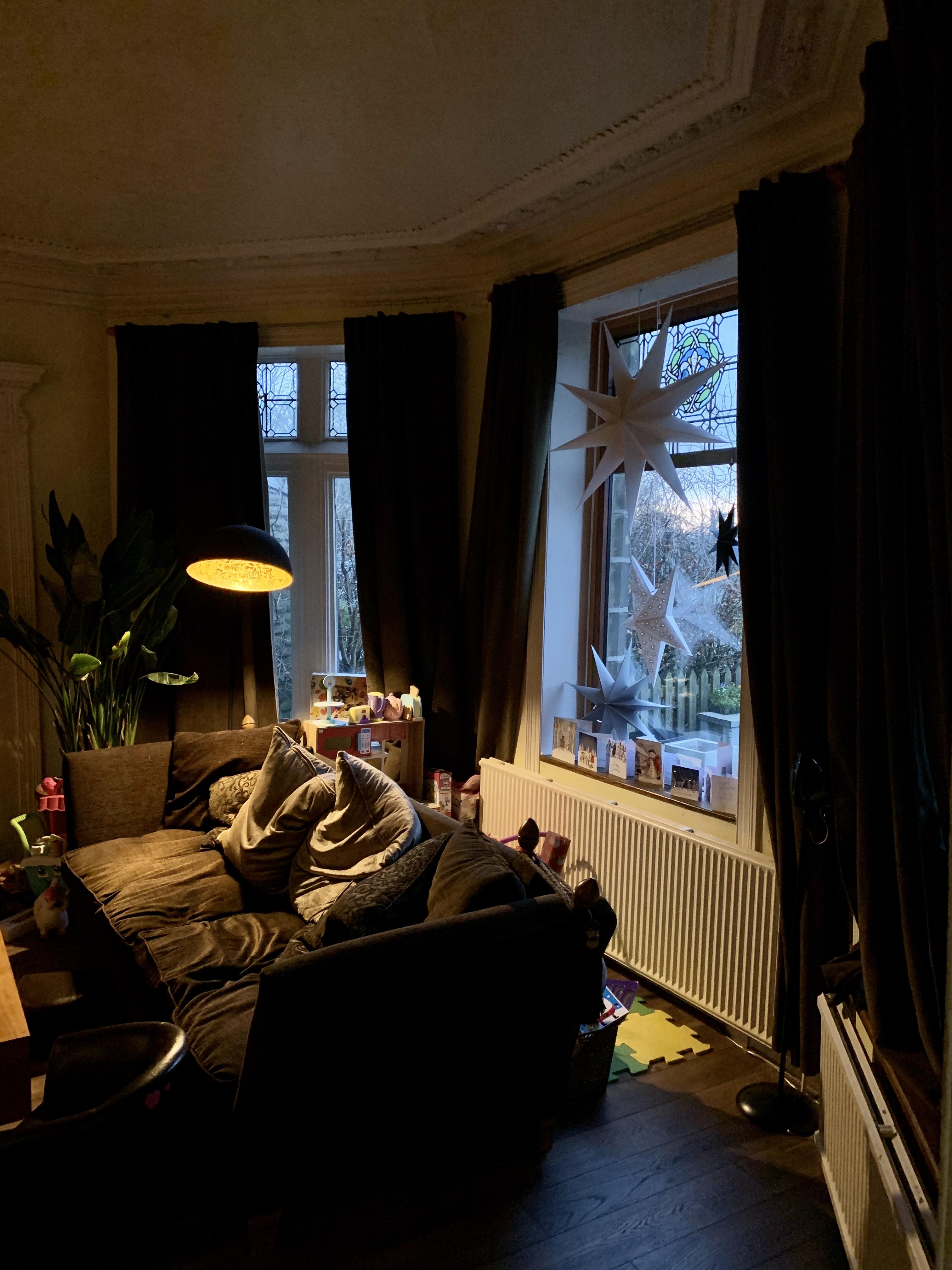

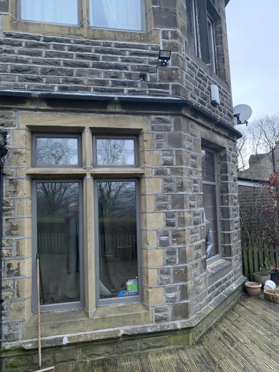

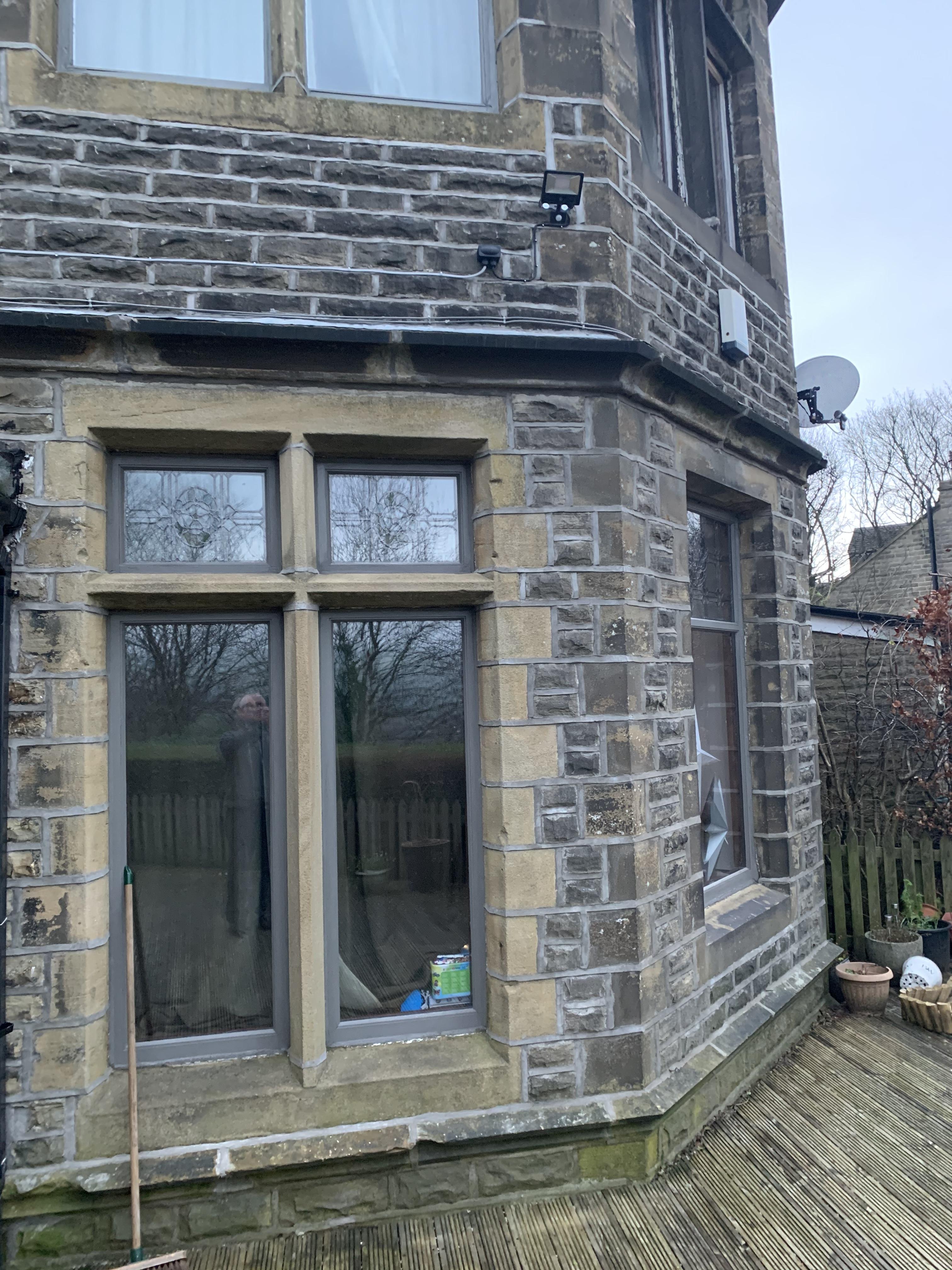

Tonymac01 Posted December 30, 2019 Share Posted December 30, 2019 So as we’re coming to the second sale and second survey of our house, the second surveyor found none of the issues the first one found, but a few of his own. First and most worrying is what he claims is dry rot, although he said it might not be, but the surveys come back now and he says he thinks it is. He never looked under the floorboards, never checked anywhere else for it. The bay window floor area has dropped a little, and it a bit ‘loose’ or ‘bouncy’ underfoot. Has laminate floor on top. we have decking outside above the vents. Can anyone help me on this one at all ? We have a section of wallpaper that has bubbled, to the right of the bay, where we had a leak upstairs a year or so ago (we never re decorated it). Which might have gone into the joists below ? There’s no cellar, just an 18”-24” void underneath the floor. The loose section of floor is where the sofa is in the pic, straight across the room. Questions are, can you (or a surveyor) diagnose dry rot from a loose floor ? Has the decking made any difference to ventilation in the void ? Could a prolonged leak from upstairs, through the floors, create it ? Thanks all. pics of inside and outside attached. Link to comment Share on other sites More sharing options...

ProDave Posted December 30, 2019 Share Posted December 30, 2019 Nobody can tell anything without lifting floorboards or otherwise gaining access to the under floor area. So I hope he has made it CLEAR he did not SEE dry rot, but has just made an assumption that may be one possible cause. A more likely cause (and easier to fix) is wet rot. Or nothing at all. I had exactly the same in a 1930's house. Some wood had warped (as wood does) meaning the wall plate on a sleeper wall had lifted a few mm off it's wall, and as you put weight on it, it went back down. nothing "wrong" not even wet rot. Link to comment Share on other sites More sharing options...
