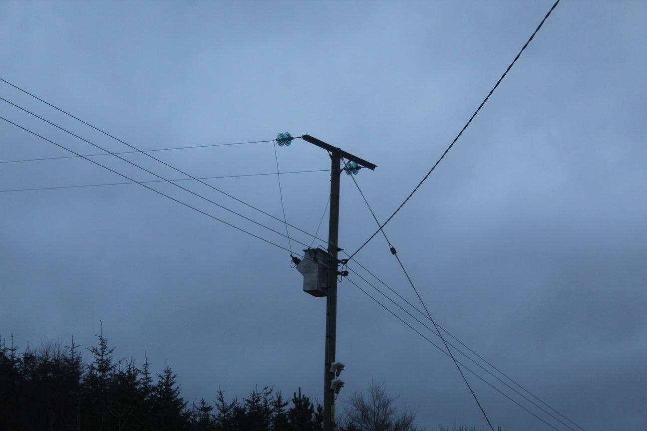

Mike_scotland Posted December 29, 2019 Author Posted December 29, 2019 This is the wire at the plot 2 cables. Will het better photo tomorrow,
ProDave Posted December 29, 2019 Posted December 29, 2019 1 minute ago, Mike_scotland said: This is the wire at the plot 2 cables. Will het better photo tomorrow, A better picture would be interesting. The 2 cables appear to be different sizes? A picture of where the wires join the poles in both directions might make it clearer.
Mike_scotland Posted December 29, 2019 Author Posted December 29, 2019 2 minutes ago, ProDave said: A better picture would be interesting. The 2 cables appear to be different sizes? A picture of where the wires join the poles in both directions might make it clearer. Its tough as on google maps there is 5 wires haha obviously from the past. But these photos are mine from a few weeks back during surveys etc.
Mike_scotland Posted December 29, 2019 Author Posted December 29, 2019 6 minutes ago, ProDave said: A better picture would be interesting. The 2 cables appear to be different sizes? A picture of where the wires join the poles in both directions might make it clearer. This is what I got from SSE.
ProDave Posted December 29, 2019 Posted December 29, 2019 The top one is a multicore LV (230V) distribution, and the lower one is BT Lets hope you are not stung for the cost of a new pole, it seems cheeky to possibly be charging you for that.

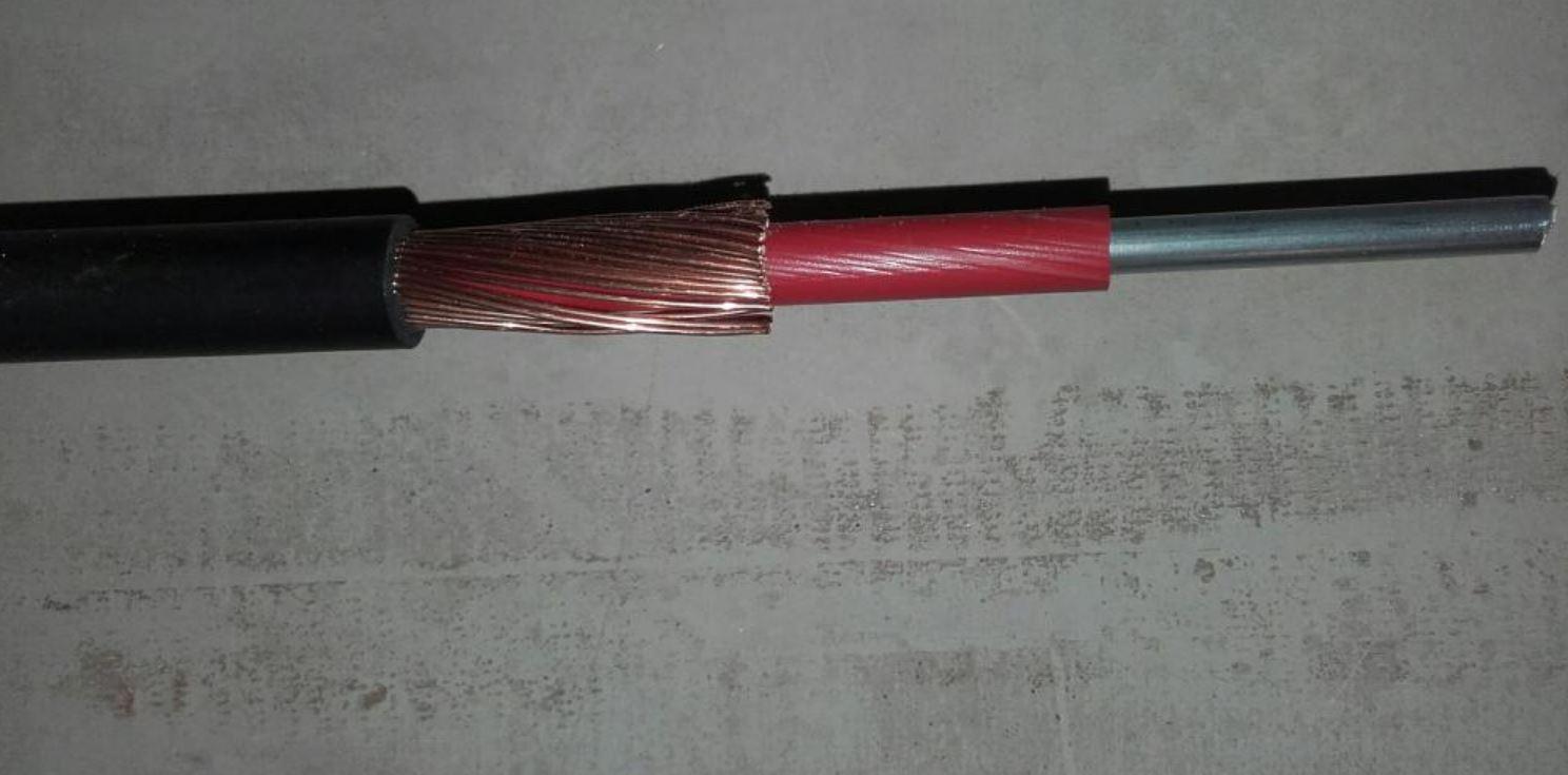

ProDave Posted December 29, 2019 Posted December 29, 2019 8 minutes ago, Stewpot said: I wonder if they can do single phase with 1 wire, using the ground as neutral as well as earth. The incoming cable to the site will almost certainly be PME with the inner core as L and the outer as a combined N and Protective earth (PEN) It will look like "1 wire" up on a pole.

JFDIY Posted December 29, 2019 Posted December 29, 2019 We've a right mix here, the overhead poles have 4 wires (3 phases + neuteal), then at the next pole it goes to a twisted 4-core cable serving the next farm after the 1/3 of a mile of cable was stolen. My 3ph supply comes from the 4 separate conductors as a single concentric cable, so you just can't really tell unless you get a decent hight Res photo or have access to one of the ends. Might be worth following the kind and asking the end users. It only cost me £500 extra for 3ph so I'd always enquire about both costs, I had it for machine tools, but gives more flexibility in the future as mentioned above EV charging and solar generation to name a few.
Jeremy Harris Posted December 30, 2019 Posted December 30, 2019 13 hours ago, JFDIY said: We've a right mix here, the overhead poles have 4 wires (3 phases + neuteal), then at the next pole it goes to a twisted 4-core cable serving the next farm after the 1/3 of a mile of cable was stolen. That;s most probably because the LV overhead network is being changed from the older separate conductor system to ABC, Aerial Bundled Cable, whenever a section needs replacement. ABC is more reliable and cheaper/quicker to install than the old separate conductor system. As an aside, ABC is rather cleverly designed, as the outer sheathing of each of the bundled conductors is moulded with a number ridges to denote the phase, so 1 ridge = L1, 2 ridges = L2 etc. The PEN has lots of ridges, around 12 IIRC. This means that the people working on it can easily identify which conductor is which just by feeling the outside of it. 1
