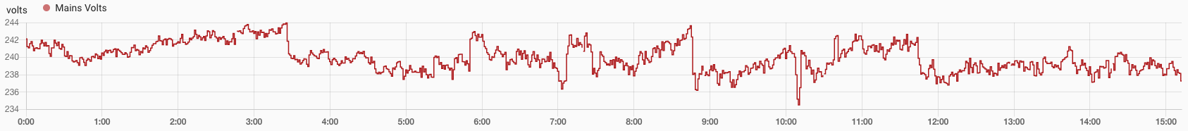

As a random aside - heres the mains voltage here today (60s sampling)
What happens at just after 7 AM, and just before 9 AM, and again just after 10 AM.
Kettle, showers, or something more sinister?
7 & 9 are certainly the kettle, just after 10am is probably the uranium enrichment kicking in...
