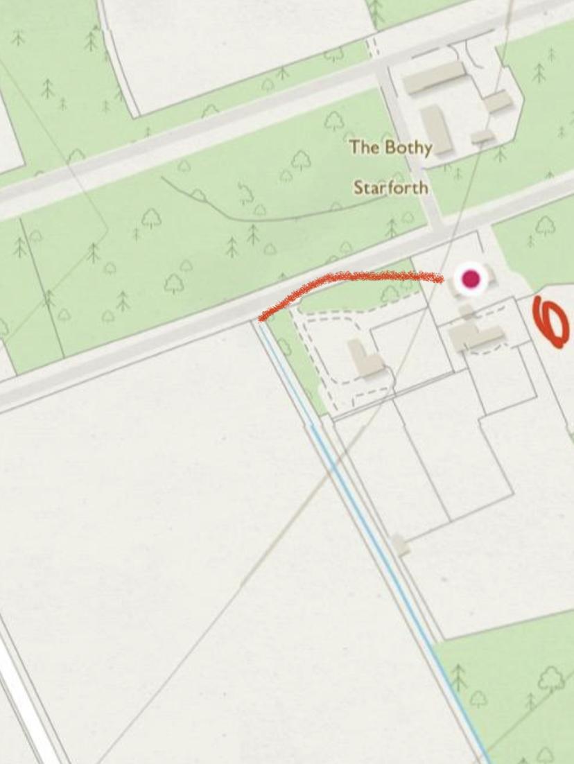

Caroline E Posted December 22, 2019 Author Posted December 22, 2019 Thanks @ProDave, just checked OS maps and it only has the same watercourses as google. Hopefully one of these will work if no others. How far is too far I wonder? I’ve attached a screenshot showing our location and the soakaway in red. Looks like it’s time to go for a wander this week:)

Caroline E Posted December 22, 2019 Author Posted December 22, 2019 2 minutes ago, ProDave said: I would be aiming for the stream running down the side of the wood, as high up as you can get, somewhere near Nursery house. It looks to be a downhill run. But using a pumped outlet treatment plant should mean you can do that all in 50mm mdpe. Thanks @ProDave the only catch with that one is it’s in a gorge about 50ft or more deep. There is a drainage ditch at T junction at the end of the rd that I presume drains to this, so we could aim for that. That’s not too far then in people’s opinion?
PeterW Posted December 22, 2019 Posted December 22, 2019 Sorry for the bad drawing but why can’t you go the other way ..?? Could easily get to the other end of the one to the left ..??
Caroline E Posted December 22, 2019 Author Posted December 22, 2019 5 minutes ago, PeterW said: Sorry for the bad drawing but why can’t you go the other way ..?? Could easily get to the other end of the one to the left ..?? Hi @PeterW, this was my first thought. The only slight issue is here is that means going up a slight incline, so not sure if this means a bigger pump/high running costs? But is is only about 120 metres away and looks to have a good flow rate. We’re also not sure who owns the verge (it’s a private rd) as apparently it was sold recently but no one knows who too! But if folk here think this isn’t an unreasonable distance and that pumping up a slight hill is feasible that’s great to hear:)
