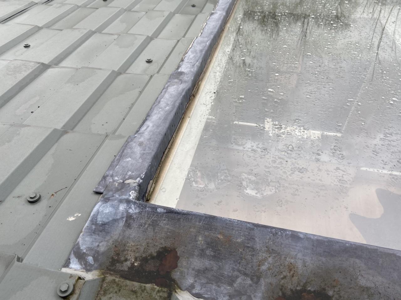

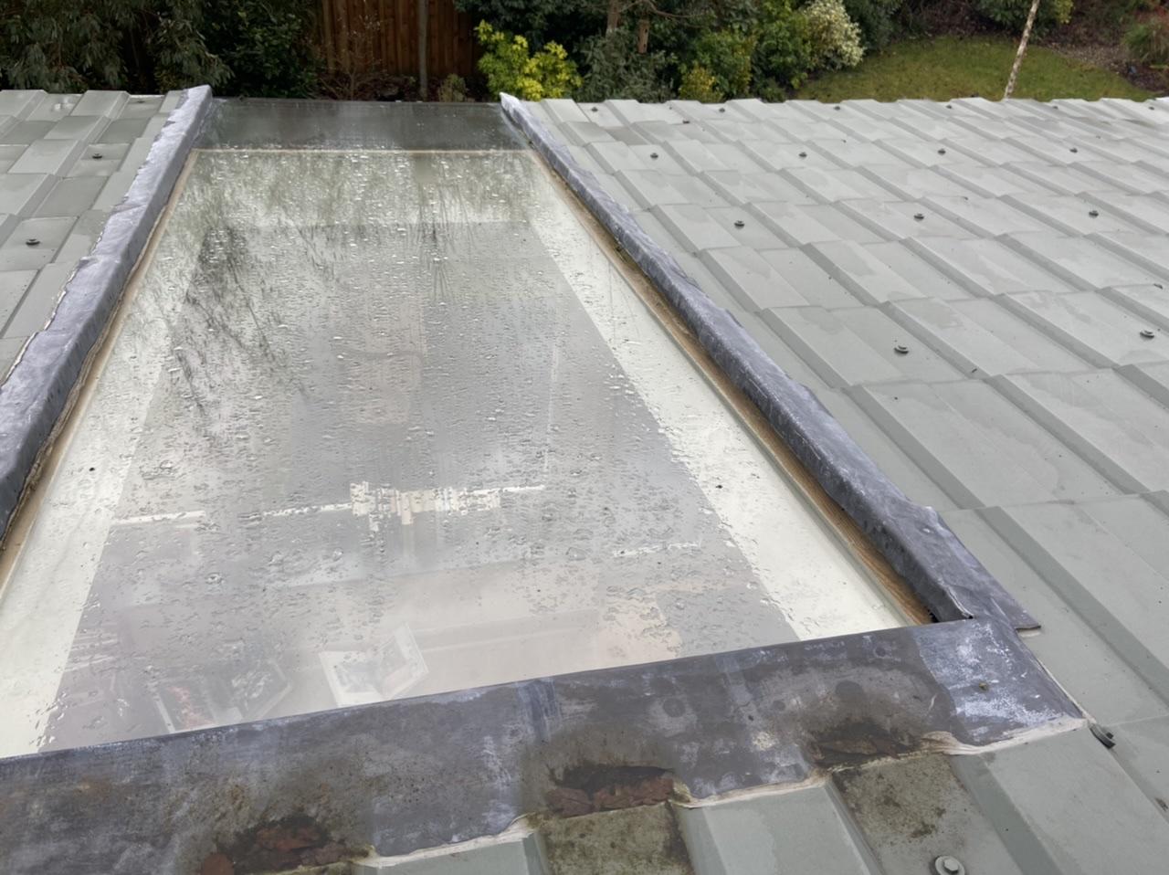

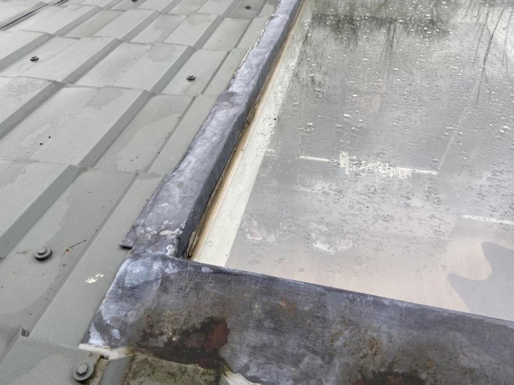

The previous owners built a conservatory with two roof windows. The sealing is a complete dog’s dinner. They’ve used flashing and with all the rain we’re worried about water ingress leading to leaks.
We are wondering how to best seal these windows once the lead has been removed. It’s likely to be a spring/summer job but would like to plan for it now.

I would not give that the satisfaction of being described as a "roof window"  It look like some DIY bodge job.
What's the roof material?  it looks like box profile sheets cut into strips?

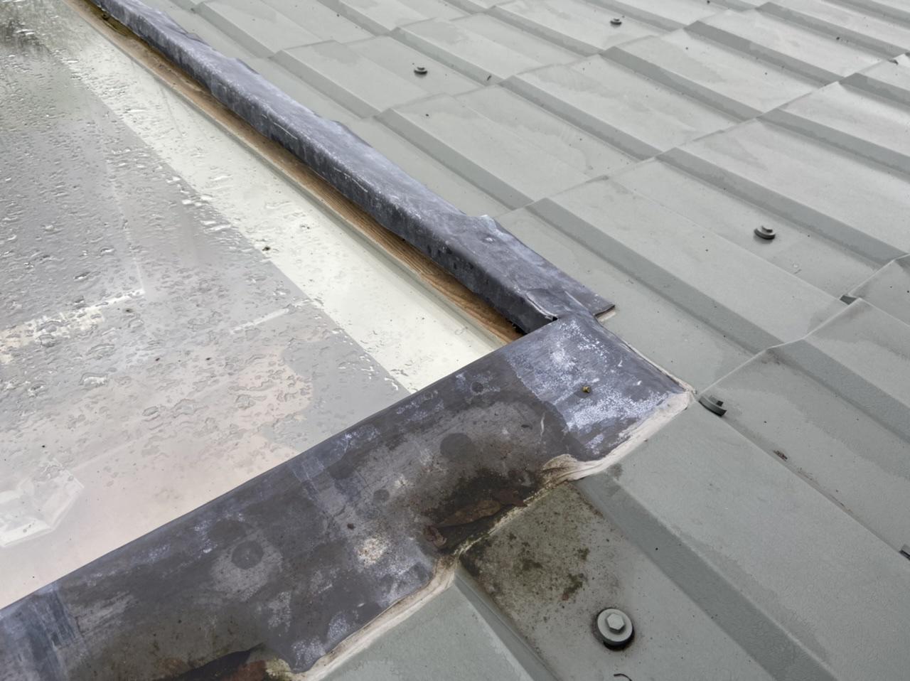

The lead flashing above the window needs to be longer and tuck under the roof cladding strip above it, not end just below it with half a tube of some sealant hoping to seal it.
And the same with the side flashings, they need to be longer so they tuck under the roof sheet above.

If you are not currrently getting leaks I would leave it until probably May (ie when the dry season starts), and have thought about possible solutions before then. If you are getting leaks I would jury-rig until the weather is less waterfall-like.
Corrugated is good at keeping water from tracking sideways, and I think your issues will be water up the roof coming in the top edge,  and water on the window running under the seal.
As to a permanent solution? Perhaps see if there is a kit from somewhere the right size which would fit, or make the window a bit bigger and make it proud of the roof service. I would try and avoid wholesale roof replacement, but otoh corrugate dis tricky to cut.

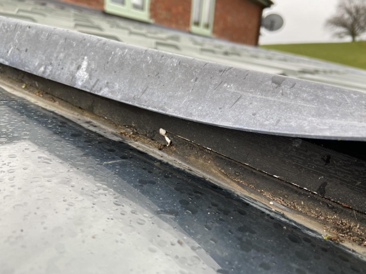

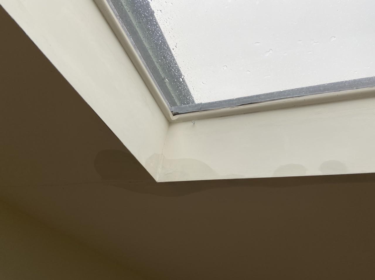

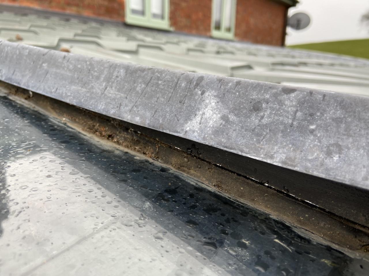

We tried to see this off until the summer. Not that lucky. We’ve sprung a leak - I think the black stuff is mastic but it seems to have degraded. Does it degrade over time?
Any solutions?
During a dry spell, should we rip this stuff out, clean it, and replace it? If yes, what would be recommended? Mastic, silicone?

Before you can address the problem, you need to know where the water is getting in.
Initially I thought it was the poor detail at the top where the top flashing is not correctly tucked under the sheet above.
Are you now thinking it is getting in at the edge of the glass and there has been a previous attempt to re seal it there?
It’s getting through the top. I just took the photo from the bottom to show the mastic.
Maybe it needs to be tucked in better.

If we were to remove the lead, what else could be used to keep the water out going forward?

On 20/12/2019 at 12:40, Home Farm said:
This is the problem imho.  That lead at the top should be much longer and tuck UNDER the roof sheet above the window.  At the moment at best it buts up to the joint between the roof sheets and has a tube of sealant trying to stop water getting under the lead.
So start with replacing that with a larger strip of leas that really tucks under the roof sheet above the window.
Because the rest of the window is also a bit dubious, I would try and form a bit of an upstand in the leadwork so instead of allowing water down onto the glass, it encouraged it to run off the sides above the window and down the roofing sheets
While you are at it, the lad down the sides should be wider so they at least lap down into the first valley of the roofing sheets. At the moment water on that flat section can blow under the lead.
There's also a potential problem with using lead above a window, as the glass will end up being stained by the lead salts that wash out over time.  As a general rule it's best to try and arrange things so that there isn't much possibility of water running off lead flashing on to glass.
no idea if it would stick to glass, but maybe contact the manufacturer - but if you masked nice straight finished edges, could you use something like Acrypol?
If you want a short-term fix with a view to doing a proper job later, I'd Flashband it to death. A bit of heat from a hot air paint stripping gun and it sticks to most things!
‘yes I would try to avoid using any lead as it’s gets very expensive very quickly, I like the idea of either doing it well or spending as little as possible and not worry what it looks like as long as it’s waterproof. If flashband or another product will stick to the roof and glass then possibly strip the lead off, clean it all up and do a good temporary fix with some flash band or equivalent.
