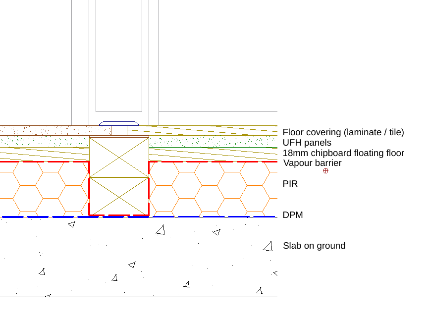

andyscotland Posted December 15, 2019 Posted December 15, 2019 I've realised there's a detail on my garage conversion that I'd not quite thought through. There are a couple of internal (non-loadbearing) stud walls to divide off rooms within the space. At the moment I have the soleplates for these sitting directly on the concrete slab (bridging the floor insulation). But I hadn't quite thought about how the VCL would detail round these (and hadn't drawn it on the building control plans). I've drawn what I think would be easiest on my section below - the VCL passing below the soleplate so it's continuous across the whole area. However this will allow vapour to get down to the cold slab/soleplate junction and I'm wondering if that's a condensation risk. Alternatives I can think of are: Make the PIR and VCL continuous across the whole slab, build the wall on top of the insulation. But not sure if that would be OK structurally in terms of loading on the PIR? Keep the soleplate directly on the slab, but take the VCL over the top, sealing it around all the vertical studs. So the bottom timbers are cold but dry (though moisture could still penetrate through / around the vertical stud junctions?) Take the VCL between the soleplate and the bottom member of the wall - so the VCL is continuous, and the coldest timber is dry - the bottom member should be less likely to hit dew point? Sit the wall on something insulating with more compressive strength (compacfoam or marmox thermoblock) to reduce the thermal bridge and keep the timber warm - but looks relatively pricey / and/or hard to source in small quantities. Or am I worrying too much? Only one of the walls runs to the outside wall of the property, the others are all in the centre of the slab or adjacent to the house - I know most slab heat loss is around the exposed perimeter so potentially where my walls are sitting won't get too cold? What do you all think? Cheers

Russell griffiths Posted December 15, 2019 Posted December 15, 2019 Why not get some eps300 and substitute the insulation under the sole plate with this, just a 300mm wide strip with the pir betting up to the sides of it.
A_L Posted December 15, 2019 Posted December 15, 2019 PIR has a 10% deformation compressive strength of 120kPa (or higher). This is too high to use but tells us that the 1% value is 40kPa or better. This corresponds to about 4000kg/m2 . If your sole plate is 50mm wide then they could load the floor to 200kg/m run.

andyscotland Posted December 16, 2019 Author Posted December 16, 2019 18 hours ago, Russell griffiths said: Why not get some eps300 and substitute the insulation under the sole plate with this, just a 300mm wide strip with the pir betting up to the sides of it. Should EPS300 be easy to source for a couple of sheets? I made a couple of calls this morning to my usual merchants but they didn't carry it. A quick google is only turning it up online in quite big quantities. 18 hours ago, A_L said: PIR has a 10% deformation compressive strength of 120kPa (or higher). This is too high to use but tells us that the 1% value is 40kPa or better. This corresponds to about 4000kg/m2 . If your sole plate is 50mm wide then they could load the floor to 200kg/m run. Thanks. Looked at the eco-versal datasheet as that's what I have : they say a continuous static load of 30kN/m2 (possibly due to compressive creep?). I am assuming that's a working limit, rather than a failure load that needs an additional safety margin applied. The narrowest studs I have are 38 x 63 CLS. If I have it right, that works out to a load limit of 1.89kN/metre of wall. Which would be 192kg/m. By my reckoning, the walls weigh about 100kg/m as below (plus a little bit for fixings, filler, paint, etc I guess): item qty width depth height volume density mass m m m m3 kg/m3 kg soleplate 1 1.000 0.063 0.038 0.0024 370 0.89 base member 1 1.000 0.063 0.038 0.0024 370 0.89 noggin 1 1.000 0.063 0.038 0.0024 370 0.89 top member 1 1.000 0.063 0.038 0.0024 370 0.89 head 1 1.000 0.063 0.038 0.0024 370 0.89 stud @ 600 ctr 1.67 0.038 0.063 2.500 0.0060 370 2.21 insulation 1 1.000 0.063 2.500 0.1575 10 1.58 fermacell 1 1.000 0.013 2.500 0.0313 1200 37.50 ply 1 1.000 0.018 2.500 0.0450 680 30.60 ply battens vert 2 0.020 0.020 2.500 0.0080 370 2.96 ply battens horz 4 1.000 0.020 0.020 0.0004 370 0.15 wall panel 1 1.000 0.010 2.500 0.0250 800 20.00 total mass per metre of wall (kg/m) 99.43 Does that seem plausible? If so then it would be well within the bearing capacity of the PIR, I think? One slight complication is that a couple of the walls have doorways, so the weight will be a bit different and the bearing area will be smaller, but if the above calc is correct there's a fair bit of headroom and the calc doesn't allow for any weight being taken where the end studs fix into the adjacent masonry walls. 17 hours ago, Oz07 said: I don't think the chipboard will expand too much. Like when you leave 10mm expansion on things that you also have to nail. I'd be suprised if most chipboard would expand any more than 3 or 4 mm round the whole perimeter of a room 3 or 4mm could be enough to make a difference at the bottoms of the walls though (especially in terms of the tile/skirting/whatever junction in the bathroom)? And maybe a risk of forces on the wall (e.g. from opening/closing doors) pushing the chipboard towards the perimeter expansion gaps - though I guess there'd be quite a lot of friction to overcome. Just feel a little nervous about having a "floating wall". I know NHBC standards rule out building a wall off a floating floor - I don't have to comply with them, but presumably that rule is due to defects they've encountered in the past...
PeterW Posted December 16, 2019 Posted December 16, 2019 Rip some 400mm strips from a sheet of 18mm OSB and set that below your standard flooring on top of a slightly reduced PIR if you can. It will spread the load and then glue and screw your chipboard to the edge of it. It will spread the load of the wall and it won’t move and your floating floor will also stay put ... 1 1
andyscotland Posted December 17, 2019 Author Posted December 17, 2019 (edited) On 16/12/2019 at 10:56, PeterW said: Rip some 400mm strips from a sheet of 18mm OSB and set that below your standard flooring on top of a slightly reduced PIR if you can. It will spread the load and then glue and screw your chipboard to the edge of it. It will spread the load of the wall and it won’t move and your floating floor will also stay put ... @PeterW thanks - sounds like a good solution. I guess I'd need to reduce the PIR by 20mm down to the next standard thickness, so would then need to pack a few mm between the OSB and the chipboard to keep the levels? That should be doable. I asked Ecotherm technical and they've come back and quoted 28kN/m2 for a permanent loading figure at 1-2% yield, so does sound like increasing the bearing area as you've suggested is a good plan. Edited December 17, 2019 by andyscotland

andyscotland Posted November 15 Author Posted November 15 I went with @PeterW's plan of laying a thinner section of PIR with 400mm rip of 18mm OSB on top to spread the load. I fixed the OSB down into the slab with hammer in fixings, with mastic around where they pass through the DPM. Then laid the VCL continuous across the whole floor (above the PIR, but the PIR is on the warm side of the insulation) and then screwed the sole plates down into the OSB. Can't comment on BC as I am not yet complete 🤣 and they've not been out to do any inspections as it's a "small" project. However I can say that the stud walls have now been there for 5 years 🤦♂️ and no sign of movement or issues.
saveasteading Posted November 15 Posted November 15 On 15/12/2019 at 13:00, andyscotland said: build the wall on top of the insulation I'm late to this. I wouldn't do it but would fix the sole plate to the concrete. I agree that the loading capacity looks OK but it's an experiment. Buildings move. I've seen pir shrink, whatever the spec says. Levelling the sole plate on concrete is going to be (can be) a precise job whereas pir can't be adusted, other than with screed. But your detail requires a precise slab anyway... beyond normal construction standards. The heat loss through the normal sole plate detail is tiny, especially as distance increases from the outdoor perimeter (earth is a half decent insulator). Sometimes normal is best.
andyscotland Posted November 15 Author Posted November 15 Thanks @saveasteading. I wasn't so much concerned about heat loss as condensation risk at the bottom of the timber. But fair to say I've learned quite a lot in the subsequent 6 years! My experiment is going well so far, will just have to keep fingers crossed that it continues to do so... 1
