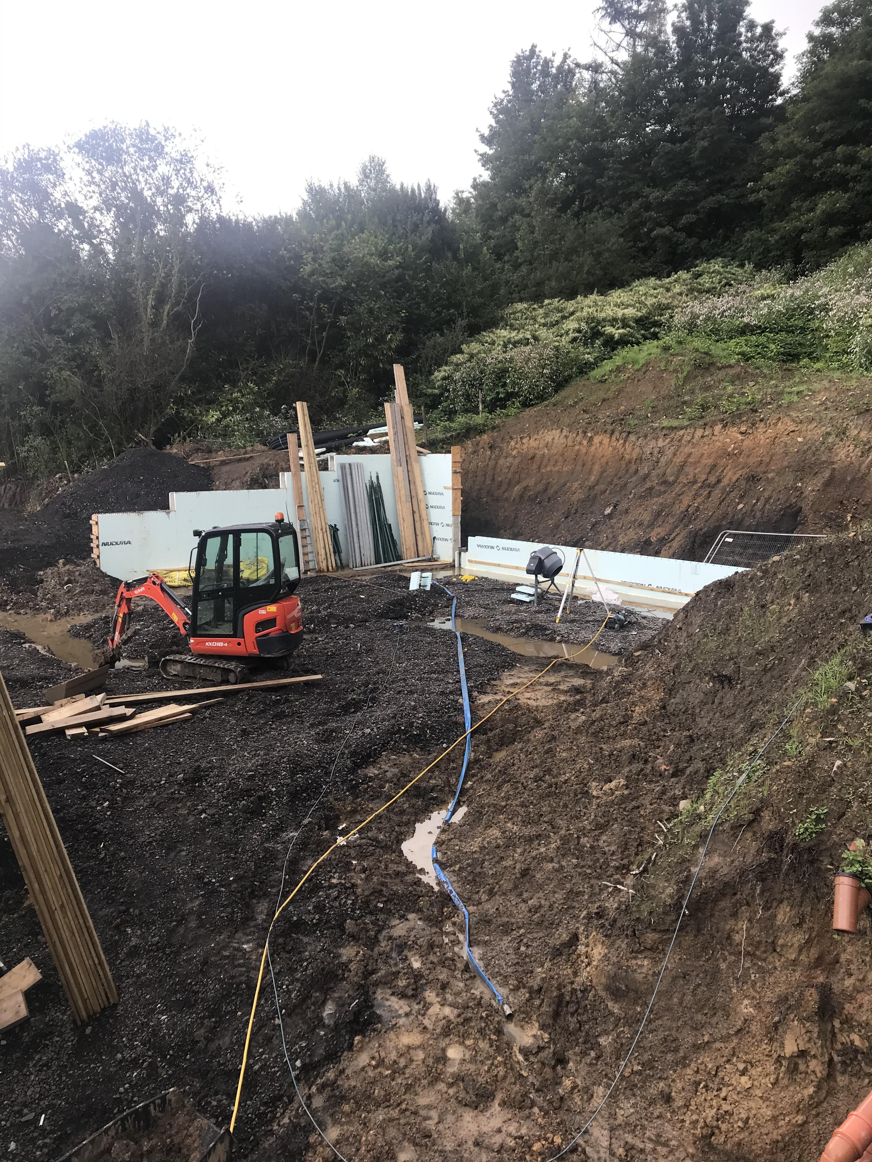

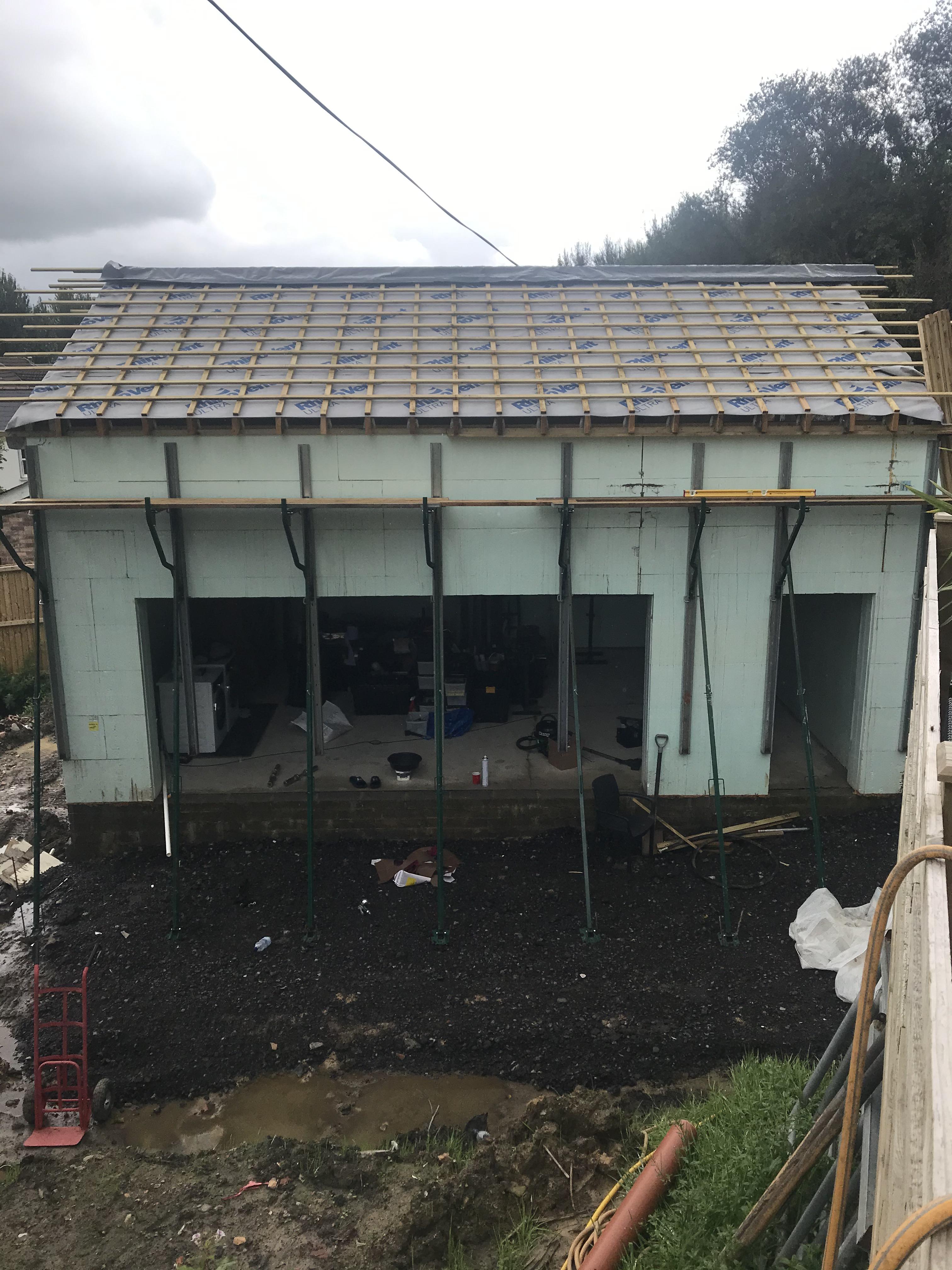

I've decided to use Nudura.
The blocks are 2.4m long and 450mm high. There is no cost difference between a 150mm fill block and a 300mm fill block. The insulation thickness is around 65mm and I've been told that anything over this has minimal benefits.
I'm not sure what the U value is, but I'll check with the distributor. He seemed more interested in the thermal mass and air tightness, when I discussed it with him last. I've recently finished building my garage with it and also finished a 200mm fill retaining wall.
I am going to start building the house in a few weeks when the blocks arrive. The back and one side of the house will be a retaining wall, so I will use a 200mm fill block. I will then transition off the corners to a 150mm block and use 150mm blocks for the rest of the house.
