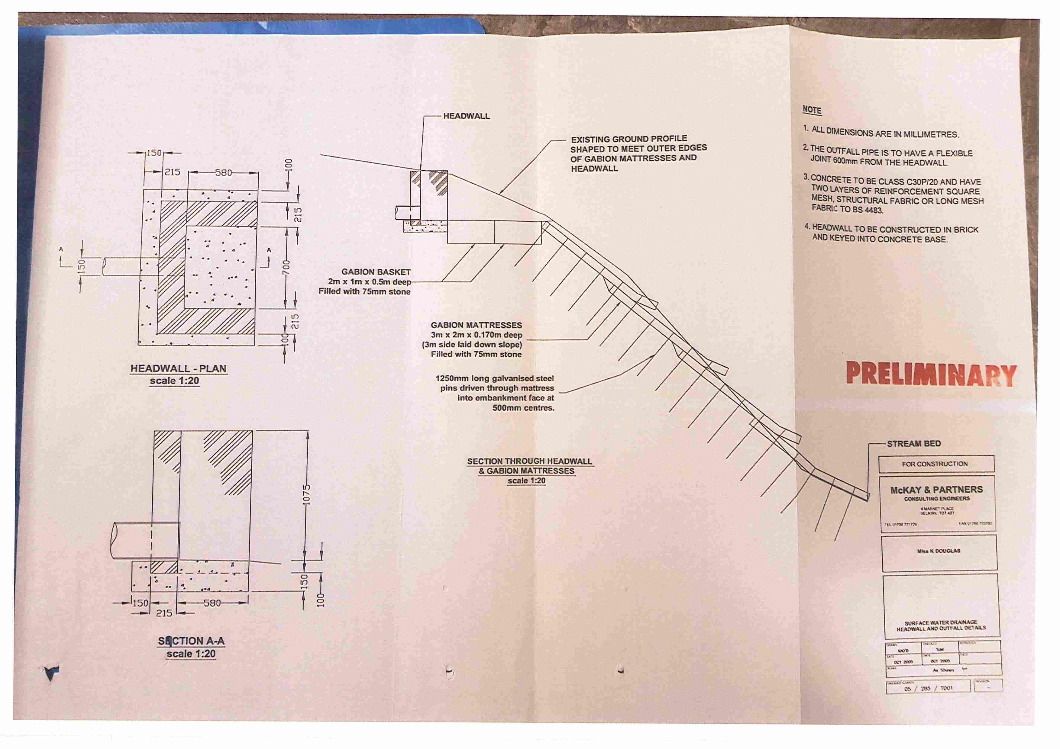

Stewpot Posted December 10, 2019 Author Posted December 10, 2019 Stop Press! A minor miracle has happened. I've just received an email from the estate agent; the vendor has found a copy of the engineer's report. I need to spend more time with it, but on the face of it, it answers most of my concerns: The gabioned outfall for both surface water and treatment plant is simply a gabion mattress down the bank to the burn. And that's only a suggestion, instead of a piped outlet. So the gabions aren't required to shore up the bank, which was my fear. Load bearing capacity 85kN/m2. Foundations "would most likely take the form of conventional strip foundations." I must say, I had been anticipating piled foundations of some sort. In fact, I may actually prefer them, given the nature of the site, but I'll deal with that in due course. This is my bedtime reading sorted out for a while. Thanks for everyone's input. 1
ProDave Posted December 10, 2019 Posted December 10, 2019 If there are any pictures or diagrams in that report it would be interesting to see them, I can't imagine what a gabion mattress is at the moment.
Ferdinand Posted December 10, 2019 Posted December 10, 2019 10 minutes ago, ProDave said: If there are any pictures or diagrams in that report it would be interesting to see them, I can't imagine what a gabion mattress is at the moment. Thick terram made out of gabions ?
Stewpot Posted December 10, 2019 Author Posted December 10, 2019 (edited) 30 minutes ago, ProDave said: If there are any pictures or diagrams in that report it would be interesting to see them, I can't imagine what a gabion mattress is at the moment. It's basically a flat version of a gabion that lies on the ground. But I am puzzled by it's use here. What purpose is it serving? Any water flowing over the top of the mattress will surely run to the underside of the mattress and make its way down the slope along the ground underneath. Over time, a natural watercourse will simply form under the mattress, and it becomes irrelevant. If there was an impermeable layer specified to lie under the mattress, that would make more sense, but there isn't. The report says: "The direct discharge to the burn will be difficult to construct due to the steepness of the valley slopes. It may be easier to allow the discharge to run through/over a series of gabion mattresses which have been laid down the face of the slope rather than try to install a piped outlet to the watercourse." Edited December 10, 2019 by Stewpot
ProDave Posted December 10, 2019 Posted December 10, 2019 It looks like the bank is quite long and steep. You would have to run the pipe a long way down and build the head wall much lower to have a direct discharge pipe. Then it runs the risk of being flooded with the burn in spate? As long as you lay teram or similar membrane before laying the mattress I can't see an issue with erosion. It does not look too difficult to build. As long as SEPA are happy I would just do that.
Ferdinand Posted December 10, 2019 Posted December 10, 2019 (edited) The Gabion Mattresses are creating a stable drainage layer afaics, and/or preventing the existing surface from moving. Edited December 10, 2019 by Ferdinand
